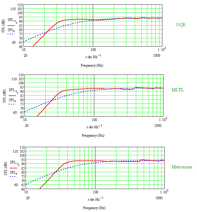

I have a pair of Tang Band W6-789S 6.5 in. mid-woofs looking for gainful employment. I was thinking of using them in some largish bass reflex wooden bowl speakers, but got intrigued by the article on the Omega Quarterwave Reflex in the Oct 03 issue of AudioXpress. I was thinking of using these drivers either in the Omega or a Metronome with single order crossover to a tweeter at, say, 10k or so. Comments on the pros and cons between the two speaker types? Not really full range, but almost there...

I ran through the numbers in a preliminary fahsion for an Omega using the Tang Band 6.5" woofers, and the inital results give me cabinets nearly 6ft tall and 130 in^2. This sounds plausible, but I may need to check to see if the equation a grabbed from the article is correcly parsed, as it has some ambiguity that could have been solved by a sprinkling of parentheses.
Well, WRT an OQR: fiberglass damping = 62.22in long, pipe CSA 173.676in^2, vent CSA 17.368in^2, stuff 0.367lbs ft^3. Polyfill damping = 67.1in, pipe CSA 135.081in^2, vent CSA 13.508in^2, stuff 0.735lbs ft^3.
An MLTL (well, one way of doing it at any rate) would be 52in, CSA 102.26in^2, Zd 19in, Zp = 50.5in, vent = 3in diameter x 1.25in long. Line top, back & one diade to just below the driver with 1in acoustic fiberglass, wool carpet underlay or similar.
Metronome = 60in, Zd = 30in. St = 8in^2. Sl = 125in^2. Vent = 3in diameter x 1.25in long. Same damping as MLTL. See different attached plots. Adjust the vent & damping on all to tailor the response to suit.
OQR is just one set of alignment tables. Does the job; not ideal IMO.

My numbers for the OQR with polyester stuffing came out pretty similar to the ones cited above, so I must have interpreted the equation in the article the right way - quite a cabinet for a leetle 6.5" driver.The OQR seems to have a teensy bit more low end extension than the other two alternatives, but not enough to get me really hot and bothered. The big thing the OQR ha going for it is straight lines, suited to my rudimentary woodworking skills. I'll have another look at the Metronome, though, to see if I can figure out how to do one.

For the rest, I could have tuned the others for a lower Fp or done one to squeeze out a few Hz extra extension had I felt so inclined. I didn't. They're all tuned about as low as I'd take it in a vented box, and you're unlikely to notice any difference in LF extension between the three in practice. Theoretically, the MLTL (remember the OQR also falls under this catagory; it's just a specific simplified variation) should be the more accurate generally; it doesn't need anything like as much damping as the OQR either, so it should sound rather more lively. It's a bit smaller too. YMMV as always of course.
