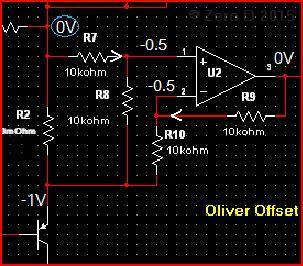

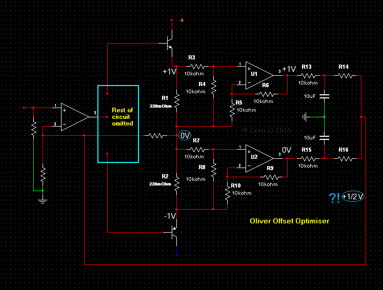

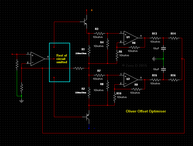

Not quite correct - the voltage across a single Re will fall to ~0V as the output stage enters Class B. What needs to be detected is the minimum voltage across both Re which will give a voltage that is twice the quiescent voltage for a single Re.The voltage across an Re in AB is half-sines (assuming sine signal) on top of a DC level from Ibias. Detect the minimum of that waveform and you can use that to control Ibias via feedback.

The output offset will change as the bias is increased. The speaker will read this change in offset as part of the audio signal.
If the return to low bias is slow, then the speaker cannot respond to the slow return to near zero output offset.
I have never seen any comment that offset is corrected, by any of these active bias control circuits, as the bias is changed.
I see that Vab is decidedly asymmetrical.Not quite correct - the voltage across a single Re will fall to ~0V as the output stage enters Class B. What needs to be detected is the minimum voltage across both Re which will give a voltage that is twice the quiescent voltage for a single Re.

Andrew why would the offset change with bias?? That's new to me.
New to my amps, too ;-)

The slight imbalance in the P & N devices require the output offset to be corrected when the output bias current is changed.
I have measured this many times on many quite different implementations.

I don't agree Andrew. I have NEVER seen it. Unless you have an amp that has DC gain, no servo and a trimpot for offset, there you may see it, but I hope we would have left such crummy designs behind us a few decades now ;-)
I actually have a pair of vintage Sony TA-N68 power amps that can be switched from A to AB (switching bias and power rail). There's absolutely no change in offset, but of course this has a servo.
