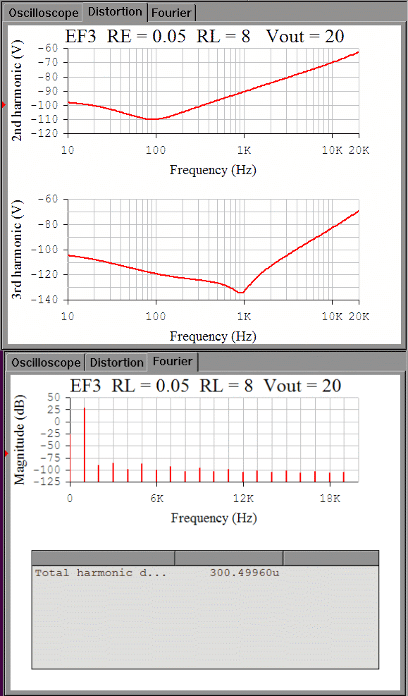

Actually what confused me was the fact your graphs are for a single distortion harmonic each. Usually a graph of this shape plots total THD vs output level, and since THD is a ratio, it will rise as output decreases.
Otherwise, low-f THD should be unmeasurable (or close to it) even for an amp with moderate open-loop gain.
Sreten - Leech defines the transconductance of the output stage as a whole, which depends on the load impedance. Within this definition there is no gm-doubling and it is a valid way to view things. With a resistive load, the transconductance is then constant and only changes if you change the load resistance.
The incremental gm and instantaneous gm of each output device at a given load current can be viewed as"internal-gm" or "raw-gm", with the whole output stage and load showing the "net-gm". Again, just many ways to assess the same situation, and different aspects to explore when trying to figure out causes for distortion and their fixes.
