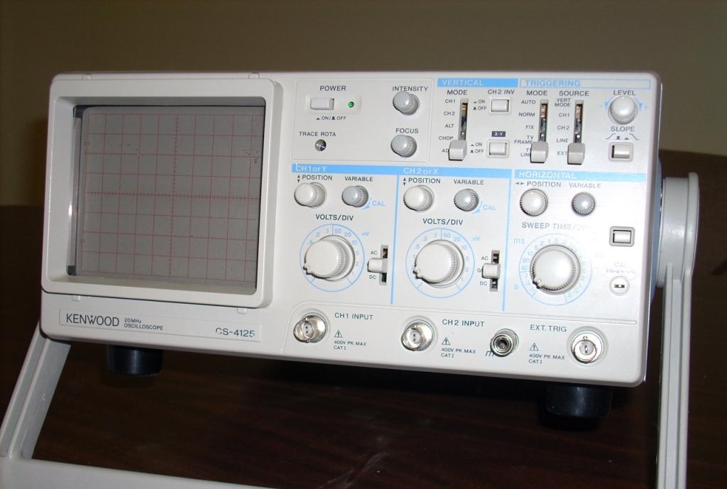

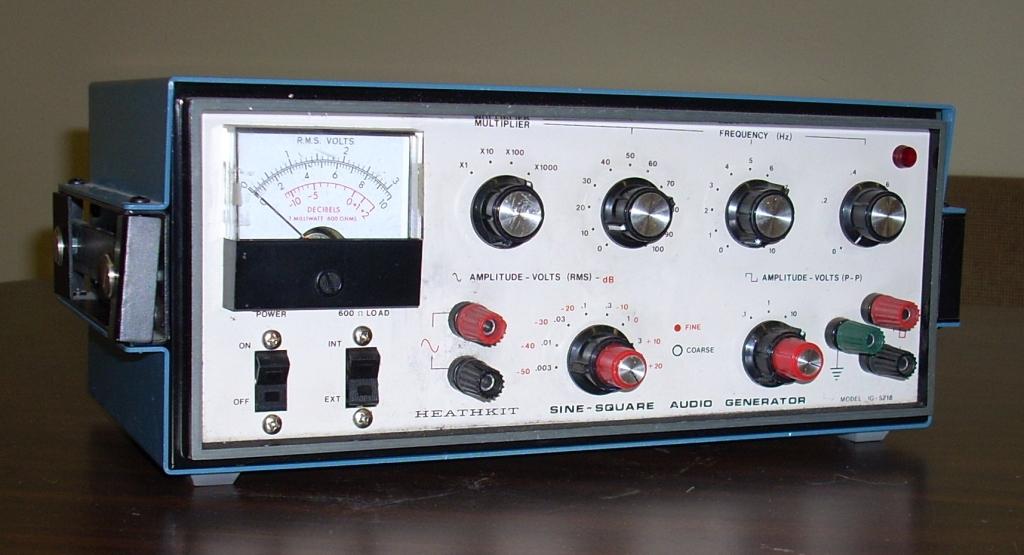

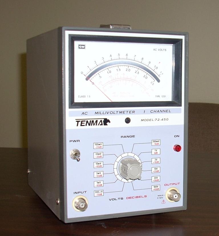

Signal Generator
We have Heathkits IG18 in stock, used but in good working order $50 each.
Other meters and scopes as well
