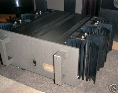

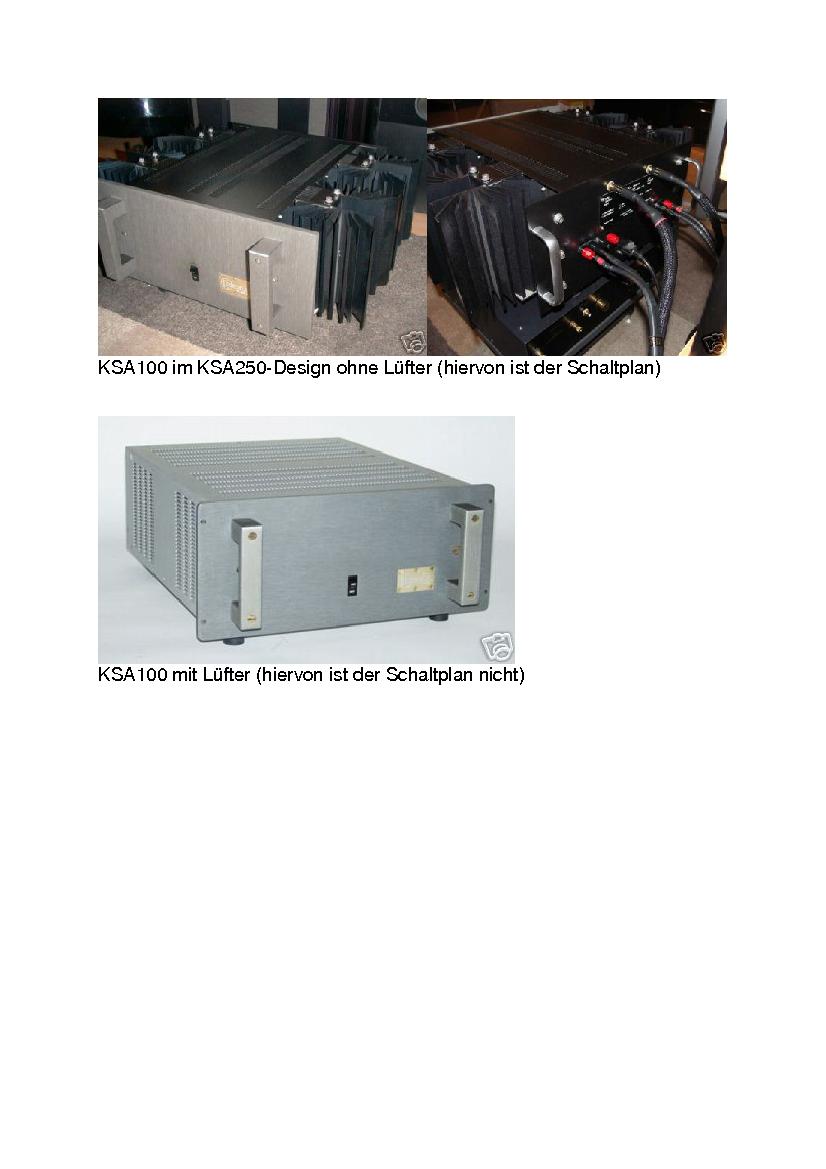

Here a (not original Krell) schematic of the KSA-100 EUR 1989. I did create self with help of the disass'y PCB boards to get the possibility of troubleshooting. The cabinet (enclosure) design outside is more like the KSA-250 design without used fan
Looks like a KSA 80 to me 😉 A friend of mine has one, if it's a stereo power amp it'll definately be either the KSA 80 or KSA 80B (which had balanced inputs as well as single ended phonos). If it's a monoblock it'll likely be the KMA 160.The cabinet (enclosure) design outside is more like the KSA-250 design without used fan
