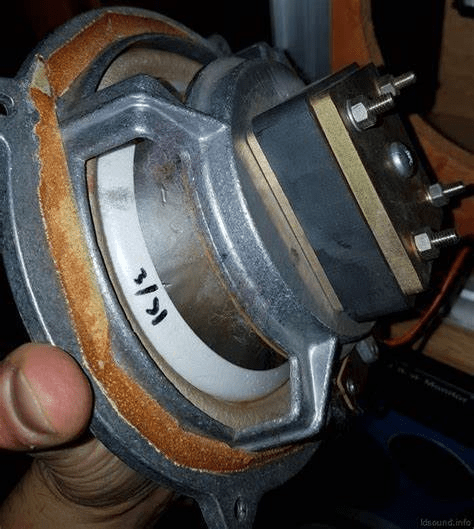

Hi all, does anyone recognise these old Wharfedale woofer drivers. They are said to be 8 inch. I don't know what model they are from. Keen to know specs and any other info. Glenn

probably a Leak

In any case, the link I posted sports what looks like the exact same driver shown in Glenn's picture.
Browse the pictures in the link to find out.
Further down it gives a lot of info among this:
Configuration: 2x 2.5" Drivers 1x 6" Woofer SEALED
So, I think Glenn's woofer is 6".
The square magnet assembly of Glenn's driver looks oversized in relation to an 8" diameter, so 6" would be closer to the mark.

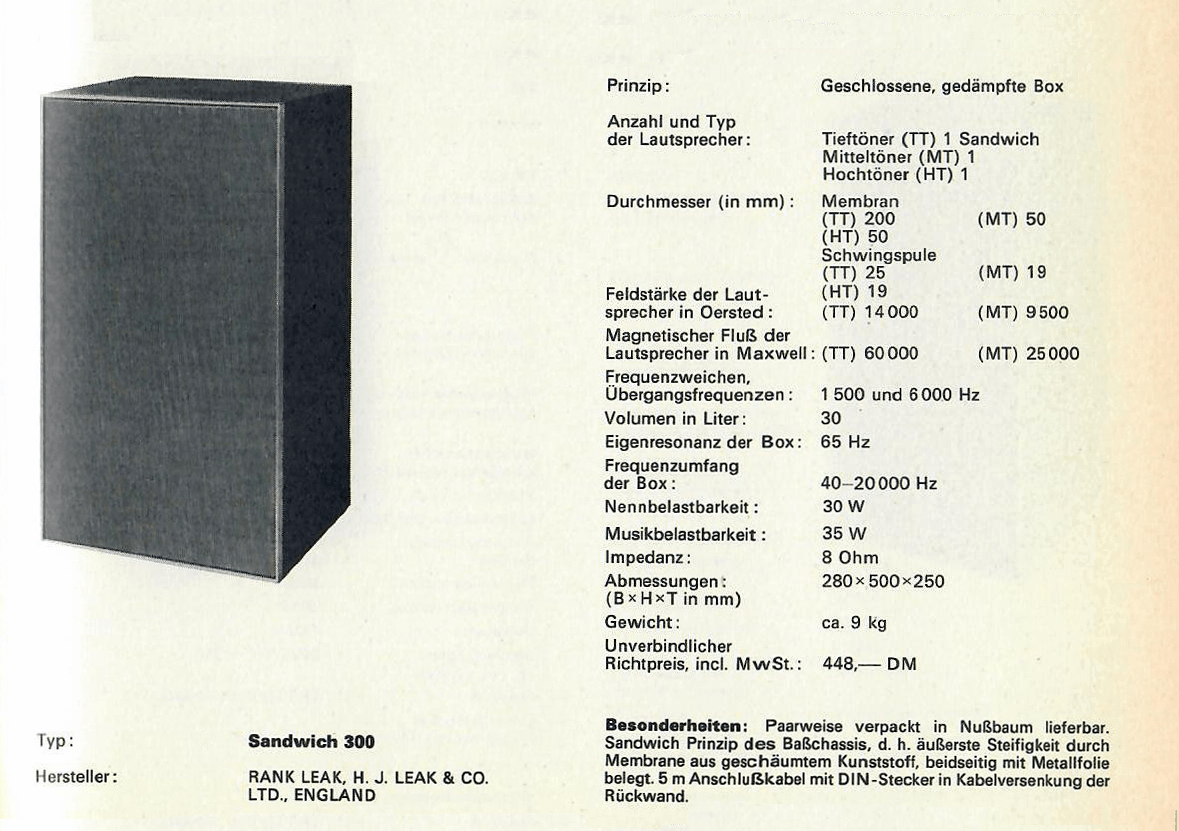

EDIT: The specs of this Sandwich 300 say it has a 200 mm (7.97") cone so there appears to be two models of these.

I think that further down information is simply a collection of 'facts' that the seller has collected off the internet.
The 6" reference would appear to be a mistake as it is at odds with the published specifications for the Sandwich 300 that I gave above.

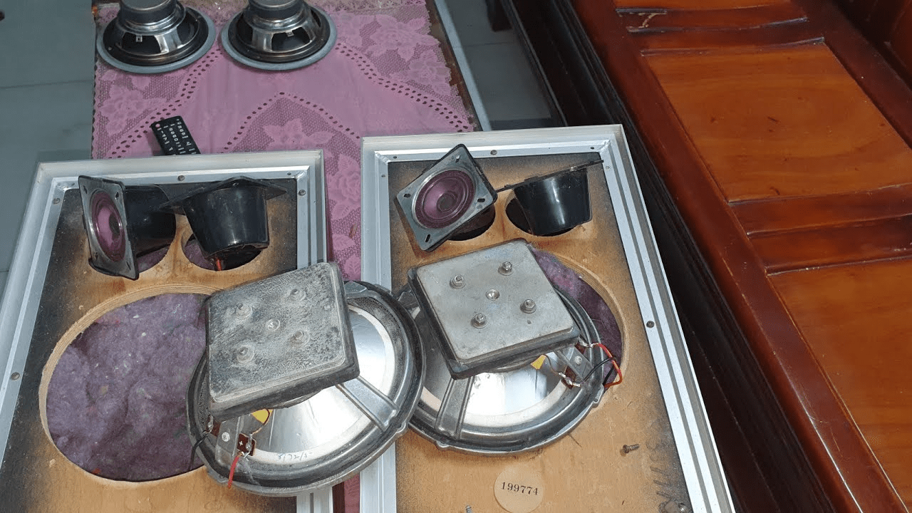

And, I've found an image showing the Sandwich 300 drivers:
I believe that may completely solve the mystery!
