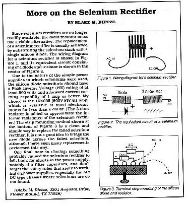

Hi, I'm in the process of fixing a HP 410B that I got for nothing and one of the things everyone was saying is 'get rid of the selenium rectifier' I found a good article from Antique Radio that suggests replacing the selenium rec w/ just as you mentioned a 1N4007 and add a 2 ohm resistor in series with it to compensate for the added efficiency of the silicon diode. A small terminal strip will make thing easier. Another recomendation was to get rid of the Black Beauty caps as well. Sorry for the bad scan but maybe it will help.

Hey Stan,
You're a lucky fella. HP stuff is great!
The scan is rough, but it illustrates things well.
Sometimes you need to play with the resistor value to get the expected voltage right. That is the correct idea, and yes, I try to use terminal strips as the dropping resistor can get warm.
-Chris
