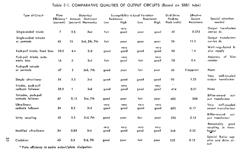

Yes, triodes presently rule.
An interesting chart, but is it useful?
It quotes efficiency (which is arguably useful) but doesn't quote the power level at which the distortion measurements were made. Suppose that the distortion for one measurement was 0.1% and for another 0.25%; you'd assume that the 0.1% configuration was superior. But what if the 0.25% configuration produced 30W, and the 0.1% configuration produced only 10W? Then, (if we make the sweeping assumption that distortion is proportional to level), the 0.25% configuration would produce a little less distortion at 10W than the 0.1% configuration...
We really need graphs (and lots of them)...
The relevant columns were the load variation tolerance. Pentode users are people, too.
I would not complain a bit if some contemporary author took your suggestion and did a more comprehensive survey, but to be fair, this is just a summary chart following quite a bit of explanatory text.
