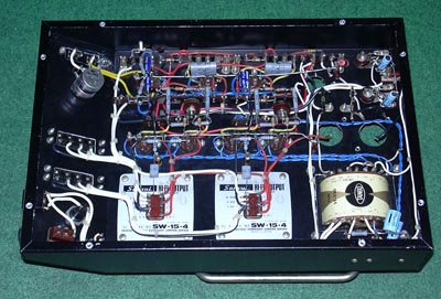

Ok, so what you need to do is this. Look at the bottom of the amplifier and write down the values of the resistors.
We are most interested in the 3 tube sockets at the front of the amp, then the 4 that are behind...
There are 9 pins on each tube socket. they are numbered in the clockwise direction from below, starting at 1 after the gap. There will be a gap... It goes 1, 2, 3, 4, etc... to 9. Read the resistor values for each green resistor and post them here please.
The resitors are the little green guys. Most resistors have little strips of color on them to indicate their value. The ones in this amp are (metal film I believe) and have actual numbers printed on them.
Please get those numbers and post them here with the pin they are attached to for each tube socket.

Same transformers unfortunately does not help much. If you happen to have the schematic then ok, post it. BUT: Please read off the resistor values and associated pins they are attached to. This will help a LOT. Then we can easily make progress by ruling out tubes....
The first socket, right to left. pin #1 has a 30. #2-#7 have a .957 resistor. #6 has a 30. #8 has a 30.
2nd socket has none.
3rd socket #1 has 30. #2-#7 have 1.0. #6 has a 30

I guess it is an amateur made a 6R-A8 pp stereo amp.
The circuit may be copied of the LUX, Transformer Kit-KMQ8, which has 7 tubes.

Tubologic, I think, already correctly identified the amp, did you try to match up the part values?

The one I found in an old book (model A2500) uses 6AQ8 and 12AU7 as input and phase splitter tubes but yours might be different.

The A2500 schematic is looking likely...
Early to mid 1960s vintage based on the resistors and coupling caps used, and I'd wager it's not a kit.
Appears to use fixed bias output stage which is adjusted by the two pots to left located above 3 electrolytics.
Being Lux iron the quality is going to be pretty good, but this thing needs a full restoration job - most of the parts are going to need to be replaced I think based on my experience with Japanese amps of that era.
I'd pass it along to someone who can restore it or alternately have said person fix it for you.

Ok, its not tidy built but looks like a kit is what I meant. full wave voltage doubler? ugh.Probably best to strip it for parts.
