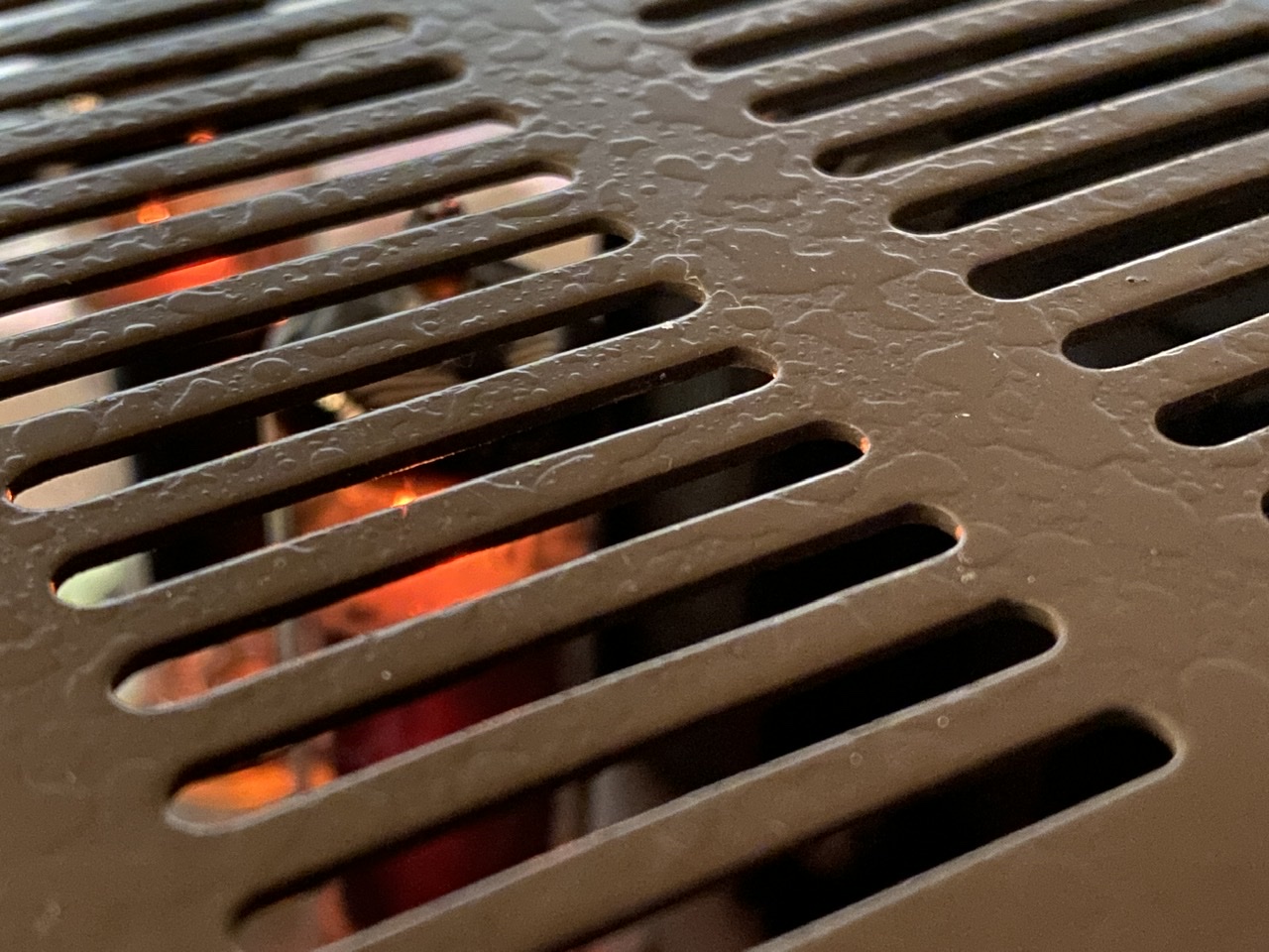

Today I had it on for several hours since I'm at home office. After a while, I thought the power transformer was buzzing louder than it used to. Turned off the amp. Later, I turned it on, played some music and checked the tubes. One of the output EL84 was redplating.
So, time to get rid of those coupling caps I guess. I hope I didn't ruin the tube, or anything else. Although I assume the tube had redplated before as well. Temp of the tubes inside the cabinet were about 160C, but internet said that was fine. Must be some toll on the transformers! I have only played at low volume, though.
Is it safe to not change the output tubes, even though one redplated? Or would I risk some kind of runaway, despite changing coupling caps?

A tube that has been overheated should not be used again. Get a new tube(s). Replace coupling caps ? Maybe, but i would start with fresh tubes.

Replace all of the Japanese PIO caps. (which are quite notorious for becoming leaky) and install 2 new matched pairs of JJ EL84 O/P tubes, which petertub can provide.

This is why I suggested, back in post #3, that all the gray caps need to be replaced. The output tubes should be replaced at this point but it's very possible that they had red-plated previously, so likely needed to be replaced anyway.Heh, I guess some lessons must be learned the hard way. . . . Later, I turned it on, played some music and checked the tubes. One of the output EL84 was redplating.

I know it's tempting to just run an old amp amp and listen until the parts order comes in, especially if the previous owner had been using it. I've done it many times. But I would never do this with a Japanese amp that uses those gray caps. They really do need to be replaced first.

Another thing I noticed, when looking at the pic of the guts, is that the primary of the PT is labeled 110v. Assuming you're in the US, your wall voltage will be considerably higher and this results in higher voltages throughout the amp. Measure your wall voltage and see. Keep in mind that it tends to vary depending on the time of day as overall demand fluctuates.
While the buzzing may have been the result of excessive current being drawn by the red-plating tubes, the higher wall voltage alone will make the PT run harder and hotter than it was designed to do. This will be the case even after you replace the (electrically) leaky caps and install a new set of tubes.
You should plan on taking steps to reduce the voltage either by adding a bucking transformer or running the amp on a variac. I don't usually bother doing this with vintage American amps, since their PT primaries are generally rated at 117v, so the over-voltage isn't quite as extreme. But something should be done if the PT is rated for 110v.
As a quick check, after you replace all the caps, measure the heater voltages on the tubes. If they're more than 5% above the nominal 6.3v tube life will be affected.
