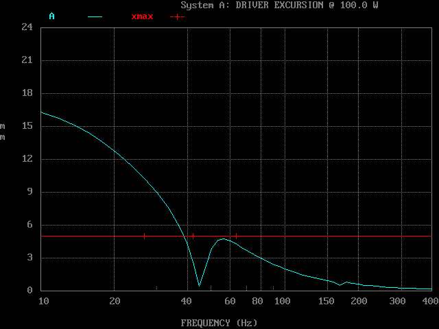

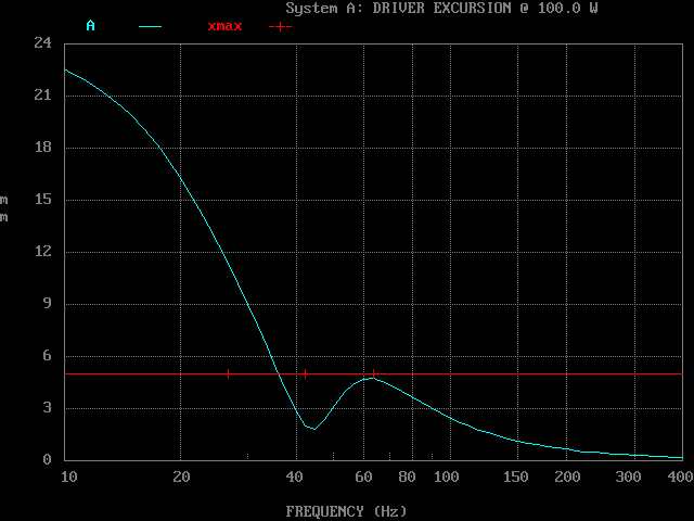

is this program any use at all thesedays?
i was looking that the 'magic' deathboxes over at car audio forums,and magic'snailshells' that hit 140db with 6.5" speakers,and i saw this loading on the cone in this program with a little compliance behind the speaker ....could be different things,,no one seems to know enough to say any facts..
a larger compliance shifts the frequency of 'booming ' in this case (high Q speaker) downwards.

In my opinion, the TLBOXMOD program does not work. It is based on the moving fiber theory proposed by radbury which was in favor at the time. This theory assumed dramatic reductions in the speed of sound at low frequencies as the fibers coupled with the air and effectively increased the moving mass. I tried using this theory for years and was never able to correlate it against test data, it was always way off at low frequencies.
Bullock wrote an AES paper where he tried to correlate his program against test data. If I remember correctly, he concluded that the correlation was poor.
