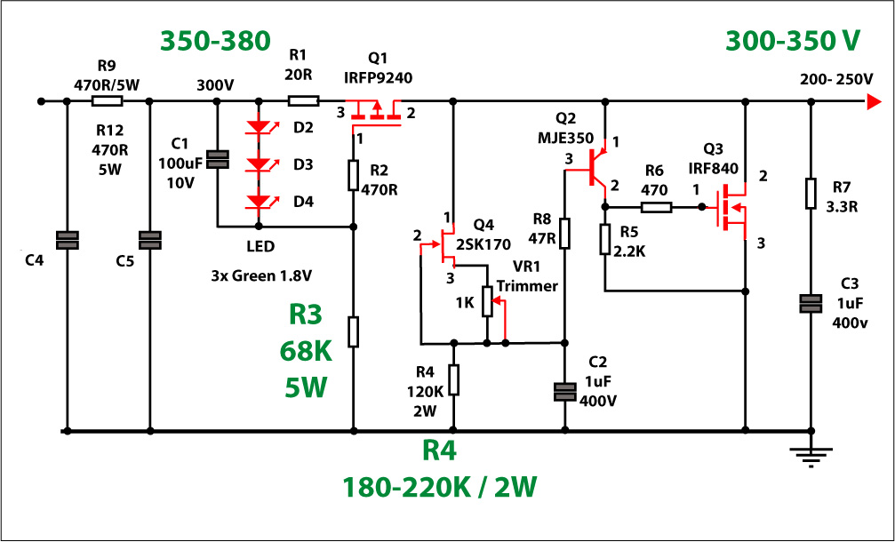

Also a somewhat related techical Q and forgive me if I should post elsewhere:
anyone tried this implementation to get a regulated B+ of 330V using Vin ~ 380V?
Yes! you can use Vin 380V - v out 330V. But
Note:
1. R 3 = 68K/5W
2. R4 = 200-220K
you can try do it!
Thanks QH
May I ask the R3 R4 references, which schematic are you referring to?
Seems like there are many posted on this forum,
Thanks.
Thanks.
Thanks.
Hi! you can see it!
