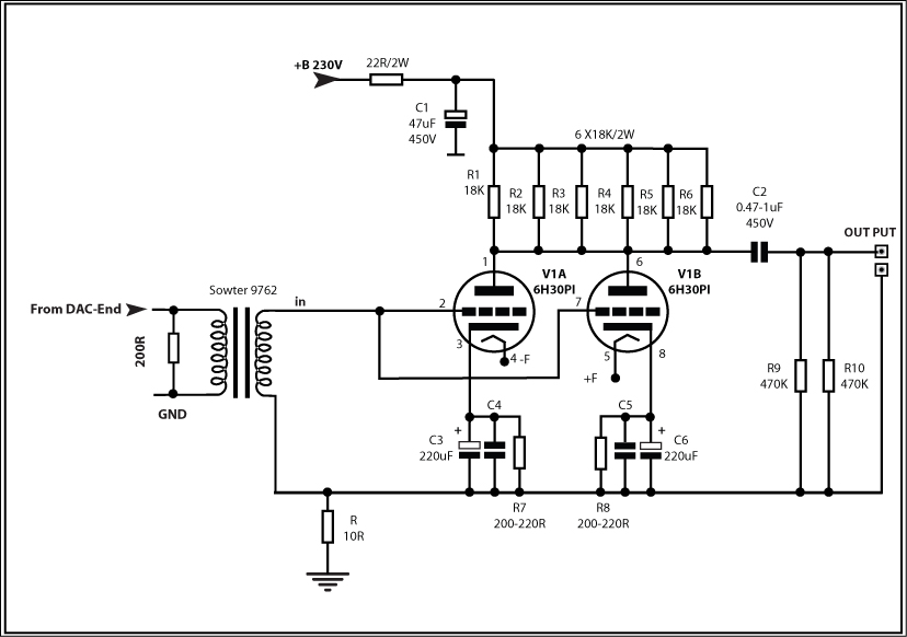

Sounds very interesting. I always wanted to hear a good E182CC output stage. What output transformers are you using?
If I can use 6H30DR's and Sowter 9762's I'm in.
JD
JD

Sowter Transformer 9762 DAC INTERFACE FOR AD1865N-J
6h30 DR , i love it!
You can use Sowter 9762, R gird, You can use or no, see that!
Sowter Transformer 9762 DAC INTERFACE* FOR AD1865N-J
what is the vantage to put a transformer between DAC and I/V?
With my little knowledge I think it would be better put a transformer after the tube to illiminate the C2, how Andrea have made in his DAC-End.
Klaus
Klaus
yes! transformer out put is the best for DAC-End!
