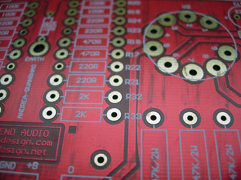

Hi quanghao,
I looked at ksnider1's I/V stage PCB that's clean with crispy copper traces and examined mine that arrived this morning. Why is mine so dirty and masked by something unknown, and the ground plane near R32/R33 is extremely deformed and distorted?

...and the ground plane near R32/R33 is extremely deformed and distorted?
Mine is also deformed in that place, looks very similar.. There have been some other quality issues also, with Salas output pads if I remember right..

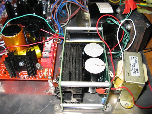

I have altered my unit so that it is now using Welborne's PS10 power supply. It is regulated and uses no electrolytics. 267 volts to I/V board with 105V on the plates. I have listened for a couple of hours and believe the DAC has more punch and dynamics. Could me my head playing tricks but I am going to keep it this way for now.

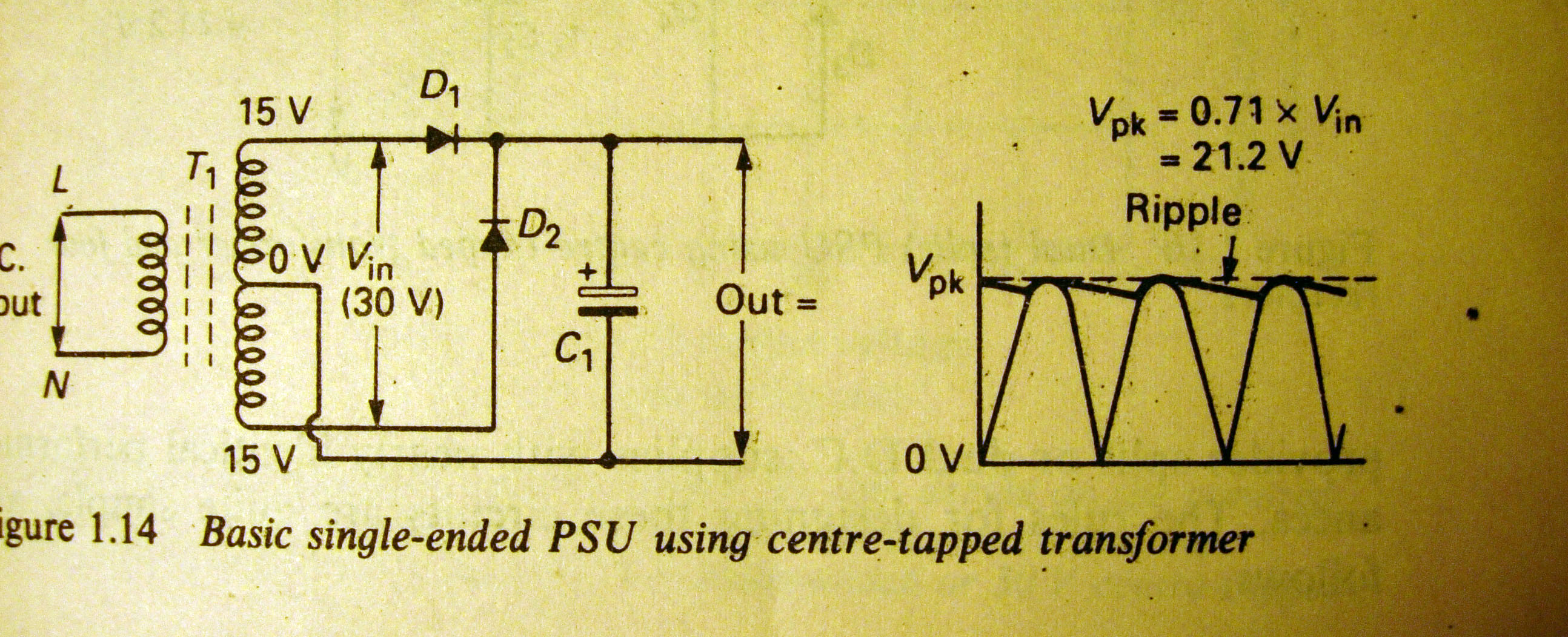

Yes I did, but I didnt fully understand what you ment when you said "use 2 diodes as a full wave rectifier"
Back to the basics 😀
CustomHT,
I don't have the regulator board, I have the HV shunt supply PCBs only.
Don't populate the 4 HV rectifiers and the 4 snubber capacitors on your board. Instead solder the center tap to a plate-thru' via connected to the -ve pole of C5 (100uF/450V) and the rectified HV to a plate-thru' via connected to the +ve pole of C5.
In such case, you can use the full 200mA capacity of the transformer.

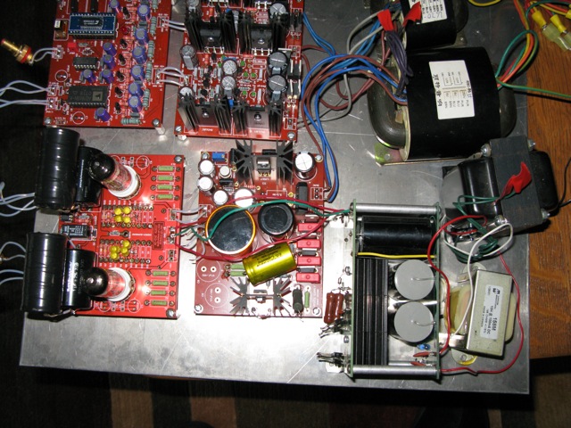

hav you got any pics bob?
Hopefully these help. As you can see I'm still getting the 6V from the IV PS board. When I settle on final arrangement I'll put it all in a box.
