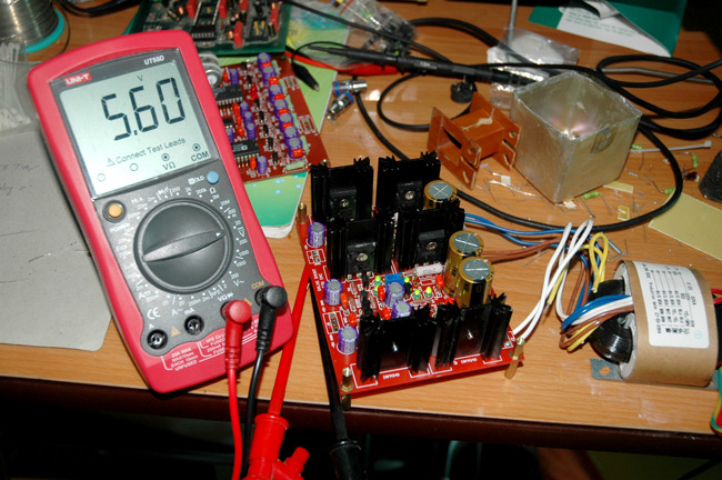

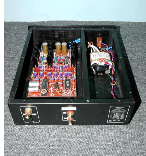

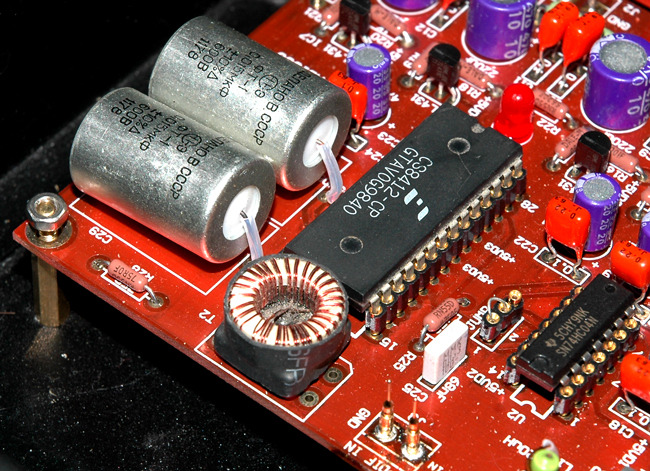

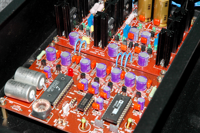

Some image of my friend s DAC-end2, no I/V stage
He use Cap Teflon input Digital, I love that, the sound is exelent
Very nice, with Teflon caps!
