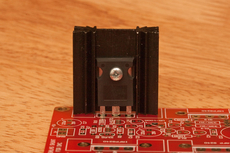

I'm struggling to find suitable heat sinks for the salas board.
Can anyone recommend me any?
Thats all i need now and then i'm done too. 🙂

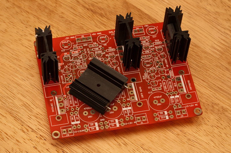

you will be ok without for testing. They dont seem to get that hot if you stick to 27ohms.
i used these, just because i had them..
Rapid Electronics - Electronic Components
The pins didnt fit perfectly so i just drilled the holes slightly bigger.

I got these today:
TO-220 Heatsink, Small Power Aluminum Heat-Sink, x 4pcs - eBay (item 260481603013 end time Mar-22-10 23:26:12 PDT)
Center hole isn't large enough for M3, but otherwise I think they are a good fit. No need to drill the PCB.
EDIT: Damn.. there is a M3 thread, not a hole.. 😱

Thats great. I'll get some. The TO-247 package fits ok?
Adamus, if i get these and they fit i'll stick to passive, thanks for the heads up.
Yep.. Maybe 1mm gap between the pcb and heatsink, but not a problem.
