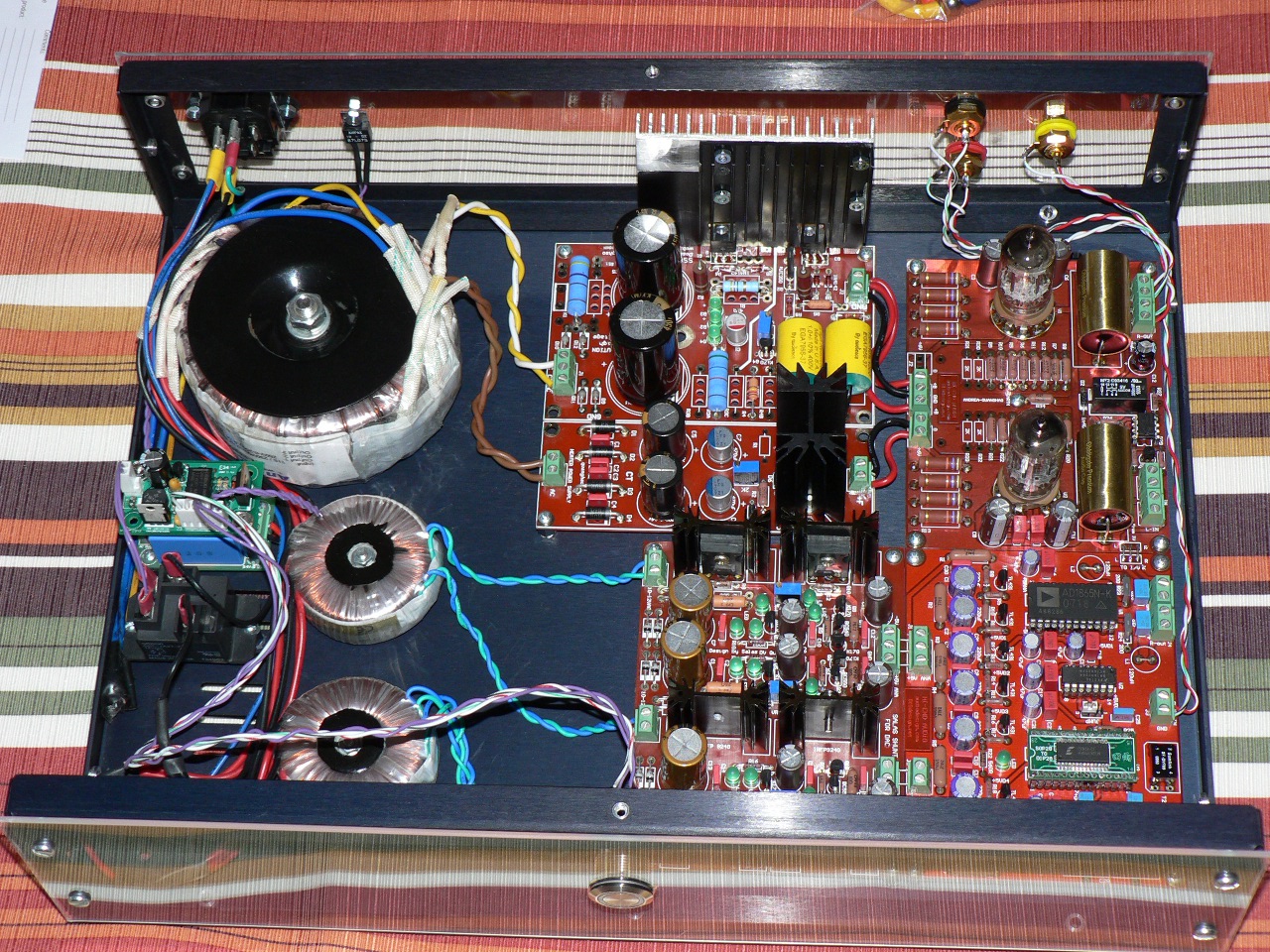

Ive a question- has it ever happened to any of you that one of the dac elements close to AD1865 gathered 50 Hz transformer noise that was audible in the speakers? i know that my transformer is too close to the pcbs but the guy i bought it from assured me its screened. When I put in optional chokes, its even a bigger nightmare- noise is audible at 9 oclock. Its less noisy when I put in a piece of steal between the transformer and pcb where the chokes and wires joining pcbs are. Thx for help
If your transformer is a nickle core device, you will have to take some extraordinary measures to overcome hum, regardless of screening. The core is a great antenna.
Separate .060 thick cold rolled steel box, annealed to Marstenite / Osteonite temperatures will buy you -120 db of external field rejection. Nickel and copper plate will extend that off into RF land.
Buy Ralph Morrisons book "Grounding and Shielding Techniques" to learn how to implement fully shielded boxes.
Of course, you could also start turning the transformer, rotating it in three axis and raising and lowering, to see if there is a null field plane you can use. Alternately begin changing the location of AC carrying wires with relation to the transformer.
Thing to know and use about EMF is that it is an infinite field, but you can shove it and form it by using ferrous materials with little permeability, as in the CRS above, or mu metal for high perm attachment . Think in 3D above all.

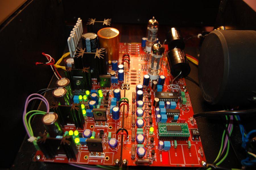

I've had a problem 🙁
The DAC stopped working yesterday. I pulled it apart and the power supply for the DAC (the salas shunt). has gone a cropped on the digi supply.
The 2 resistors have got extremely hot. So hot they melted my poor solder join. So I resoldered them back together and it's working again.
However the resistors are very hot to the touch. Also the 3 dropper LED's are only illuminating occassioanlly. Sometimes they don't come on at all. Other times they come on for maybe 2 minutes, then they go out.
The other parts of the shunt are operating fine (the ana. side).
Any idea's anyone?
