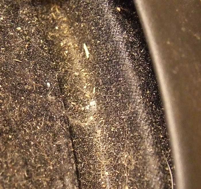

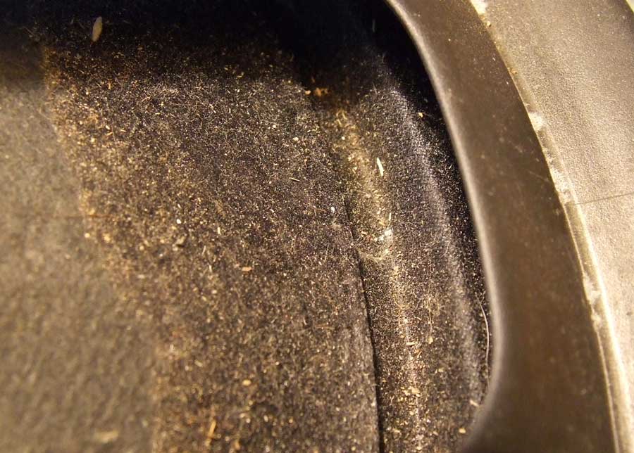

planet10 said:All the SSS drivers i have, have a separte coated cloth surround. You wil have to be careful as you play with the integral paper surrounds... some isopropanol to clean away the cat hair would be a good start.
dave
hehe
look better at first two pics .....it is coated cloth surround
cat hair seen from back side is probably residue of originally used damping material.......not asbestos based fer sure.
and- yes .......the other pair of oldies - AD1256/M4 have integral paper surround
Zen Mod said:look better at first two pics .....it is coated cloth surround
You are right... the pictures from the back fooled me (i looked at them in a different session)

That fibrous stuff on your surrounds would not be helping. Acetone may help remove it, but it may also dissolve the cone/surround and surround/frame adhesive.

beauties in B200 thread are AD1256/M4 (AlNiCo);condition as written there ;
these ones are AD12100/HP8 , ceramic magnet ; as seems to me surround is main reason for stiffness ,not spider.
and surround is clearly made from cloth .
btw-I have somewhere here just one AD12100/W4 - that's variant with rubber surround,black dustcap and Fs around 19Hz.......
