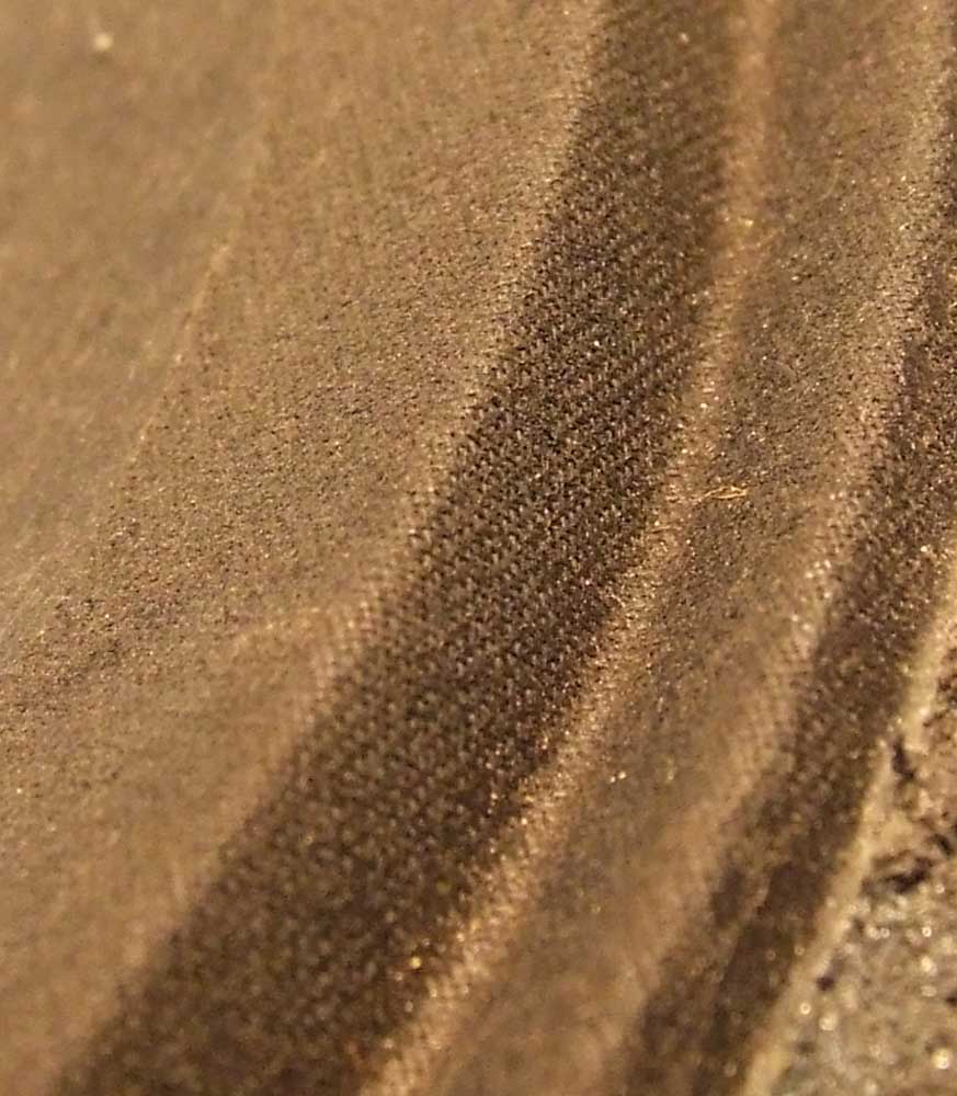

beeeezzzzzzyyy day.... just didn't manage to make few pics of my Philips beauties........
anyway - one more question.......
there is thing called "bitulit" in my country.
it's liquid tar , used as primer in construction work ,before applying melted tar or whatever named is.......
I know fer sure that few ppl around used "bitulit" for surround treating ;
one thing is- that dried goo on Philips surrounds looks exactly as sorta tar substance ; is it out of mind thinking that few tiny layers of "bitulit" on these surrounds can bring them to life.......dissolving old goo ?
anyway-what's exactly that semi-sticky goo on nice Altec and JBL and other pro driver surrounds?

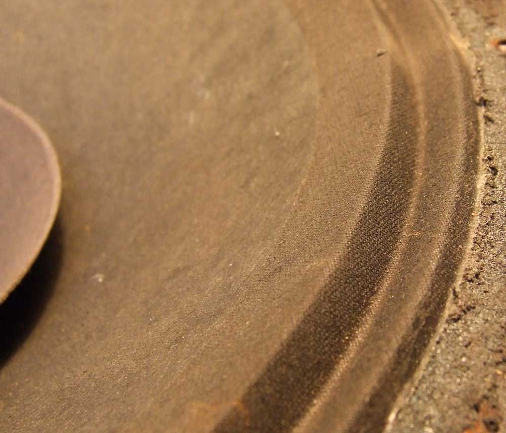

two pics as present for you..........
like I promised (seems mostly to my self 😉 ) there are few pictures;
first picture is surround from top........face of spk;
there is little to see of mentioned tar-like goo ,but this goo is actually protruded through pleating from lower side ,where is in fact applied.
