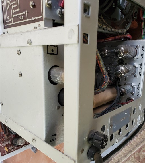

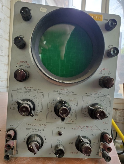

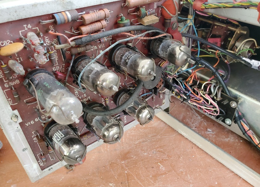

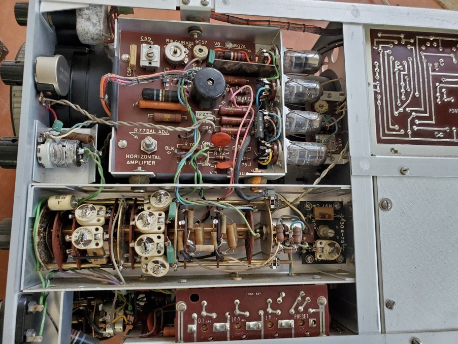

Short Version of Providence: Bought this scope at the Grand Rapids Community College Physics Department Garage Sale in 1993ish for 15 bucks. I am sure they bought it new, and at the time we had much newer scopes than this, so it probably hadn't been used in twenty years. From there I used it exactly twice, then it sat under the basement stairs at my moms house until 2017, at which point I moved it to my basement. It worked fine the last time I turned it on in 1994. I have not tried recently.
I had always thought I would use this someday, especially now that I have picked up this electronics habit, oops, I mean hobby. Knowing what I know now, it seems like a mountainous project. I have been restoring an old McIntosh tube amp recently and I see a bunch of the same issues here. There are about a half dozen tall can capacitors in the power supply that I am sure are all dried up. I am not sure how I would even go about replacing them since I haven't had any luck on a service manual to tell me the values (Radio museum has five pages but not even close to the whole thing). It has a half dozen bumble bee caps in it, and half of them are cracked. I spotted what look to be multiple selenium rectifiers all over it. And the tubes - There are like 30 of them in here. Only one was cracked, but replacement tubes for this monster would cost more than a decent used modern-ish scope.
I guess I am wondering - is restoring stuff like this even a thing? I am thinking about just grabbing all the great vintage tubes out of it and calling it a day. I was shocked to see a half dozen Telefunken 12AU7s in at as well as a few 12AT7s too (labeled HP but probably made by someone else).

I'm going to say that if you would be restoring it to use yourself then no, it is hopelessly low spec by any standards. 300kHz bandwidth for example. Its heavy, it will run hot hot hot...
As to new digital vs older analogue I'll say that a good analogue scope (a bit more modern that this one 😉) with something like a modest 30Mhz (so 100 times more than this one) will resolve and winkle out detail that 8 bit digital scopes can only dream of. In fairness both have their pros and cons of course and analogue scopes are fading into history. If you want one and can get a good one at a reasonable price then go for it would be my advice.
Back to this one, it would be like restoring a vintage TV from the early days of broadcasting. Fine as an interest and hobby but pretty limited if you want to actually use it for real in the modern world.

Start replacing electrolytics and paper capacitor (wax covered units) and checking resistors (mainly high valued ones).
Keep attention to voltages an the CRT socket. Some 2KV may be at the cathode if it is DC coupled to vertical amp. Also, high capacitance valued caps may retain such voltages several minutes post switching it off.

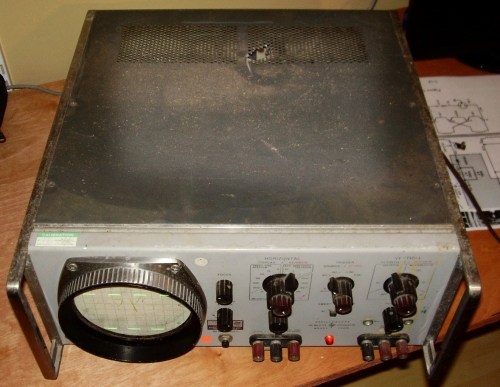

I got a HP 120. With a hole punched in it. It actually worked (see trace in image), but with issues. It probably was stored in a damp barn for many years and was tarnished in sockets and switches. I could make it work with much jiggling. I did not complain about the "low bandwidth" because it was faster and far better balanced than two of my prior 'scopes (an Eico 427 and a rebuilt pre-war Allen B DuMont).
However most of today's pocket-scopes are more practical, even if jaggy and susceptible to hi-voltage.

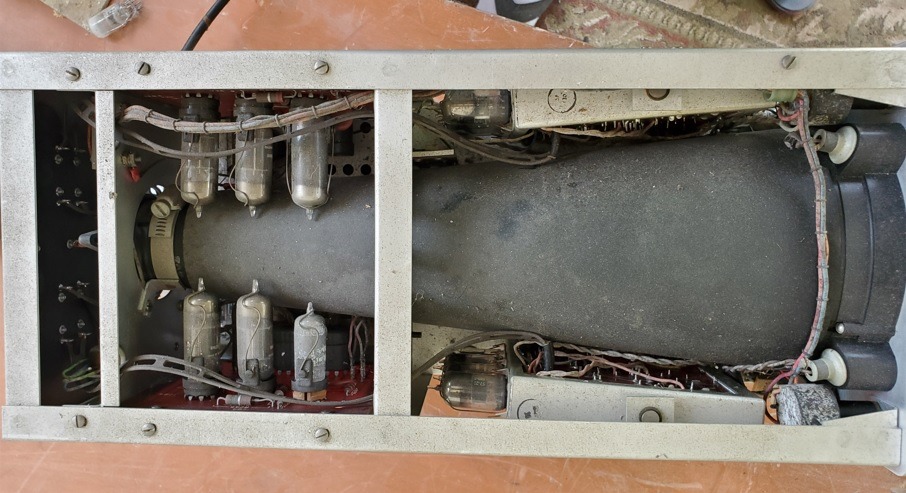

Not in the case of those CRT's. They don't have aquadag outside the glass bulb and low capaciance between anode and ground. In any instances, in the PSU may be a 1uF or so as 50/60 hz filter for cathode voltage. Generally, the voltage dividing network to bias the electrodes of the CRT (focus, grid, etc) form a natural discharge path, but be careful anyway.CRTs are themselves capacitors, and they can store a high voltage for a long time.
Several models use large negative bias at cathode and heater in order to have deviation plates and focus anode close to the final stage vertical deflection voltage to provide DC coupling or low potential diference in the coupling cap if any. So, the deflection plates may be at +250DCV as opposite to -2000DCV for example. Note that CRT heater is NOT earted and is very close to cathode voltage.
My suggestion at start is to locate and remove temporarily both rectifiers, low and high voltage, for example, a 2X2 and a EY81 or the like. Then, run the dut in series with a 200W filament lamp (no LED nor fluorescent) and let the main transformer to heat and evacuate humidity from it. Light bulb must run dark. If it runs very very brighty, may be a shorted HV winding in the transformer. If you don't have a bulb at hand, use a similar power solder iron or heater in place of it. The idea is to make a current limited voltage source whilst few firsts hours of powering the stuff.
