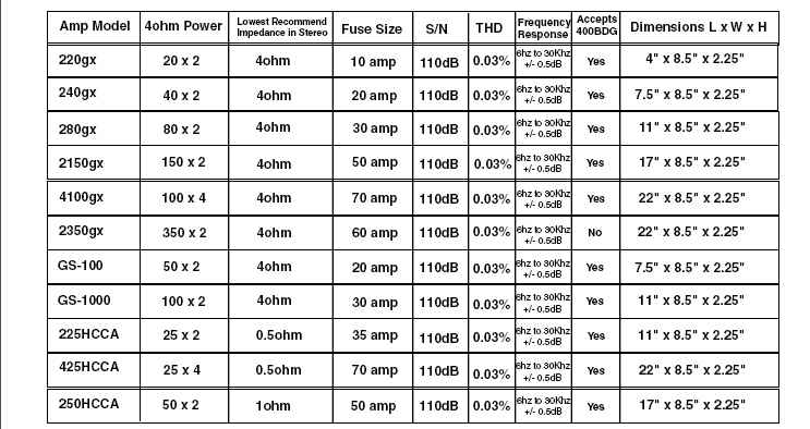

this is probably a dumb question as I'm pretty sure it would handle it but does anyone know for sure if this amp will handle 2 ohms stereo when in good working order?
YES, it will, but it will get very hot because of the transistor power supply. That's why all these amp companies went to MosFet power supply's
