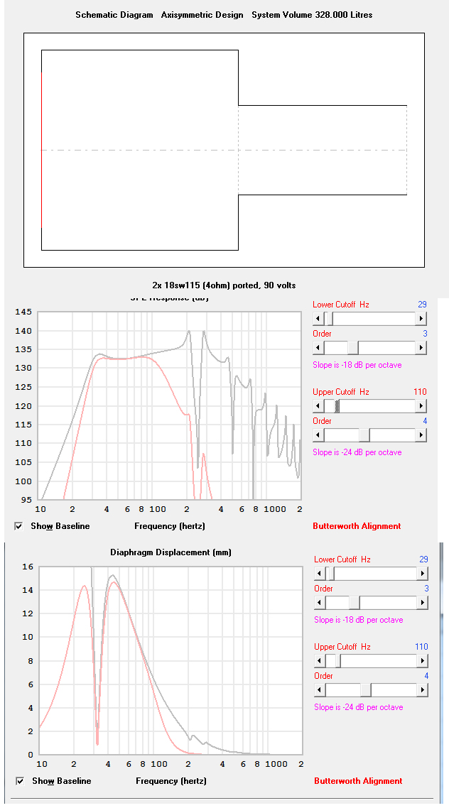

cabinet is likely tuned to 35z, similar to the dual bc 18sw115 cab I've attached (danley used to use the 18 sound 9600, but switched to the BC 18sw115 after experiencing some manufacturing defects, basically a drop in replacement, ie very similar performance). The picture I've attached is likely tuned a bit lower, and uses 4 ohm drivers (ithis is shown with 4k watts a cab, twice as much power that the PK subs get) (i can attach the 8 ohm if you like)
While the vented box might beat boxes from the 90s... Its really just because they are using a pair of 900 dollar drivers with 20 years of advancement. Drop those same drivers into a FLHhorn *slightly* larger (about 430 liters) or tapped horn and you can yeild the same performance with 50 to 75 percentthe driver and amp count (and half the power) ESPECIALLY considering that the PK sound boxes dont have enough amp behind them to reach xmax
It still suffers the same issues that every vented design does, port compression at high output (the vent is NOT that large). Why do you think they only put 1k watts per driver to them, and end up bringing out 40 boxes? >>> (so they dont have to give them much gas which would exemplify these flaws)

Here's a frequency response plot of the two boxes, based on my 'best guess' of their layout. This comparison is based on 400 watts into the CV's 4.87ohm load, or 44.14volts. I used this amount of power to put them on a 'level playing field', since it's not really fair to compare the 2500 watt CX800 to the 400 watt CV.
Here's some things I notice:
1) The most noticeable difference is the low frequency extension. The PK goes about half an octave lower than the CV. The CV also has a big hole in it's response, because the horn is too small. This problem is hard to avoid with front loaded horns, even the vaunted Danley Lab Sub has a hole in it's low frequency response.
2) Watt for watt, the CV is much more efficient. The CV has more output with the same voltage, even though the impedance is much higher. (Assuming the PK is wired in parallel, that's a minimum of 2.35ohm on the PK versus 4.87ohm on the CV.)
Here's the excursion of the two boxes. Here's another area where the PK wins out. While both boxes are going to need a high pass to prevent them from exploding, the high pass on the PK can be set much lower, because it's tuned much lower. The CV is tuned about 50hz, so it's excursion starts to get out of hand by the time it's playing 40hz.
Long story short: CV will get loud with less power, the PK will play lower.
The pk has a hipass of 30hz. It doesnt make use of its usable excursion with teh power supplied by the amp. When was the last time you saw less than 8 PK sound subs at a show (your picture has 40).

if thats your *real* estimate for 44 cx800, heres 16 500 liter FLHs with a BC 18SW115 a piece simmed to xmax @95 volts (190 with a 2 S pair) with a 28hz filter (2 hz lower than the filter on the cx800). Not bad for 16 drivers vs 88 drivers huh (and 18000 watts vs 110000 watts), and the FLHs still squek out in a little less pack space.
THis being said, its not quite fair. you accounted for the boost in output due to adding power, but not the boost in output from doubling(quadrupling etc, etc, etc) the radiating surface (SD).
Again... the CX800 has a *2000* watt amp. 2000. not 4000. not 2500.
^^^ I'm just going with what the website says. I'm not 100% sure if the data is accurate because they don't list whether that's RMS, peak, etc. And if they're using the driver that we think they're using, two drivers in parallel are more like 2.5ohms, not 4.
the extension of the matterhorn is wasted on music, Thus the reason Danley et all thought about making smaller ones. with approximatly half the path length the sub could be tuned to 26 hz (suitable for dance music), and be half the cubic volume. Still doesnt help much cause you STILL cant fit it in an indoor venue (outdoors its fine).
My curiosity about this stuff is mostly inspired by the people doing outdoor parties, where a system that could be run off a generator and towed by a car or truck is attractive. The Matterhorn concept has quite a 'wow' factor too.
Right now I'm crunching the numbers on something that could be built into one of those DIY trailers that they sell at Harbor Freight. I built one a couple years back, and it served me well. As I understand it, it's often used by people that build their own travel trailers too. The fact that it's readily available, inexpensive, and you can build it in your driveway makes it an interesting option for the DIY crowd.
