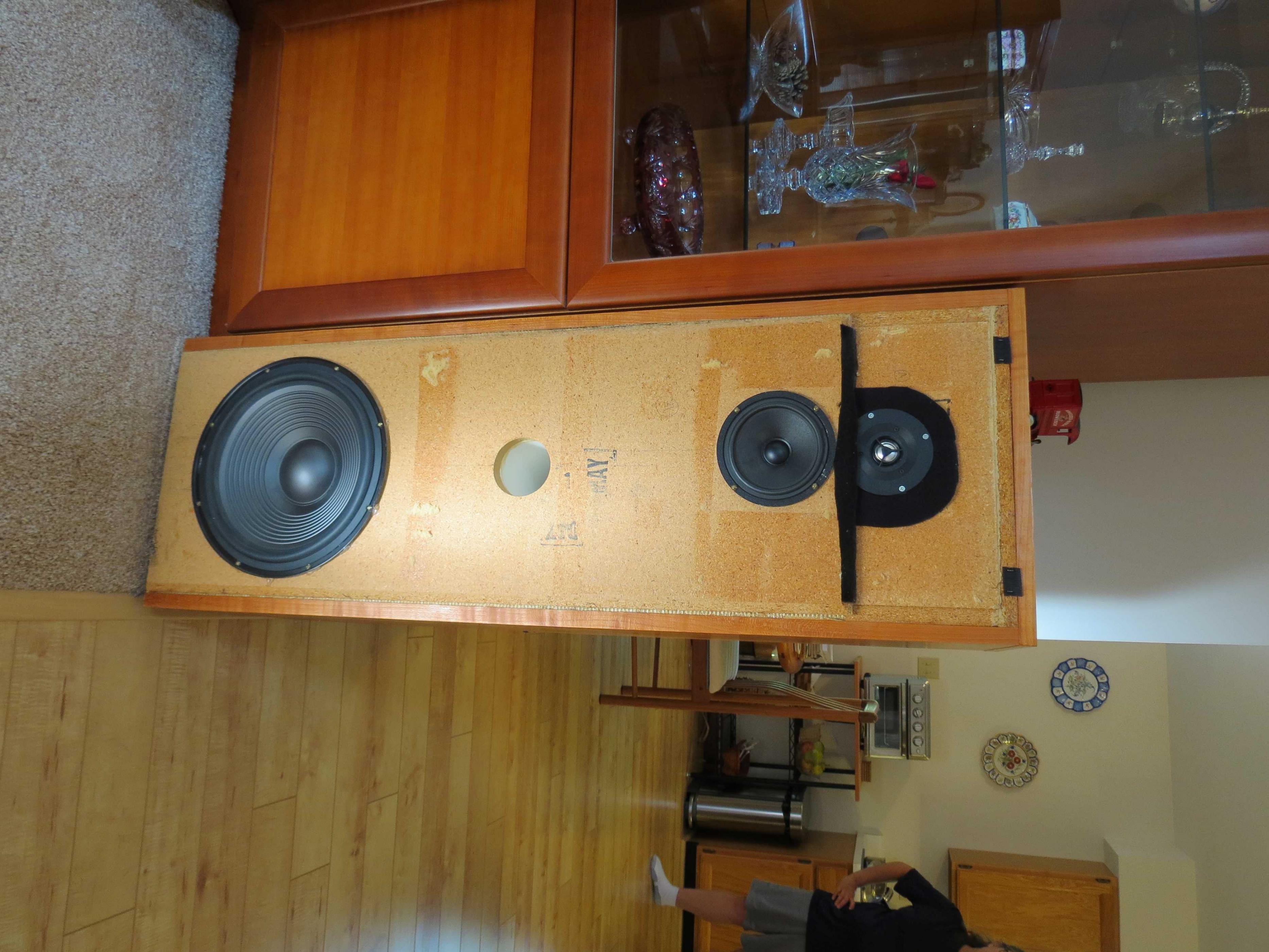

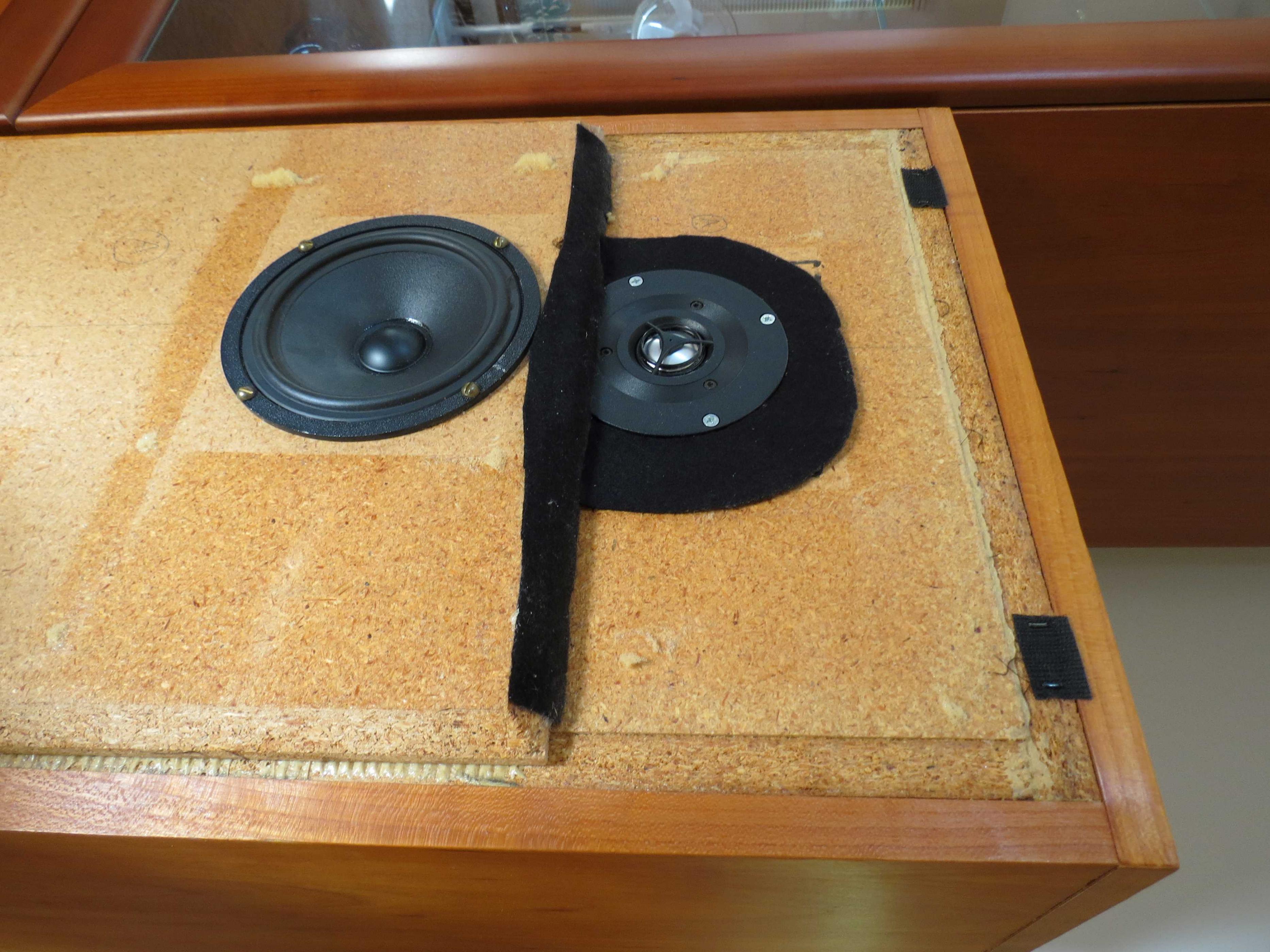

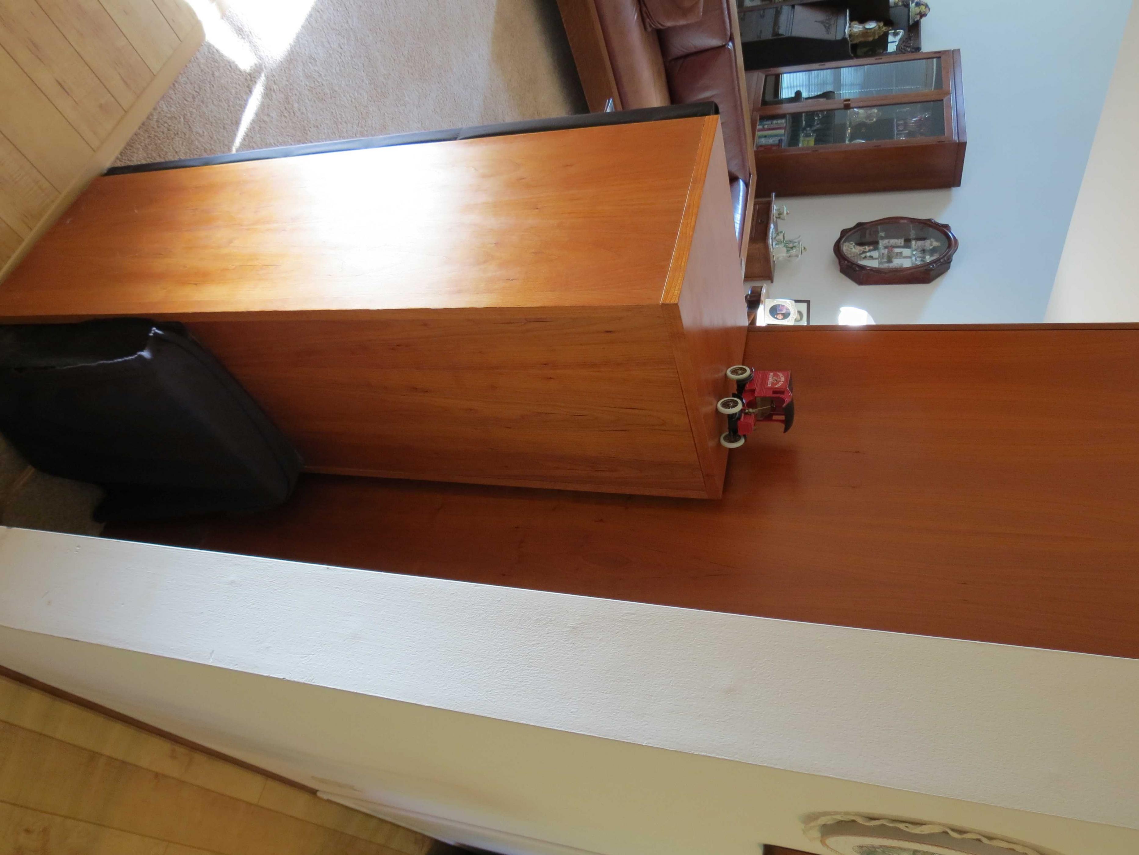

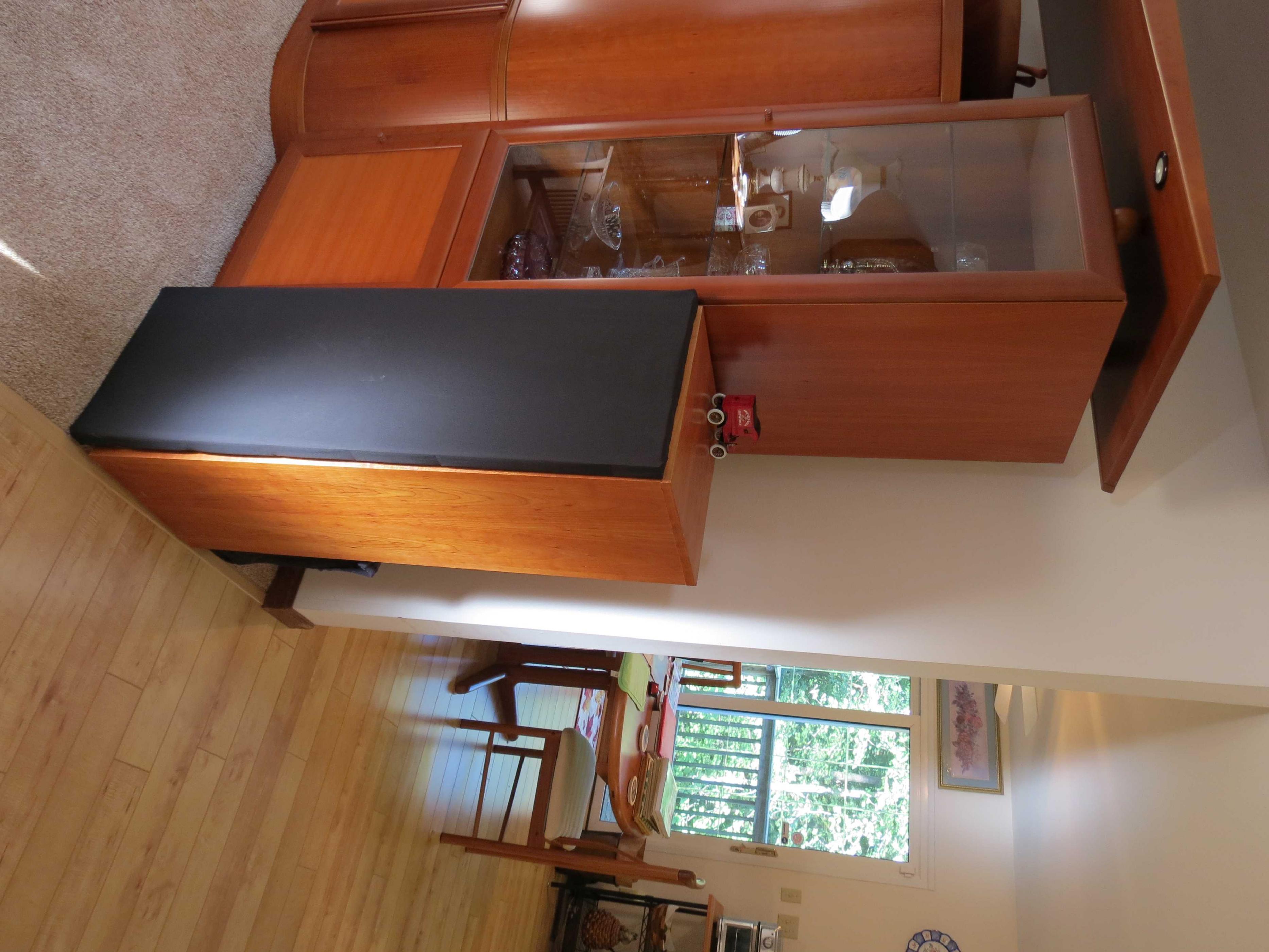

In 1992 I was ready to begin. Despite all the advice that a first design should be a 2-way, I really wanted a 3 way. I greatly admired the PSB Stratus Gold (unaffordable) and the B&W 801 (outrageously unaffordable), and I wanted to emulate these very fine speakers. I used a Carbonneau CG-308R 12” polycone woofer, a Vifa P13WH-00 5” mineral-filled polycone driver for midrange, and a Vifa D25AG-35-06 aluminum dome tweeter. Crossover frequencies would be at 250 Hz and 3 kHz. I built the 85 liter box from ¾ inch particle board inner wall covered with ¾ inch cherry veneer plywood outer wall, with a layer of latex adhesive between the two materials. The front baffle is 2 layers of ¾ in particle board, and it has a chamfered step between the midrange and the tweeter to move the tweeter back by ¾ inch. The vented box has a 3” PVC vent, tuned to 22 Hz. The alignment is an over-damped low Q with little group delay above 35 Hz. I went overboard on internal bracing.
After installing the drivers, I used the MiteyMike to measure the raw response of the drivers and loaded this information into the LMP crossover simulator. I then designed the crossover network. I could not measure the impedance (other than Rsc) or any of the Thiele-Small parameters, I simply trusted the published values.

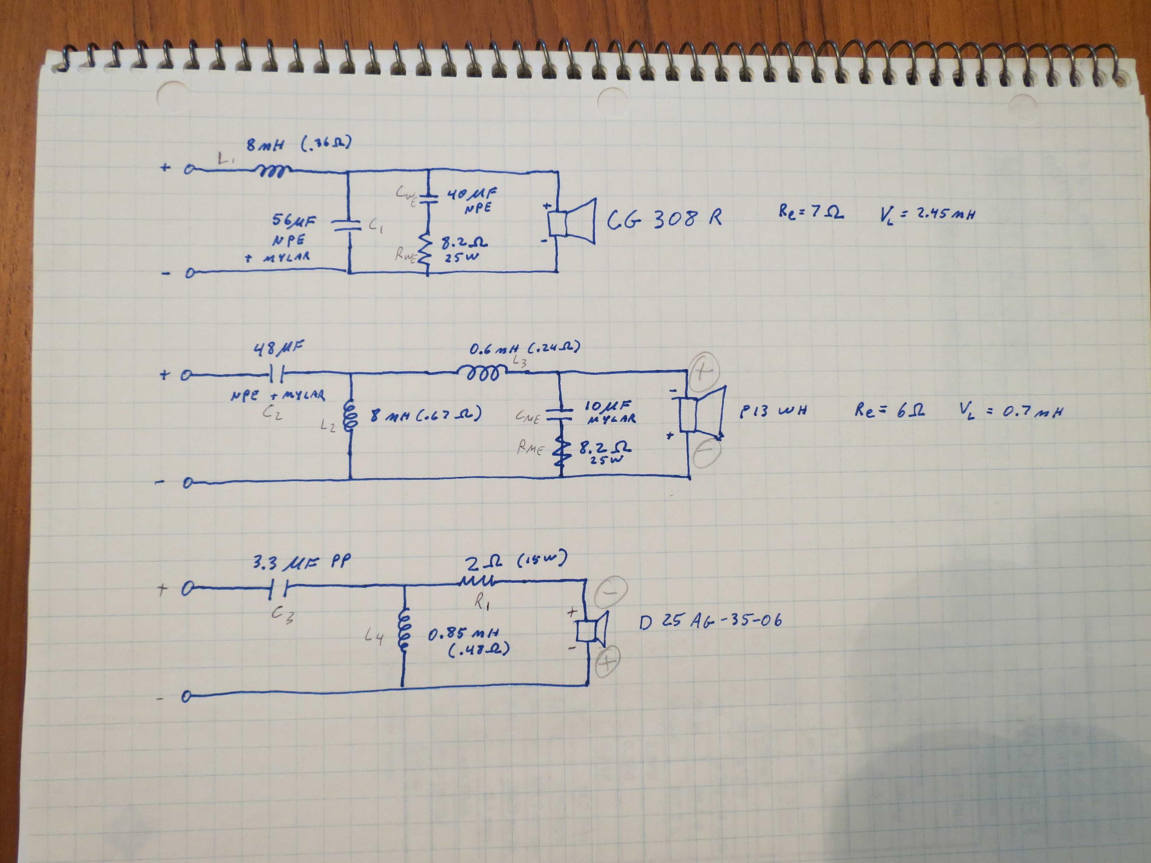

The lower crossover at 250 Hz is electrically 2nd order, and acoustically it is quasi-3rd order. I had to tweak the crossover twice to get it acceptable. The upper crossover at 3 kHz is electrically 1st order on the mid, and 2nd order on the tweeter. Acoustically it is quasi 3rd order. The upper crossover was perfect from the start.
Because I designed the filters after the cabinet was built, I mounted the crossover externally in a box on the cabinet rear, covered in black felt.

Knowing what I know now, here is what I would have done differently:
(1) I would not have used a stepped baffle behind the tweeter. I would have massaged the crossover to make it work with a flat baffle. I think imaging would have improved. The stepped baffle also made the grill design complicated.
(2) I used a 6" diameter PVC pipe for the midrange sub enclosure. I thought a cylindrical enclosure would be resonance free... well it is not. Theoretically there should be a resonance mode at the diameter wavelength (2250 Hz). It does not show up in 1/3 octave measurements but it is probably there.
(3) I would have used cherry veneer on the front baffle, and perhaps skipped the grill. The speakers sound better without the grill, but they are not pretty.
C2, C3, L2, L4 are likely unoptimized values. Standing wave of a 6" cylindrical enclosure is half of the 2,250Hz; and the 600 Hz resonance could be attributed to 0.29m distance, either the internal midrange enclosure depth or woofer width.
I agree on the points regarding stepped baffle and veneering. I'd fix it before attempting a new build.
Oh I have no doubt that some of the filter elements are "not optimized". In 1992 I did not have the ability to measure phase, only sound pressure magnitude. The cross-over simulation software of the day was crude by today's standards. Further, I could not measure impedance, so I could not verify that the impedance compensation network was doing the job on the woofer and mid.
I don't recall exactly how I tweaked the lower crossover. I think I added a small amount of resistance in series with C1, but I did not keep good notes. The jpeg image is the original "as designed" crossover, not the final tweaked version. I don't want to open up the back to see it, so it will remain a mystery.
