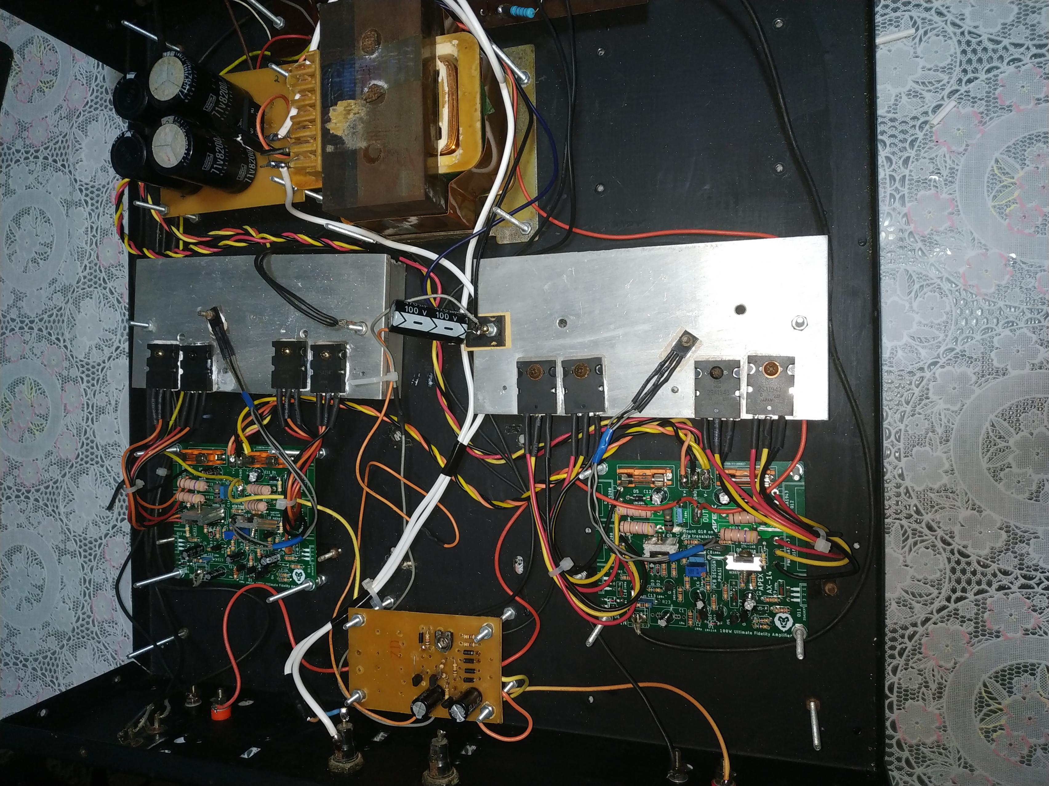

Hello Indianajo! all right? I am currently using OPA2134 in a pre-phono and subsonic filter, I have no problems with noise, which surprises me a lot. I'm using the Elliott Sound Products P06 + P99 project .. they are currently the best pre-phono I've ever assembled and listened to. However, this pre-phono, my cd player, and my cell phone are very low on this amplifier, so I want to use a pre-amplifier. Currently I set up a buffer circuit with a little gain to solve this volume problem. But I wanted to make a more improved circuit, one that is linear and is matched to the input impedance of the amplifier. Do you know of a good quality linear pre-amplifier circuit?
Thank you in advance!
Inverting op amp circuits with no capacitors or inductors in the feedback circuit are inherently linear, within their bandwidth. The 33 pf feedback capacitor around the resistor I used on the 33078 circuit, it kills the gain above several megahertz. Which is not used for audio circuits.
You build a pre-amp circuit, you are going to get into selector logic or buy a very expensive rotary switch. I think dynacodoctor has the switch, it is $40 or more. You want gold plate contacts for 1 v 2 v signals. Mixers just sum all the inputs together, and with metal film resistors and quiet op amps like the ST33078 & the NJM2068 there is plenty of signal to noise ratio for home use. Mastering they need a 110 db s/n but that is not home use.
If you scan around the analog line level forum you will see many threads where the OP wanted some recommendations for preamps. I think there was a sapphire selling boards, I can't remember them all since I found I could buy good mixers with bad pots for $30 + freight. I bought a Peavey MMA-800 mixer last week for $15, the only thing was wrong was the input connectors were missing on all 8 channels. But the freight was $32, the guy was addicted to fed-ex the expensive brand. The used market prices may be different in mercosur zone.
You ought to be able to change the feedback resistor out of your existing P08 project to raise the gain a little. Rf/Ri=gain. You may also be able to change the feedback resistor on the input transistor of you AX14 boards to jack up the gain. I did that to my AX6 board, since my ST120 board on the other channel has 28 db gain.
