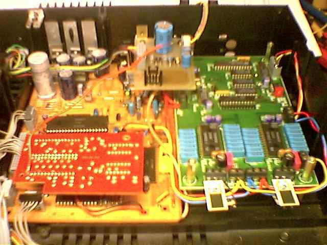

As said before, the cd650 comes close. See the picture. Don't mind the pcb on the right, it's not standard😀 Neiter is the one in the back. The one on top of the main pcb is for the MAB controller. In newer versions it is replace with just a MAB, without pcb (this is the inside of mine before i replaced it. Current state of the machine is totally different anyway).
As for the i2c, the connectors to the front pcb are a bit different. There are two: i2c and powersuppy. RC5 is on one too. But you could still measure the i2c lines. Sorry for the bad quality picture.
The 650 has four
controllers on that bus. As said, it's busy on there. Think the display is updated continuously. Pressing keys would result in separate messages from display driver to display MAB controller, which then sends other messages to the one on the main PCB (i think).
I know i could decode the bus, but it would take me quite some time. Thought of triggering on the key being pressed, but since it's a two stage affair, this is also not that easy.
In the u.s. you should look for a magnavox cdb650. Actually, mine is a magnavox too.

Yes Andy, a complete machine would be needed to investigate further. Still need to know which model has a track selection feature as this is the message I'm trying to capture on the I2C bus.
Guido, thanks for the picture. I can see that the CD650 does come close. You've made extensive modifications by the look of it. Well done! Please tell me if track selection was a feature of the original machine. Btw, I live in England!

The inside looks different now. MAB pcb is gone, new pcb with pmd100 is added, including a clock. PCB on the right is gone, new pcb added with pooge output stage. The machine is used for experimenting.
