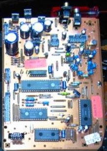

The PCB involved is an early Philips PCB marked "CMKS-81X" on the solder side. I think it dates from around 1989. I'm attempting to communicate with this module
using the I2C bus connected to a PIC device.
The problem is lack of knowledge about the message format required by the Philips DAC module. For example, I would like to know how to select a particular track, using the I2C bus, so I can progam the microcontroller to do this on demand.
The golden PCB contains the following chips: TDA1541A, SAA7220P, SAA7210, MAB8441, MN4264P and two LM833Ns.
If anyone has any information on this PCB, or knows where I can find it, please let me know!

Sounds like a pcb from a cd player, not a dac module. 7210 is a decoder. Take a service manual from any philips/marantz player from that era for more details. As for the particular pcb, guess it is trail and error looking into manuals. CD106/650 come close, but have TDA1541 without A.
However, i never saw any info on the communication between the controllers in such a manual.
The MAB on your pcb would instruct the TDA89xx chips on a separate PCB, connected to a cdm drive (cdm2 or 4/31). How did you intend to inject the music datastream???

Hi.
Can you post a photo of the whole board rather than just a portion ?
Thanks.
Andy

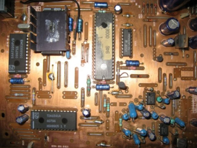

The heatsink on the MAB controller 😕
It's the 1541 that get's hot (and the 7220)
Weird.
As for your pcb, it looks a lot like one i took out of an aristona cd1006, which would be philips cd106. Only there the old chipset is used; 7220A and 1541 without A. PCB looks similar, only some components differ or are fitted/not fitted.
Transport there was a cdm2. Maybe your's uses cdm4/31.
The connector to the display/keyboard pcb (upper left in your picture) is 5 pins, right?
coding on pcb is 8204 055 01073 (guessing april 82)

The image is only missing a couple of cm at the top and few more to the right. At the top there are ribbon cable connectors to the CDM and the PSU. At the right there are PSU parts (regulators and capacitors) and the audio output connectors.
There ought to be enough detail here to identify the PCB, the chip layout and orientation are usually sufficient. In addition the PCB serial numbers are as follows:
Component side: 3104 103 34454 and 8204 055 01063
Solder side: 3104 103 34454 and 8204 055 01073
On the Grundig CD-9000 version of this PCB the last three digits are different so it's quite close. My version doesn't have the PCB headers near the LM833Ns
like the Grundig board, so fewer options are used.
I've included a shot of the Grundig PCB cropped from the Lampizator's photo of that machine (- thanks Lukasz).
There are probably quite a few early Philips CD players with this PCB so if anyone has a service manual with details of this board it would be great to hear from you!
Just seen new postings. The CDM is at the end of the ribbon cable and is working fine so there's no need to disturb it.
Guido! The PCB serial number you quote matches my solder-side number!
The connector in the upper left of my original picture is the I2C bus connector. This is the one I'm monitoring and looking for the CD track number, but so far that has not been successful. Was that connector used in the Aristona cd1006/Philips cd106?

It's a Philips CD160.
I have the manual if you want any circuit info (paper not .pdf)
It is also similar to the Marantz CD273.

The CD640 or CD660 is very similar.
