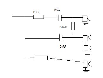

Here's where I'd start, L on the woofer will be determined by width of box, probably around 3mH...
(Values tweaked a bit so you can use off-the-shelf parts)
((also assuming 8 ohms for the tweeter))

Just found out what BSC is, baffle step compensation. So the width of the box determines how you would tune the crossover, or has a direct effect on which values to use. Check.
Also DCR is DC resistance? and so that refers to the resistance of the inductors etc.
So I may be doing this the wrong way around. I should have a box size in mind before designing Crossovers..
i used 8ohm impedence to calculate the values of the crossover.
If i series the 6" mids, then the impedence would be 16ohm? so then i would have to use 16ohm in the calculation correct? And just to clarify, Can i run these series'd mids off one crossover network point? (silly question but its bugging me)

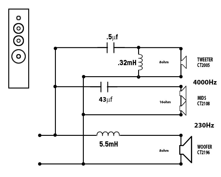

attatched is revised crossover network.. (im a visual person, need to have pretty pictures to demonstrate-i am a graphic designer after all 🙂

OK, generally speaking you need the tweeter at aprox ear heaight when sitting down, so if you use 1200mm as box height then the tweeter may be too high in the configuration in your drawing, but if you use WMTM then the tweeter would be in approximately the correct position.
I myself generally use MTM for its better imaging ( acts more like a point source ) but does need steeper XO slopes to work at its best, so unlike Peter I'd start with a steeper XO on the mid-range, at least 2nd order.
Just remember that this is opinion only as
1/ I've not used those drivers
2/ It is just my opinion
3/ I use a Behringer electronic XO for the low pass transition from woofer to mid-range and usually cross-over at the point where th mid-range stops working pistonically, that is usually around 100/120Hz
4? I love spending other peoples money
Konman, you're on the right track;
300mm wide gives you a BSC freq of 383, (115/width in m) this would make the L on the woofer 3.3mH & C on the mids 52uF; 3mH & 47uF are close enough off the shelf values
re: Can i run these series'd mids off one crossover network point? - yes
Persist with Winisd, it's not that hard & very useful once you get the hang of it, just make sure you have at min the following parameters when you add a new speaker: Fs, Re, Qes, Qms, Sd, Vas

We all have our sonic preferences, if you do want the deeper bass then go for ported, although that woofer does sound very good in a sealed box.
As you only got two woofers , one for each box then I would suggest that Peters option on running the mids in series is the best way to go.
I must confess that I personally do not worry too much about baffle step when building, but I do recommend crossing to the mid-range as low as possible.
If running MTM then ( personal opinion ) that the mids need a minimum of second order high pass ( natural roll-off is steep and clean so less needed on top )
Mids need 6litres per driver, assuming a second order high pass.
If you use just a first order ( Capacitor only ) then a lot of low frequency signal will come thru and the 6inch drivers will be operating partially in their pistonic range and you will need to do box calculations for them as well.
Cross the tweeters at 3K and the system should be plenty loud enough and not take too much tweaking.
Remember to offset all the drivers from the centreline and making mirror image pairs is best, don't forget the damping material in the boxes and remember to tie opposite sides together and add ribs to all long panels to break-up resonances and help damp vibration.
