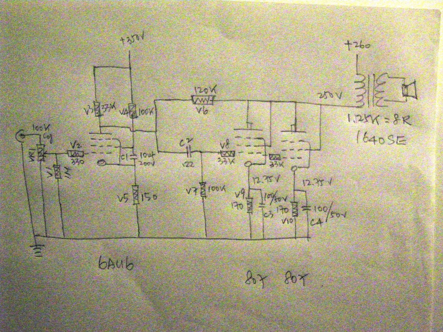

home brew 807pse
guys,
I lately check over the 807 data sheet and come up with the following schematics. Please do take a look and all comments are welcome.
BR
Albert

My intention is to make use of the 1640se opt. Since I have lot of NOS 807/1625 sitting around and this is why I tried to again make use of them. If the design is not workable. Please do suggest what the 1640se is good for.😕
Albert
