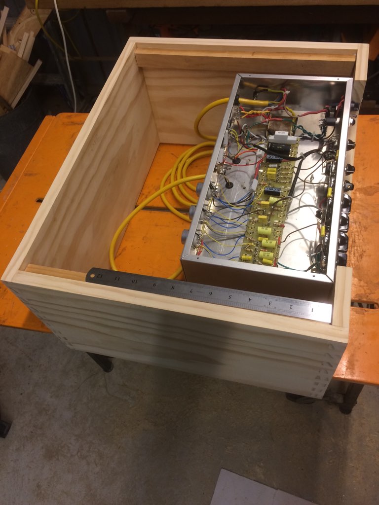

My brother is a guitarist and together we built a 1624T clone a few years back using whatever was to hand. Namely 5CZ5s instead of 6973s and 6EU7s in place of 12AX7s, a power transformer with 5V and 6.3V windings and an HT winding that was too hot. The 5/6CZ5 is near electronically identical to the 6973, much as the 6EU7 is to the 12AX7 (beware the different pinouts). The 1624T clone is in regular use as a gigging amp.
We used the 5Y3 but also considered solid state rectifiers with hefty power resistors in series to ensure sag under load. We used a fat power zener diode on the HT centre-tap to drop the HT. We took care to keep plate voltages below the maxima specified, especially building down here in Oz where the wall socket delivers 250VAC to the primary of a power transformer designed for 110/230VAC.
The max plate voltage for the 6CZ5/6973 is about 350V for a push-pull pair, compared to about 300V for the EL84. The 6CZ5/6973 has less gain than the EL84 - the EL84 is easier to drive but may well give less clean headroom. Not that that may matter ....
The 1624T input uses relatively high plate resistors (220K or more as I recall) on the 6UE7/12AX7 and has quite a bit of clean headroom. Not to say that the amp doesn't go filthy when pushed - it does, very progressively and with good control. Works well with pedals, which start to sound like what was promised on the tin.
For the OPT we used the reprehensible AUD$27 Altronics M1120 (here: https://www.altronics.com.au/p/m1120-20w-100v-line-pa-ei-core-transformer/) but could probably have used the AUD$19 M1115 (here: https://www.altronics.com.au/p/m1115-8-ohm-to-1.25w-15w-pa-speaker-transformer/) if we had only an 8 Ohm speaker.
Both the Greenback and the Webber are good choices, based on experience, with maybe more bass from the Greenback. If you want the ducks guts in 12" for working with pedals, try these: https://www.lorantz.com.au/loudspea...rs/12-inch-guitar/ac304p75-mi-12-inch-guitar/

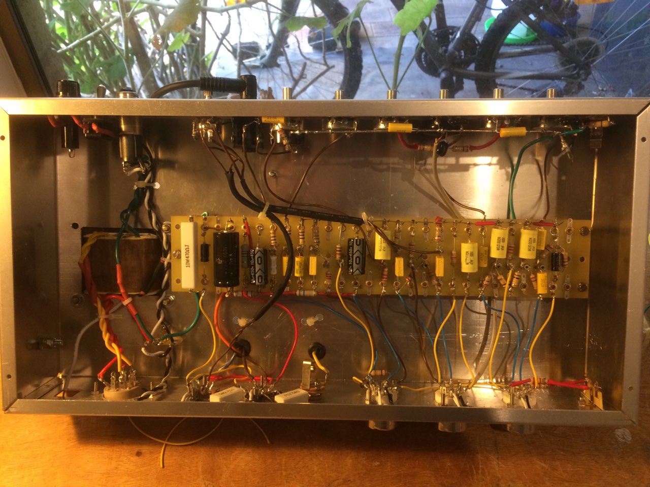

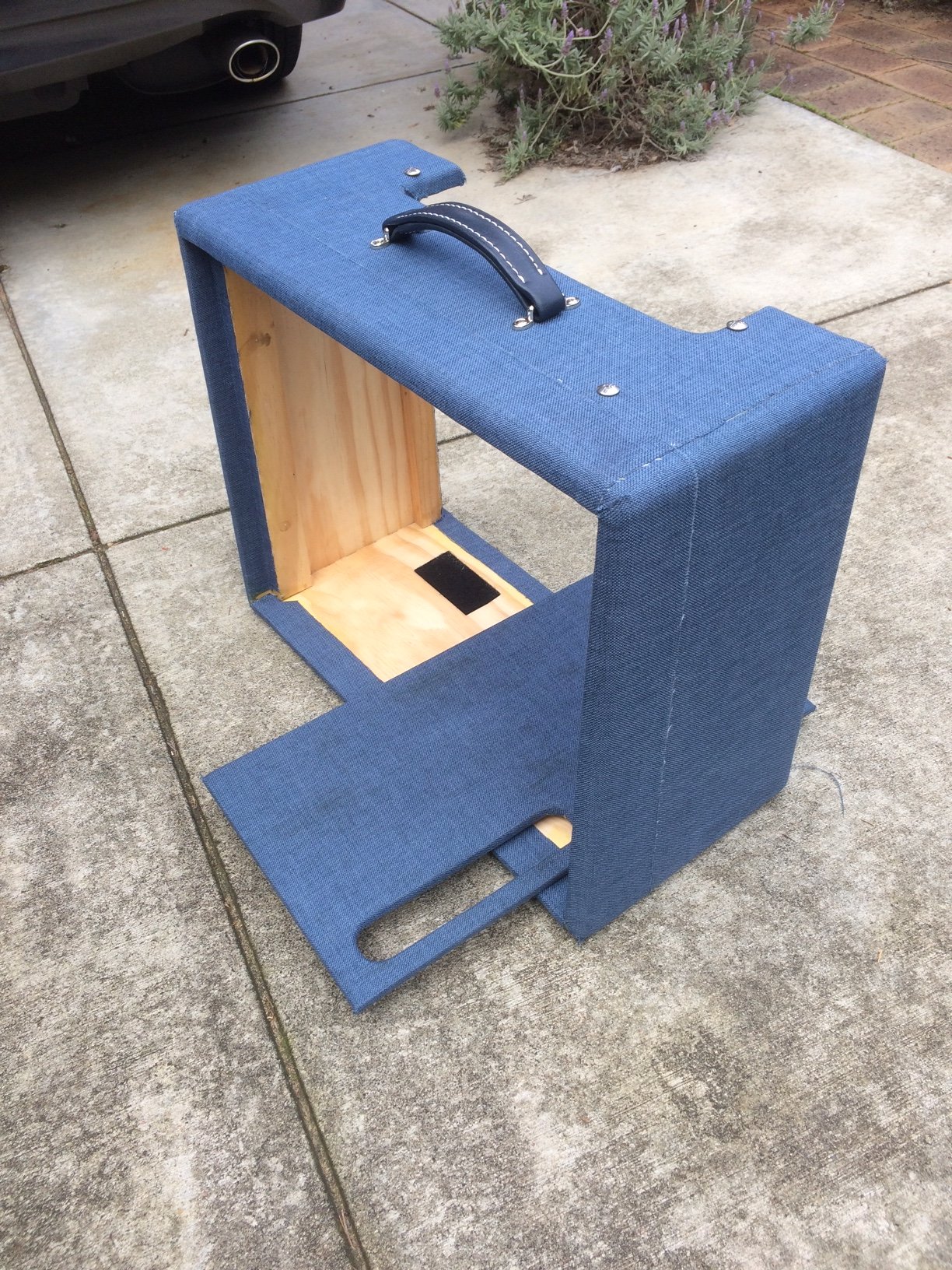

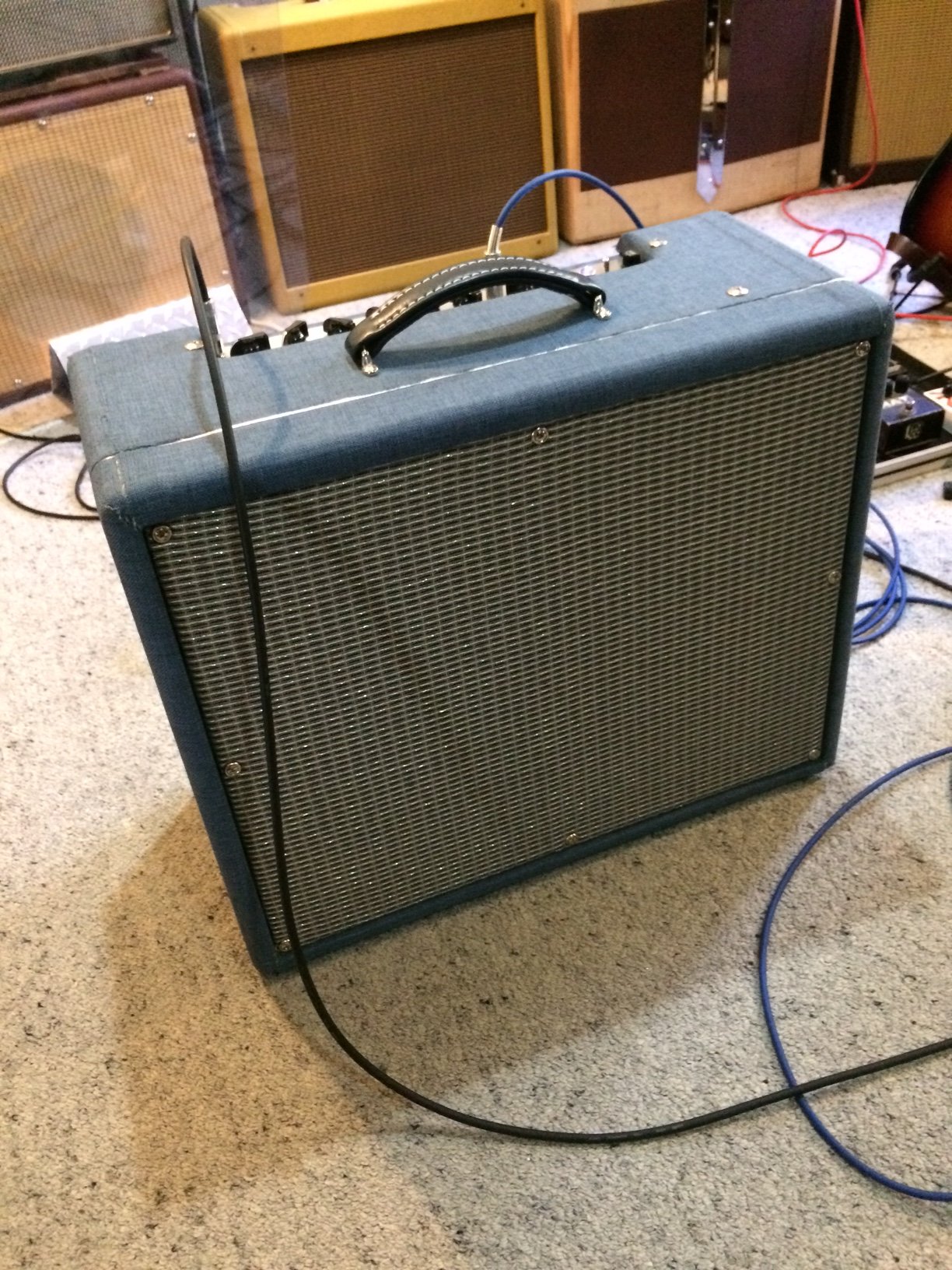

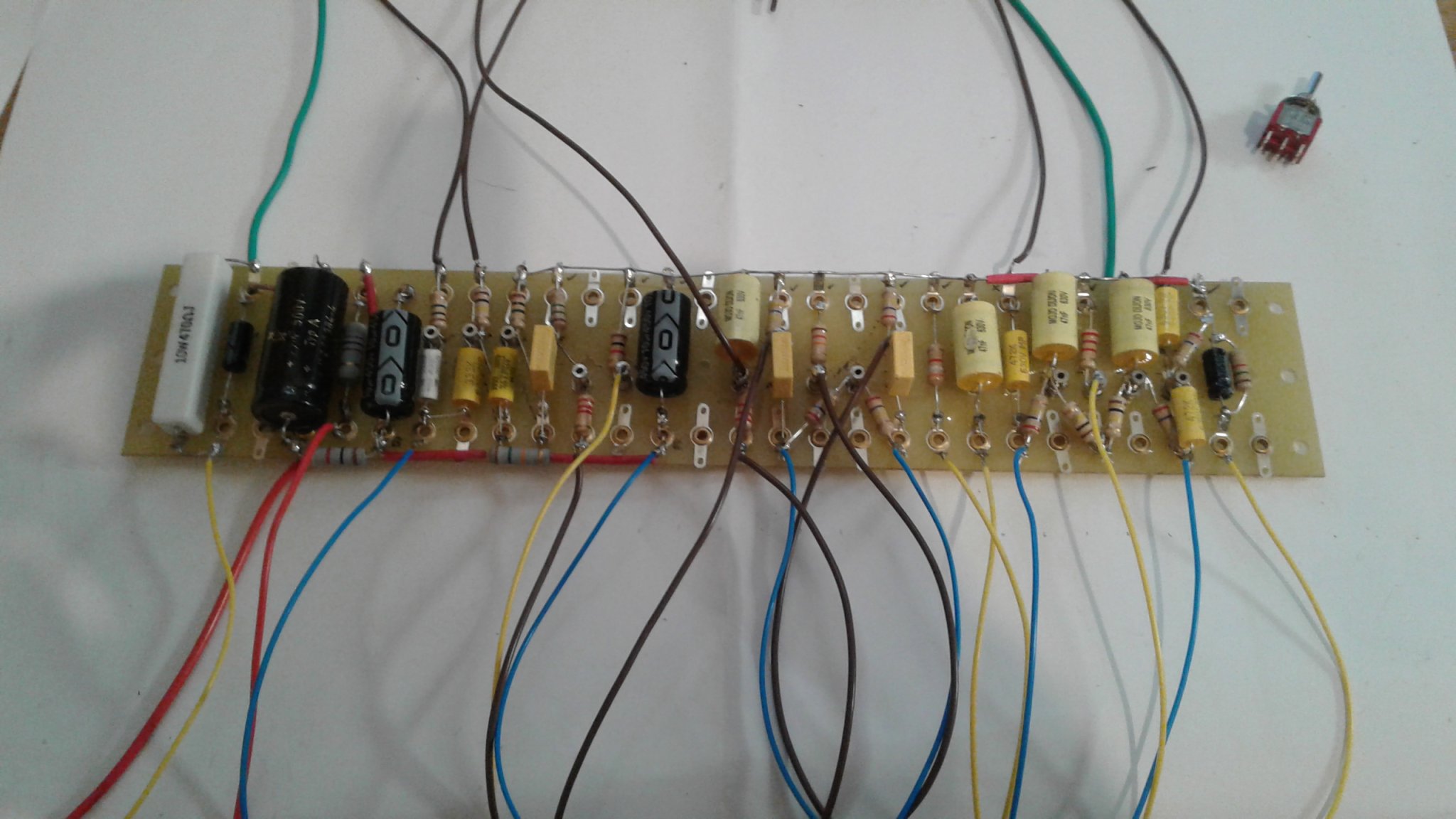

Here are my brother's comments, plus some pix of the build:

The old 5Y3 rectifier presents about ~ 350 Ohms resistance, according to Merlin Blencowe. This introduces a lot of sag in a push pull amp, and it's audible when you run the amp reasonably hard. It's part of the sound. Silicon diodes don't exhibit series resistance, but a similar effect might be achieved by adding a suitably high-powered 350 Ohm resistor in series between the recto circuit and the first filter. The absence of resistance in silicon also means higher voltages, and that could present problems of its own (see below re transformers).

My Supro uses an M 1120 transformer from Altronics as the output transformer. I used a power transformer from a kit for a tweed Deluxe because it's what I had lying around. It is a meaty PT, and I suspect it was designed to be suitable for either the tweed Deluxe or the Deluxe Reverb. All of this meant it was way too much PT for the Supro. The voltages were far too high throughout, which made it sound odd and completely neutered the tremolo. Lovely blue glow in the valves. Plinking sounds as they warm up. Not good.
I ended up putting a huge zener diode on the centre tap of high voltage secondary to tame the thing. This did the trick for the voltages, and also made the tremolo rock. It's now my favourite built-in trem. The Fender-style trems all seem to introduce the oscillation as far down the signal path as they can. The Supro does it right up front, on the cathode of the preamp itself, and as a consequence it bloody WORKS.

Thank you so much for taking the time to describe your build.

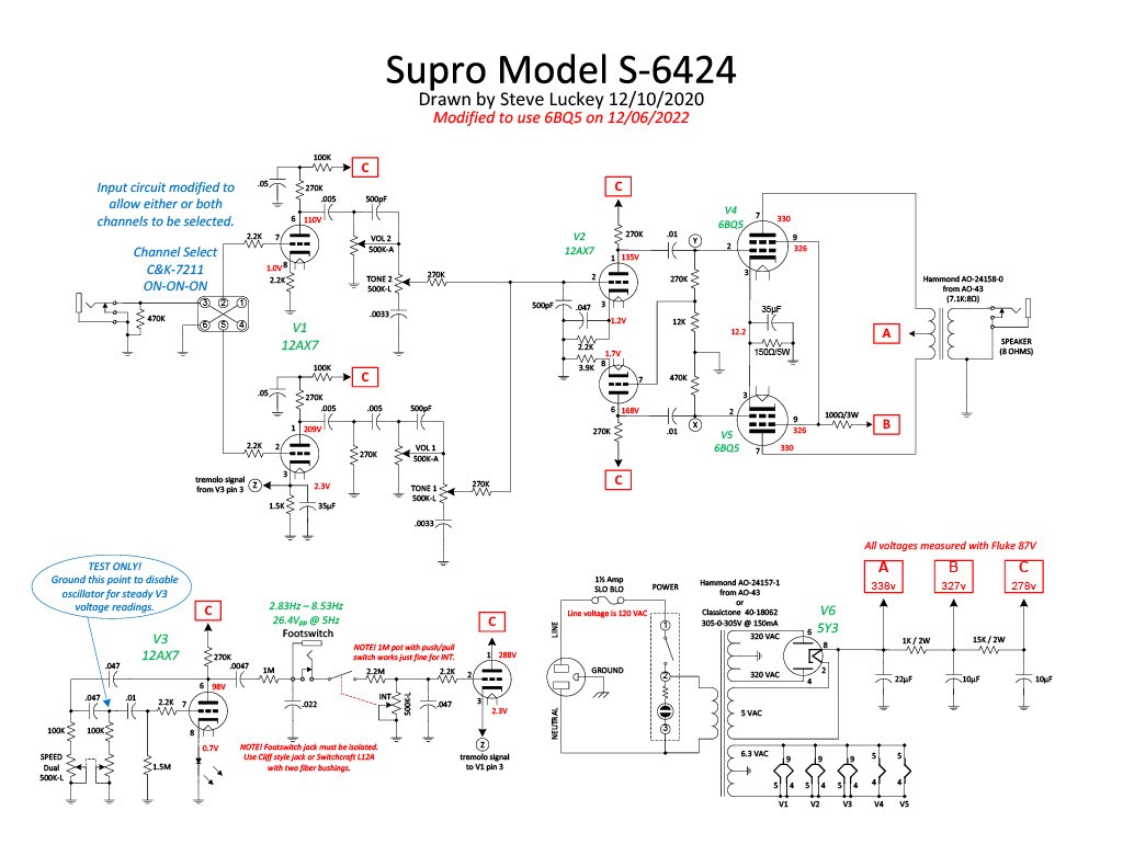

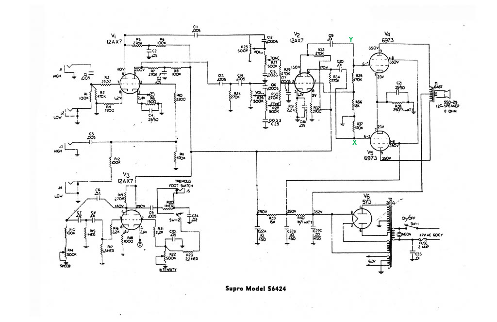

Hi guys,
I was able to find a Hammond 272FX PT 600VCT and a 1760 H OT for super cheap. I also found this schematic. I just got the PT which is new in the box and I will test the output votage.
The mains where I live run at 124VAC.
The amp will only be used at home to record with. I also found a used Supro DT 15 made by Eminence.
I will pre drill and cut the holes for the tube scockets with my CNC mill and then take it to a shop to use their sheet metal break to bend it up.
After I get this build done I will find a NOS set of 6973 tubes and mod this amp to run them.
Also, this is one of the original schematics.
