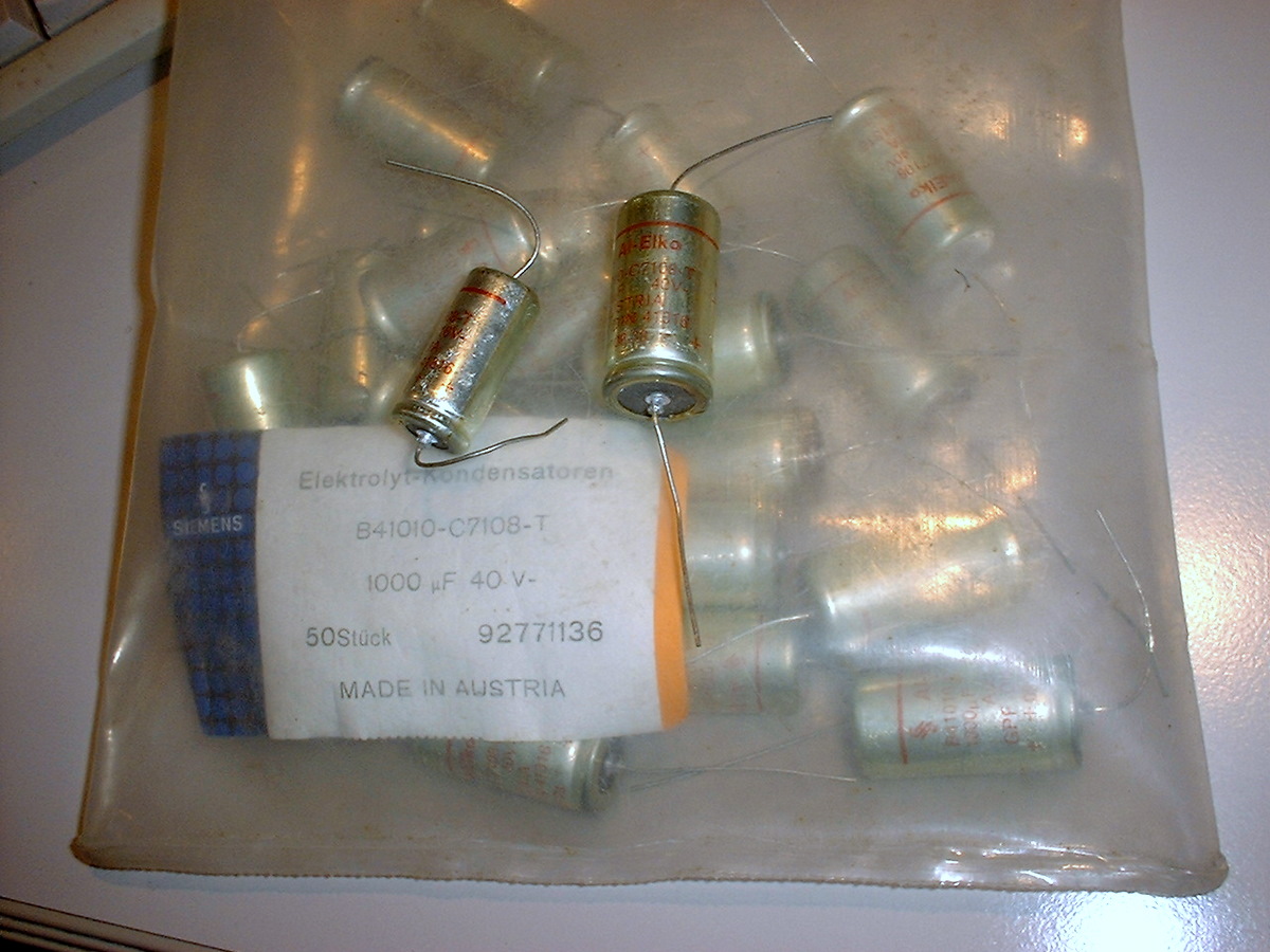

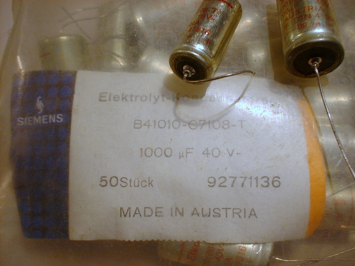

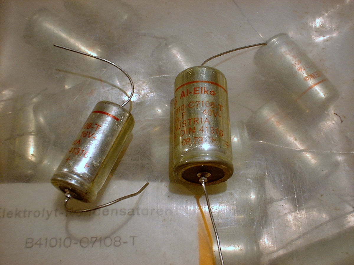

I have heaps of Siemens Al Elko "Elytics" from the early seventies, and they are as good as new, and measure better than equivalent modern parts (they are much larger though).
They do not even need the slightest reforming: more than 37 years after they were manufactured, they can take instantly their full working voltage.
On close examination, they look like as if they had been manufactured yesterday, the rubber seal is perfectly elastic, smooth and shiny.
I expect them to be in the same condition in another 37 years.
