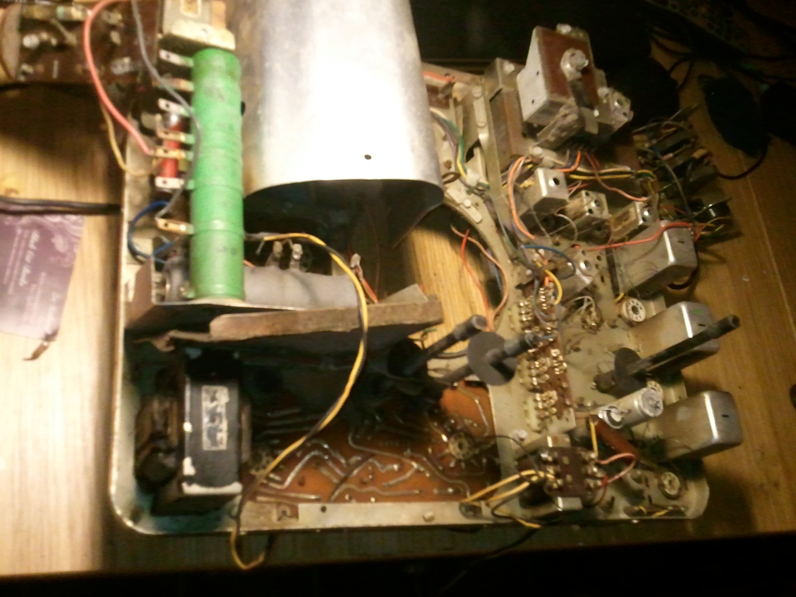

Hello. I have the guts of an old tv I pulled out of a skip. It had been robbed of all its tubes, mashed up and tossed aside. Shame cos it was a very beautiful ekco tv once. Anyway it is now dead so I would like to test the transformers to see if they are usable. There are four transformers in this thing, one is the output tran' of a single ended output stage, one is quite small and I have not looked at the circuitry around it to even begin to fathom its use. Another is in the power supply and I guess it is a 1:1 ?? But would this be rated for 240VAC, I guess so as the set is ac/dc, but I would just like some confirmation before a go throwing what is actually 272VAC in this area, at it. There is one last transformer of the same size, shape, number of windings and my guess is also a 1:1. could anyone that knows these old TV's let me know what I am playing with please. Thanks
You are playing with a live chassis TV. That means the mains is connected directly to the set and as it is AC/DC there is no mains transformer.
There will be an audio output transformer, a Line output transformer (tuned to either 405 line 10kHZ or 225 line 7kHZ approx) and a frame output transformer tuned to 25HZ,

Unfortunately the back was removed and I could not find it and I can not see a model number anywhere on it. I have no intention of plugging this thing in as I have no doubt that it is very dangerous even for those who do know these TV's. maybe if I look where the prim/sec are wired to someone may be able to have an educated guess of what one is what? I will try to give description of the remaining two unknown transformers and what they are wired to, tomorrow if one of you guys could help please? Thanks for replies I will update. For now, maybe this will give an idea of age....tv contained a u191 30p4 and possibly u26 (first letter is u second digit missing and third is a 6) but the cathode has a slightly different shape. The top of it is the same but going down toward the pins it looks like what I can only think to describe like, if you take a coke can and cut off the bottom and then cut 4 oblong sections out lengthways two large at opposite and two small opposite each other that is the shape of the cathode. Anyway those ones left inside as they was shielded by a half cylinder metal plate. Thanks for reading my waffle 🙂
An AC/DC set never have a powertransformer, and the tube types point to serial heater chain. Some early sets had the HT to the picturetube, several kVolts, delivered from a mainstransformer, a big one but only in pure AC-sets.
One trafo is surely for the vertical deflection, one for audio out. One can possibly be a choke for the +B.
The description of the tubes electrode leads me to think that it is the anode you are talking of, a Beam Tetrode possibly. Does it have a top connection? Then it is the horizontal output tube (or valve for UK readers 🙂 )

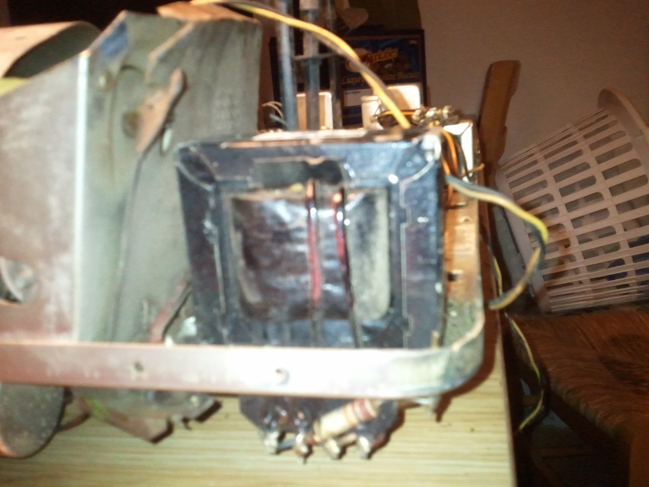

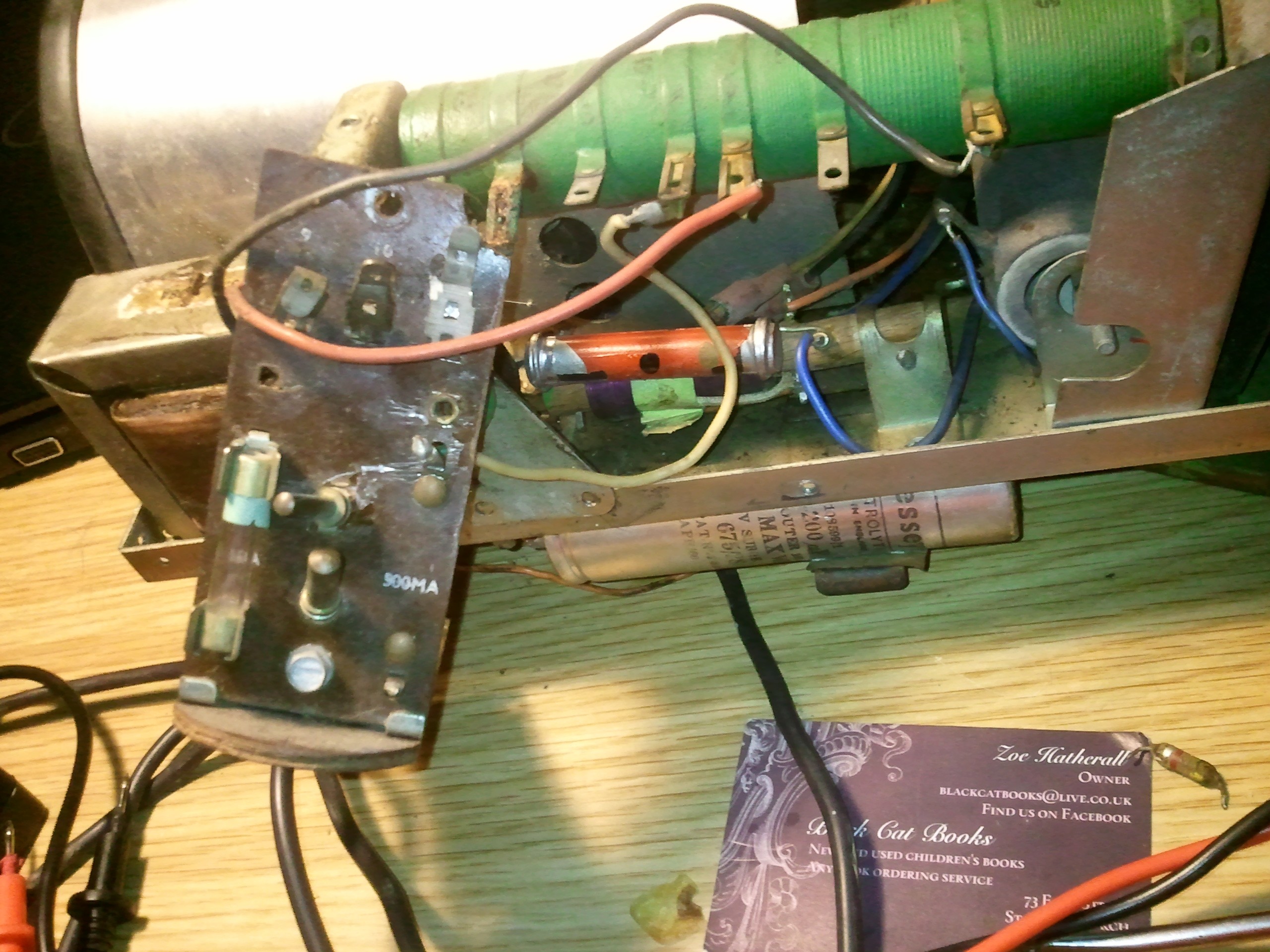

It is indeed a vacum tube thermionic valve 🙂 with the cathode conected to the top of the glass tube.(TRAF 1) One of the transformers is definately the output traf that does not appear to be air gapped but the center tap on the tube side is connected by cap resistor to one and other end of the windings, is this a usual arangement for a pp traf?. (TRAF 2) large transformer...... Has only a single winding and is connected one end to a really BIG cap (pysically size), and the other end of the winding is connected to a very tightly wound inductor of fine wire that is wound around a twig! with nails in it for teminals! (TRAFF 3)Is of same size core, but has two windings. (TRAF 4) Is the smallest, about the size one might expect in a 12 volt 500MA wall adaptor, i can see that at least one end of one winding is connected to pin one of an octal based 9 pin but that could surely mean anything?. This also has two windings. This set has two really big dropper resistors and i will try now to post some pictures but i do not know if thay will help at all. Thanks guys .... tuned or untuned to set frequency? what are the ramifications of running a tuned transformer at the wrong freq, and by "tuned" does it mean they are wound to a set tpv ratio for core size/frequency????
In a typical valve TV set there are only two transformers with some possible audio uses: the audio output transformer and the frame output transformer. Neither will be suitable for serious audio, as even the audio OPT will not have been designed for high quality. Think guitar practice amp, not hi-fi.
