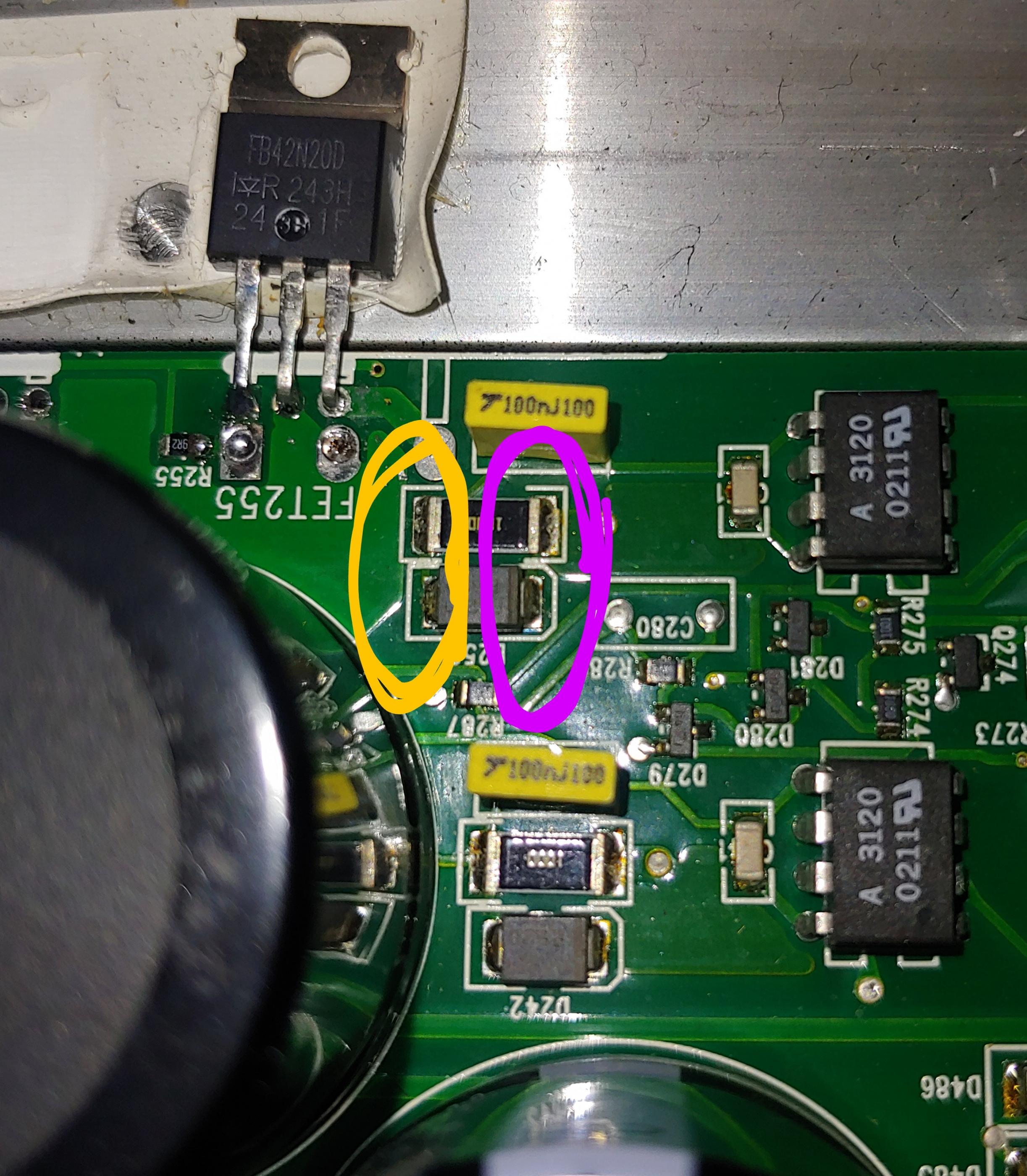

Got several mtx 1501d amps in (old design) that a fellow before me tried his hand at fixing. This one in particular I got the power supply running however i cannot get to output side to oscillate and the board mounted 42n20 mosfet (its entire drain pad is soldered to the board) gets quite hot with even a short power up of about 2 to 3 seconds. What is that mosfet's purpose?
(If it is any help, I currently have one 1 42n20 in the high side output bank and 1 in the lowside output bank. Led 399 illuminates (and of course 436 does as well) but led 238 does not. The previous person also replaced diode d199 and there are char marks around that SMD component.)

Don't reinstall D199 (striped end directly connected to the RCA shields). If the amp loses ground, the amp tries to ground through the RCA shields.
The FET in the center of the board drains the rail caps. It's normal for it to get hot if the power is cycled repeatedly, in quick succession.

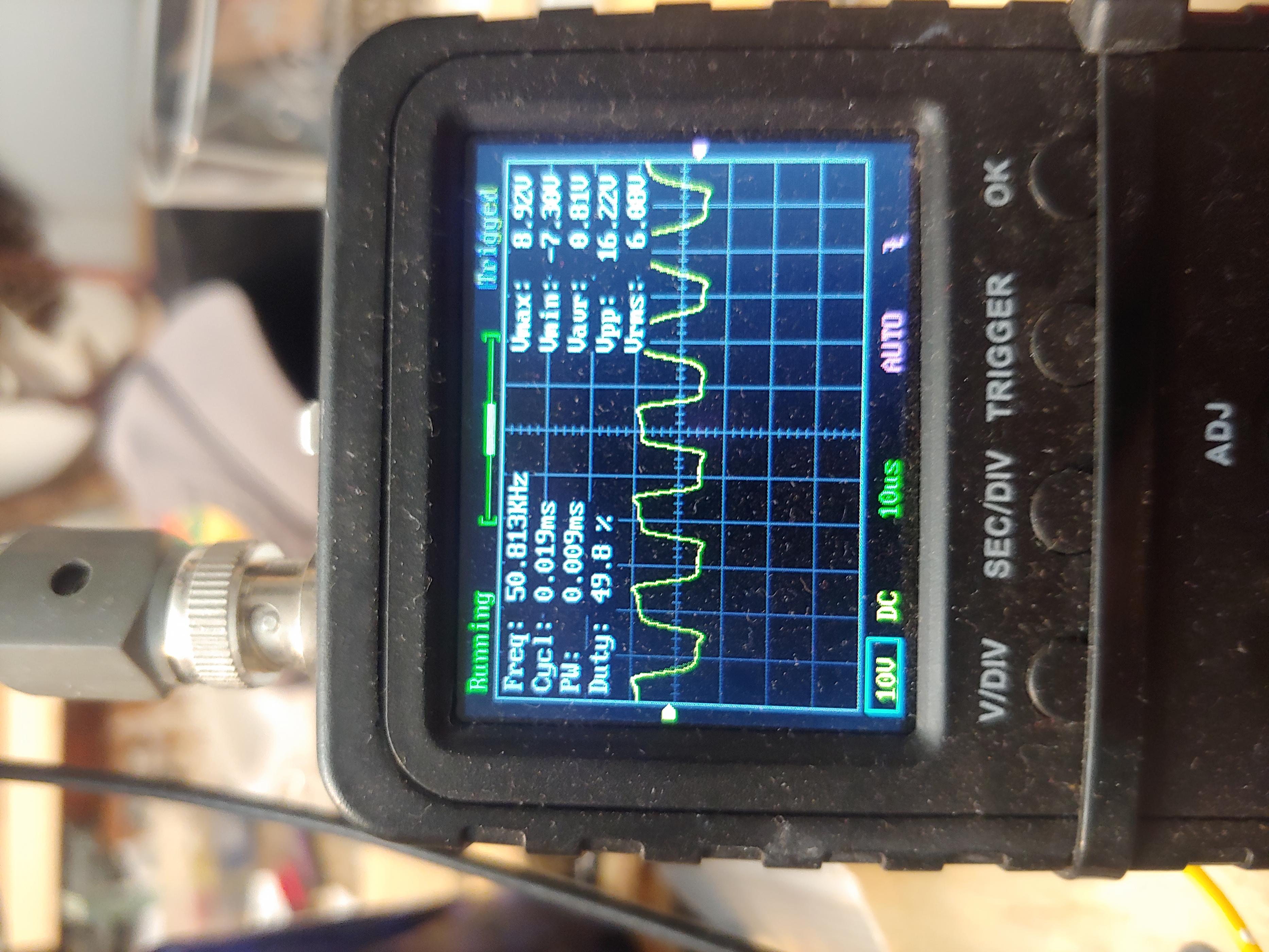

What's the DC voltage measured directly across pins 5 and 8 of each of the two 3120 optocouplers?
Turns out I was too chicken keep the amp on long enough for the output to begin oscillation. LOL (the amp wasn't in the heat sink so I couldn't keep it powered on for very long.)
So I clamped down in the heat sink and powered it on. Pins 5 and 8 on the optocoupler nearest the edge of the board read 19.7 volts. On the other optocoupler voltage read 18.9 volts.

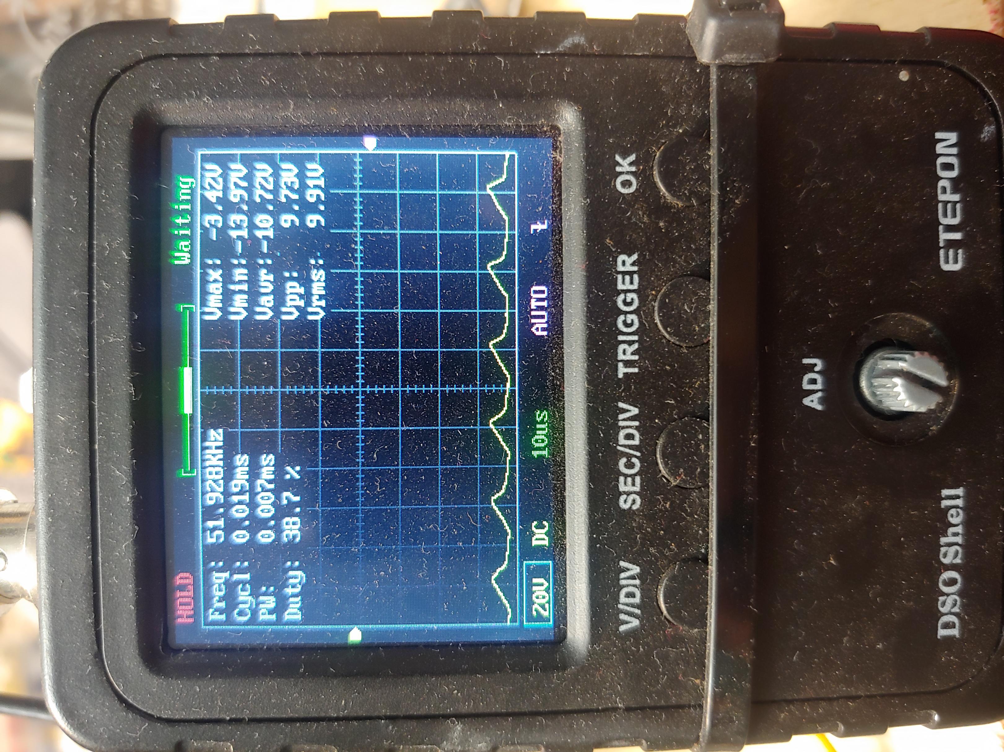

There is a Drive wave on the gateleg however it looks like complete trash. I'll post back with subsequent pictures of the waveform.
This is the gate drive on the low side.
