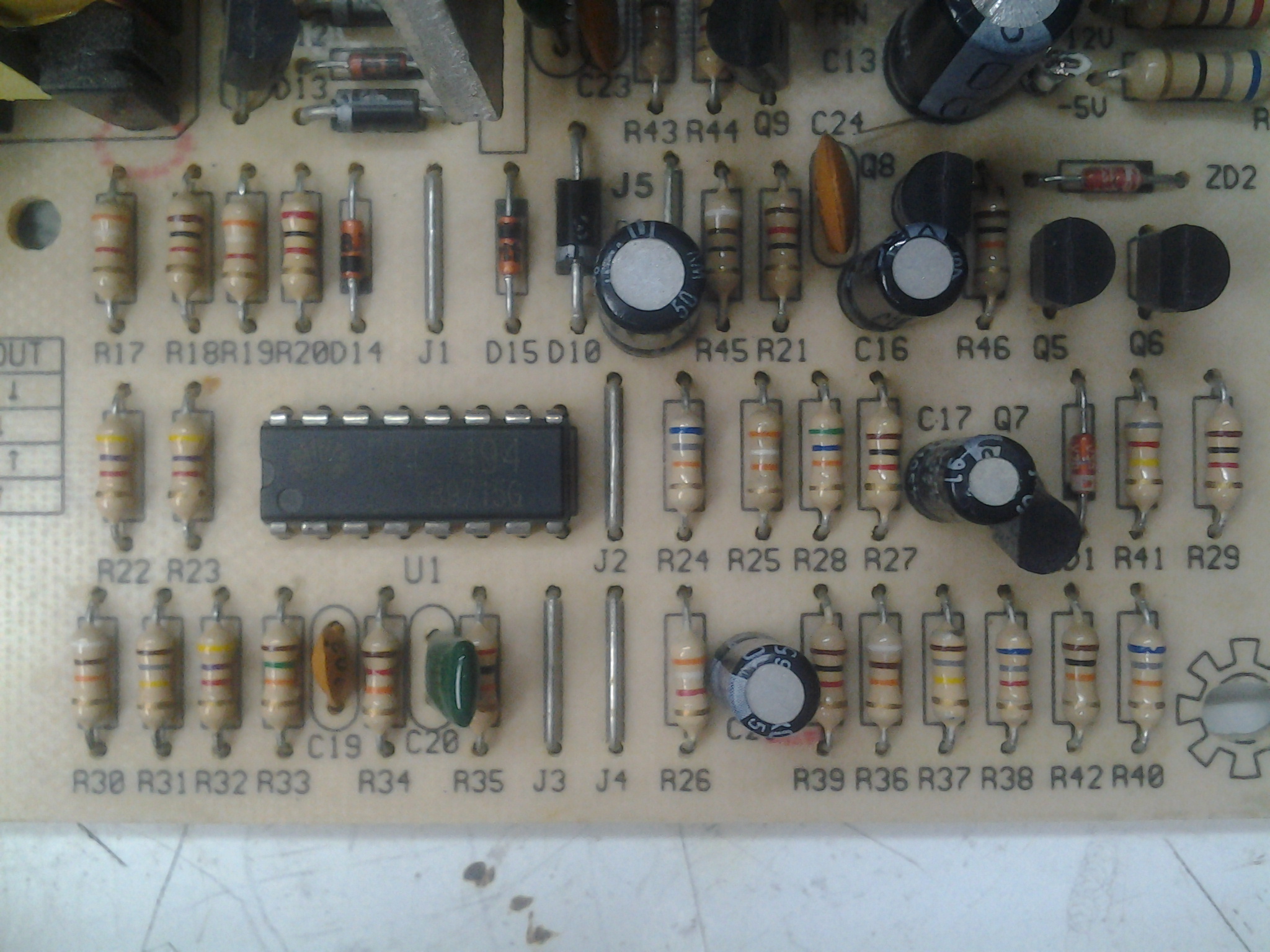

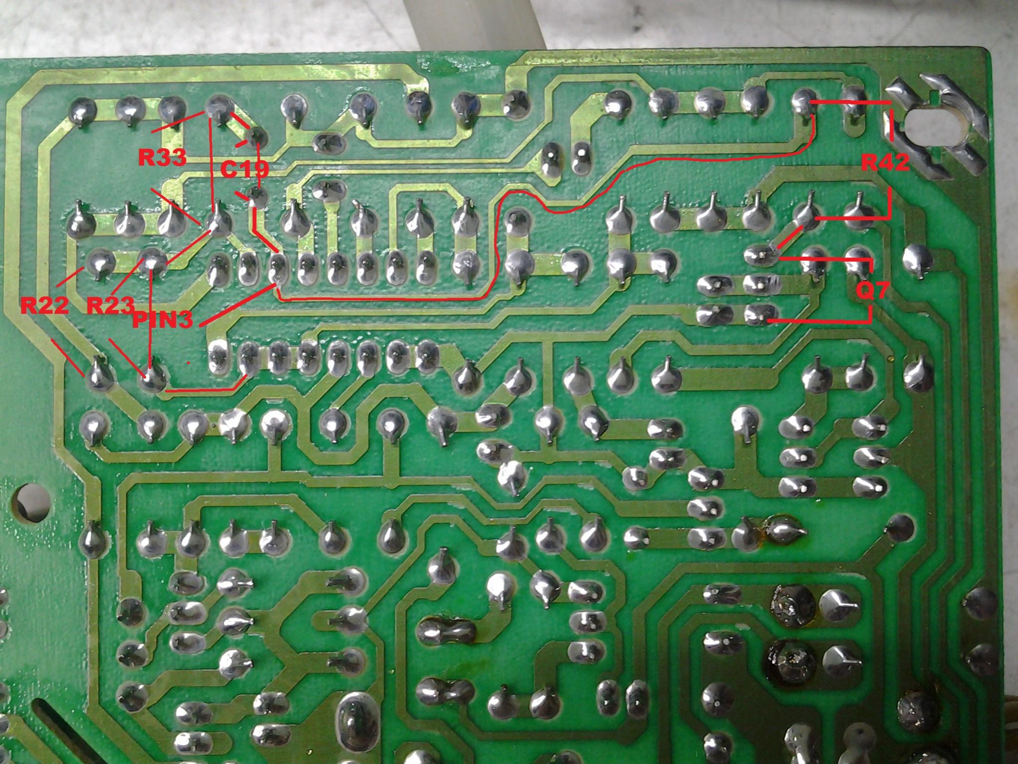

After reading datasheet for dbl494 i found out that pin 3 is feedback.
http://html.alldatasheet.com/html-pdf/58383/DAEWOO/DBL494/365/2/DBL494.html
On PCB i traced the lines from controller pin 3 and marked the resistors (picture below).
If i am not wrong R22,R23 is feedback resistors that must be changed or R42 ?
I've done this mod to an ATX power supply without the dedicated regulator and it works anyhow you've got nothing to lose here, old computer power supplies are cheap can easy to come by. 🙂

About the PS:
Today i had a little time to make some changes to my PS and did change the resistor from 12V rail to feedback as a friend above suggested.
The resistor is R40 and by increasing its value i did manage to get the desired 13,8 V BUT the PS oscillated as it did with first attempt i did with resistors at output rails.
Pictures at previous post in this thread could be useful to anyone that wants to help
If someone has anything more to suggest i would be happy to read.
