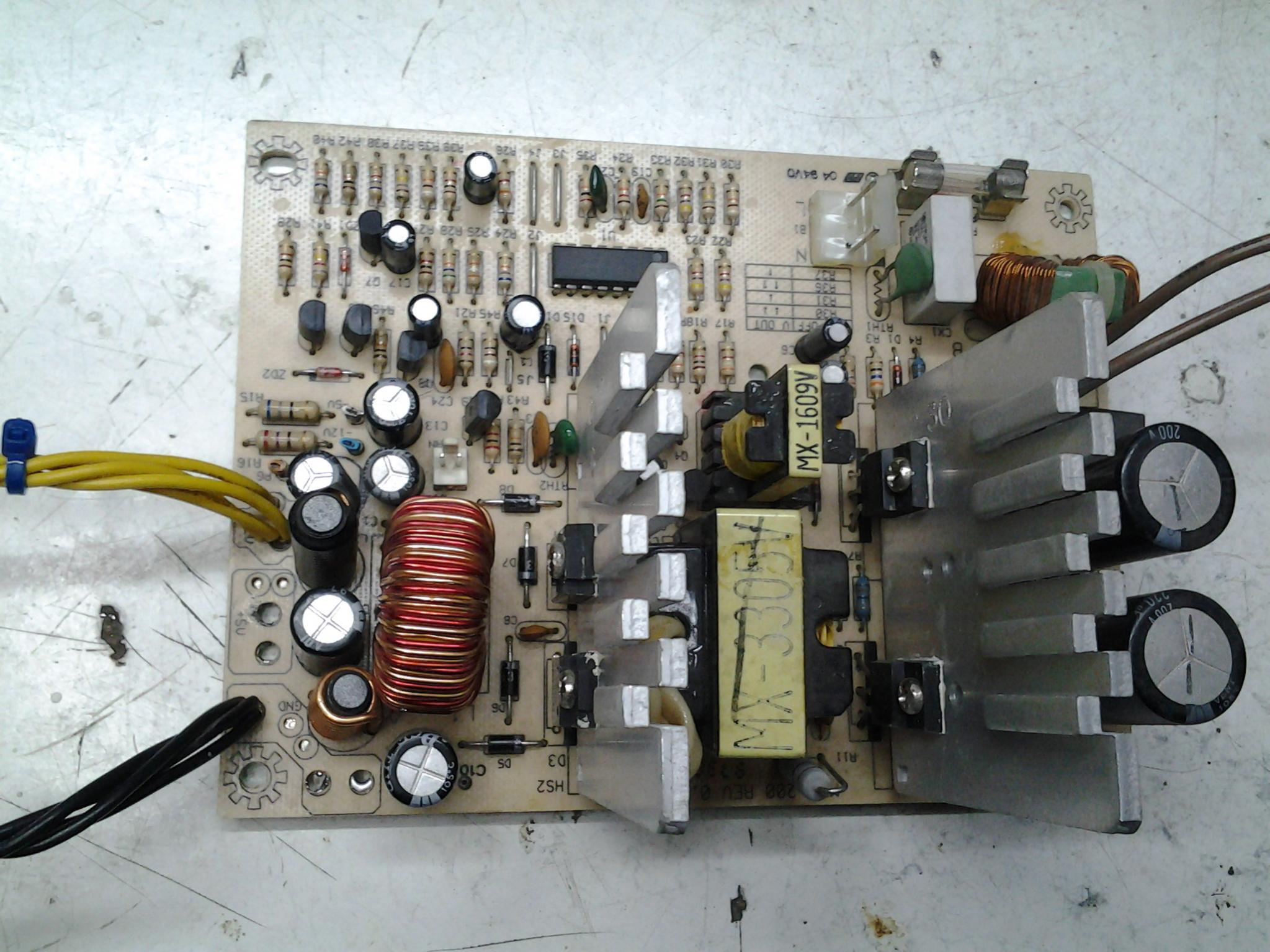

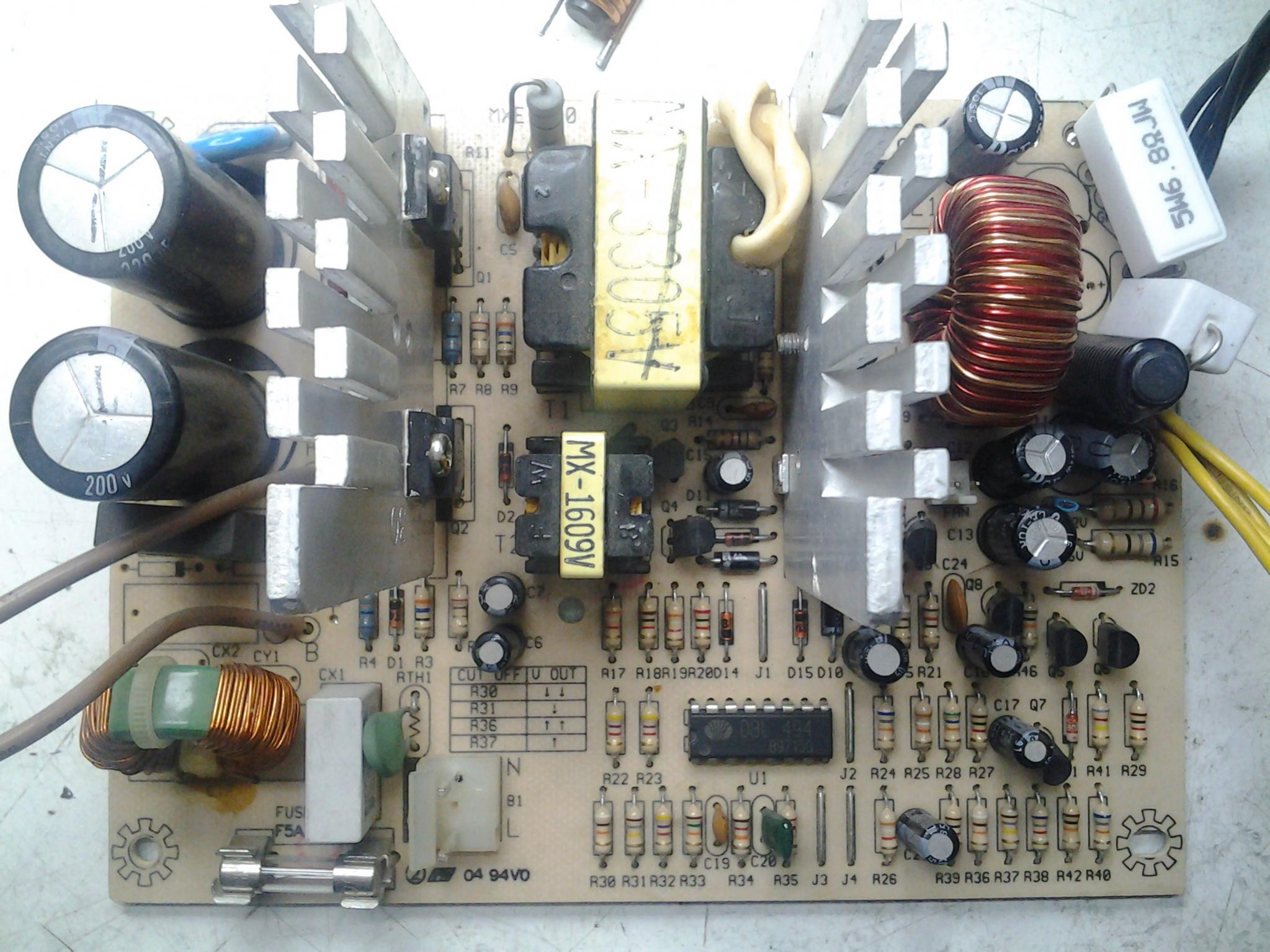

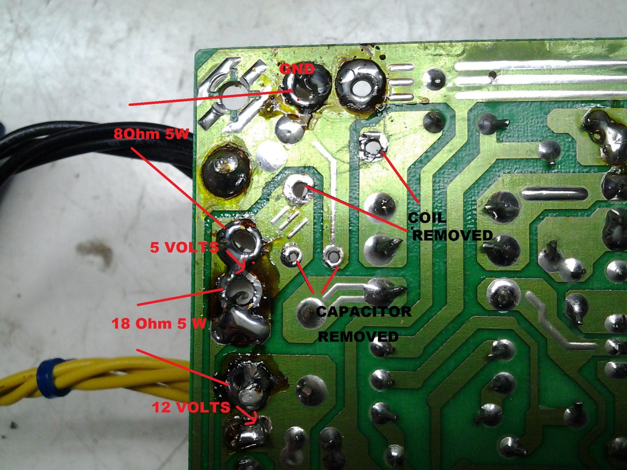

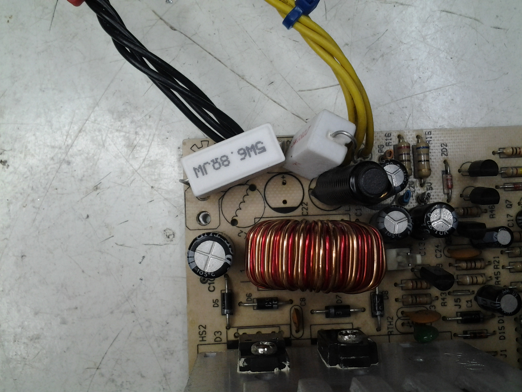

I have Started modding an old pc power supply to use it with car amplifiers and for cb, ham radio usage.
Modding it for 13,8 Volts output and need some help from someone more experienced about this mod.
I used two resistors for voltage divider between the 5v and 12v rails and managed to get 13,8v at output.I remouved the coil and capacitor between the 5v rail output but a sound comes from the transformer if i am not wrong and one resistor is getting little hot.
Did not test it with any load yet :flame:
Resistors i used was 18 Ohm 5w and 8 Ohm 5w.
Could anybody suggest any idea what else can i do or what causes the sound ?

post1 pic1 shows the mains isolation transformer. It's the big rectangular one between the two heatsinks.
That transformer and all to it's right runs direct off the mains !!!!!!!!!
While you are experimenting I strongly suggest you use a separate mains isolating transformer and to keep one hand permanently in your pocket while this thing is powered up.

You are modding a different power supply, do you have a circuit diagram?
It looks like the idea is to change the voltage fed back to the controller to fool the supply into thinking the voltage is to low thus boosting it a bit to get the 13.8V.
Personally I would get a circuit diagram as a minimum and the data sheet for the controller, then at least you can work out what you are doing.
Though I also think it is not the safest or well thought out mod I have seen.

Will it help if i take a couple of pics of both sides pcb ?
What is the controller number, best of start looking for the data sheet for that, there are usually some sort of circuit diagram, if not you can reverse engineer the circuit board to create the circuit for the area of interest.
Hi there,
If you want to modify this power supply to a variable supply and your on board PWM controller is either TL494 or KA7500 i suggest you read all the info in the links below and all you're gonna need is two resistors and a potentiometer and no power resistors. Read em carefully and if you wanna ask anything i will be happy to answer. 🙂
The controller is: DBL 494
datasheet:
DBL494 pdf, DBL494 description, DBL494 datasheets, DBL494 view ::: ALLDATASHEET :::

I don't understand why you are putting the load resistors on the output?
The resistors you need to change,are the feedback resistors from the 12V rail to the controller chip.
From the link friend posted earlier i understand that it is more effective to change some resistors from the controller like you say
I used this resistor for voltage divider. At the link below this guy did it .
Converting Computer Power Supplies to stabilized 13.8 V DC 20 A

I will do the mod from second link fraind posted
From controllers pin1 will be cut from pcb and i will add this circuit : http://boginjr.com/wp-content/uploads/regulpsu.png
The author says :
double-check that the TL494 chip is getting its supply voltage from a “helper” supply. Basically, you should see at least 3 ferrite transformers on the circuit board and a heatsinked linear stabilizer (78xx) powering the chip
I could not find anything from (78xx) powering the chip. Is it ok to add this circuit ?
Maybe from the pic i attached yuo can spot anything ?
