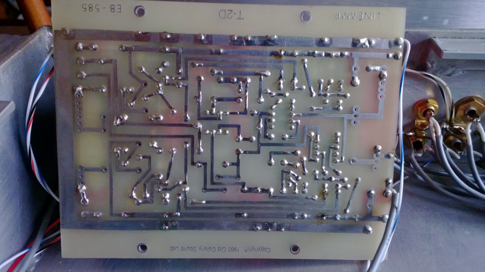

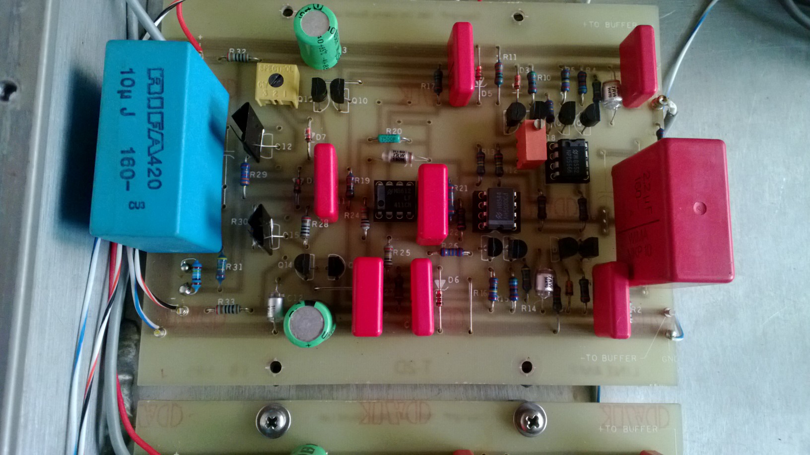

I have this old line preamp that was built back in the late 80's by someone as a DIY kit. The boards inside are labelled "T-2D Line Amp" by Old Colony Sound Lab. I've searched around the web and on this site, but I haven't found any info about it. I did learn that Old Colony Sound Lab was associated with AudioXpress magazine, and it appears both are now defunct, but haven't found any info about this specific product.
What I am interested in most is just any general info about it: who designed it, what topology is used, any published specs/schematics, etc... The schematic I could just trace out myself if need be, but if there were one available, it would certainly save me some time.
As it stands now, it still works fine, though I have noticed that it seems to have gotten slightly hissy. I think it is due for having its power supply caps replaced, so that may solve that. I'd be interested to see how much current it draws, as well. The chassis has alot of empty space in it, and I'd like to stick a phono pre in there... would be good if they could share the same supply without problem. It runs on +/-24V.
Attached are a couple pics of it. The opamp in the center of the board is an LF411. The other two 8 pin DIP packages are fancy JFETs...

Yes you have an Erno Borbely preamp.
I bought a full Borbely designed EB-585 preamp that has the RIAA preamp, super buffer and line amp with power supply a few years ago at a yard sale for $10.00. Works fine, except one channel of the RIAA preamp is noisy. The best phono preamp I have-very open sounding, but there are better ones today if you want to spend the money. Your card looks to be slightly newer than mine. The 411 I believe is the DC servo. Your noise may be from a noisy input FET.

I looked up that article and it seems to show the basic topology, but I'm not sure what differences there are between the line amp and the RIAA amp. The article only mentions the RIAA one...
If something is bad with the JFETs, I guess I'll just have to live with it, since I doubt I'll ever find any replacements these days.
I don't have the RIAA stage. It's only the line amp. I have the power supply that I assume was designed for it as well. They were built in two separate chassis and the whole thing is dual mono. Two power supplies, two transformers, etc...
