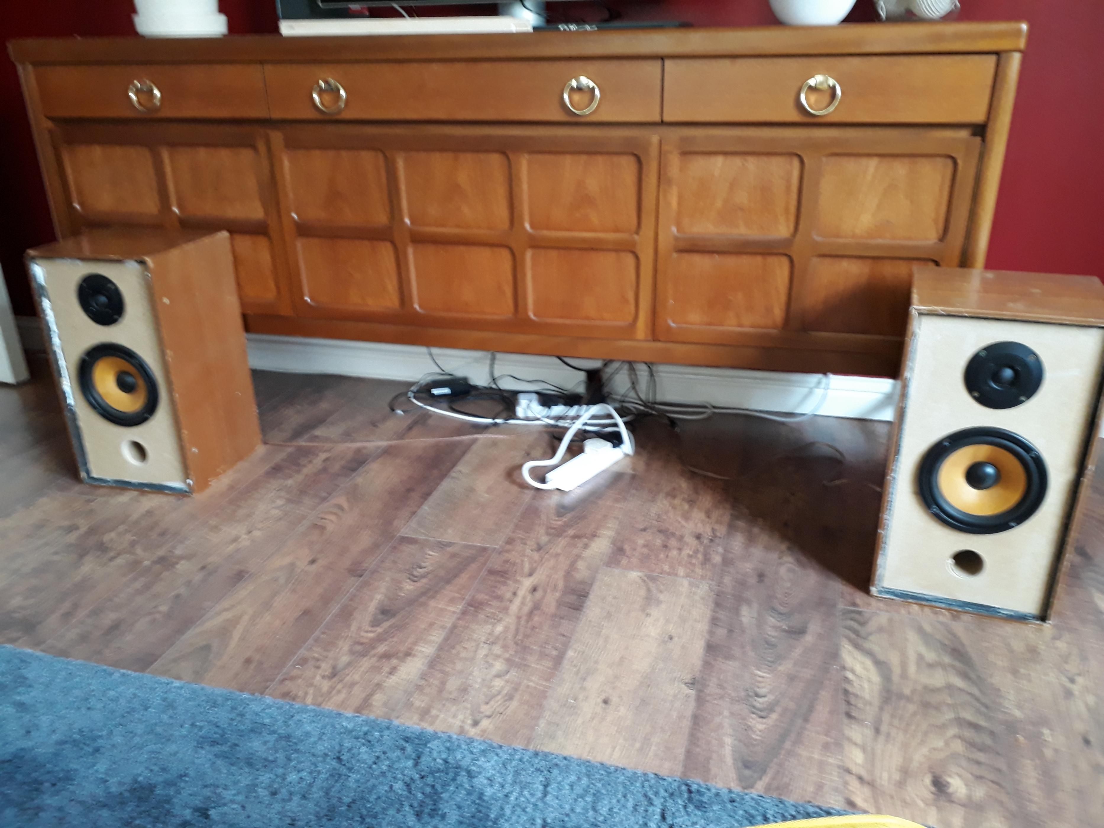

Hi Lojzek
I've just about finished this project - Many thanks for your help. Have a look at the attached pics - the crossover was fun to make. The speakers sound great, I ended up putting in a 6.8 ohm resistor which seams to work well in my room. The last thing I'm going to do is put in a flared plastic port ID 2 inches. I read elsewhere that a rule of thumb is to add half the flare length on so if the flare is one inch long the total length should be 3 and a half inch (if the length was supposed to be 3 inch).
But many thanks again. You've helped me out greatly 🙂
