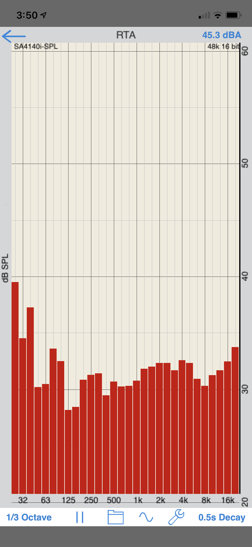

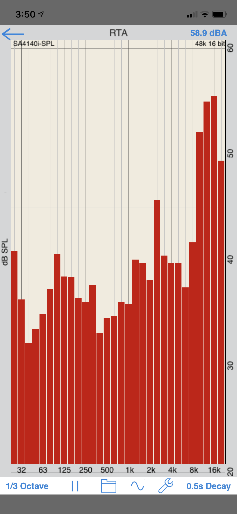

I strongly believe the DSR1 may be adding noise into the system. I have an AudioControl SA-4140i RTA which I've posted images for here showing both with the amps powered up and then off. Images were captured through my cell phone, using a calibrated AudioControl microphone - held about 3" from the door speakers with no music source.
The noise happens no matter if the engine is running or not - still noise exists.

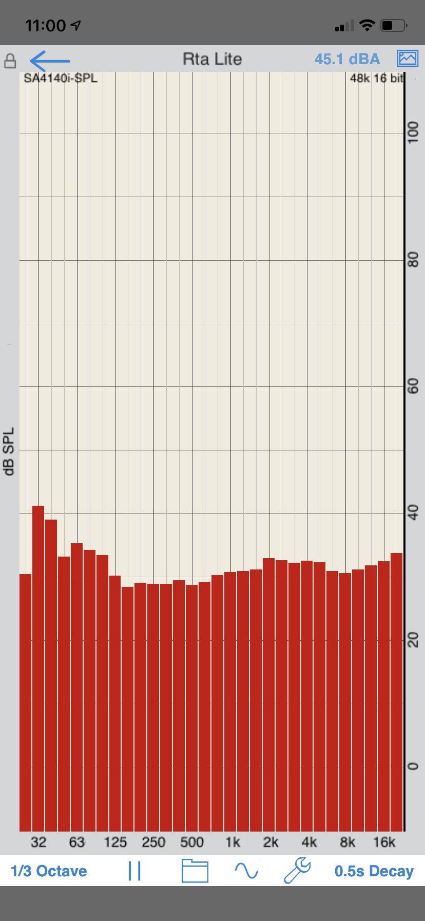

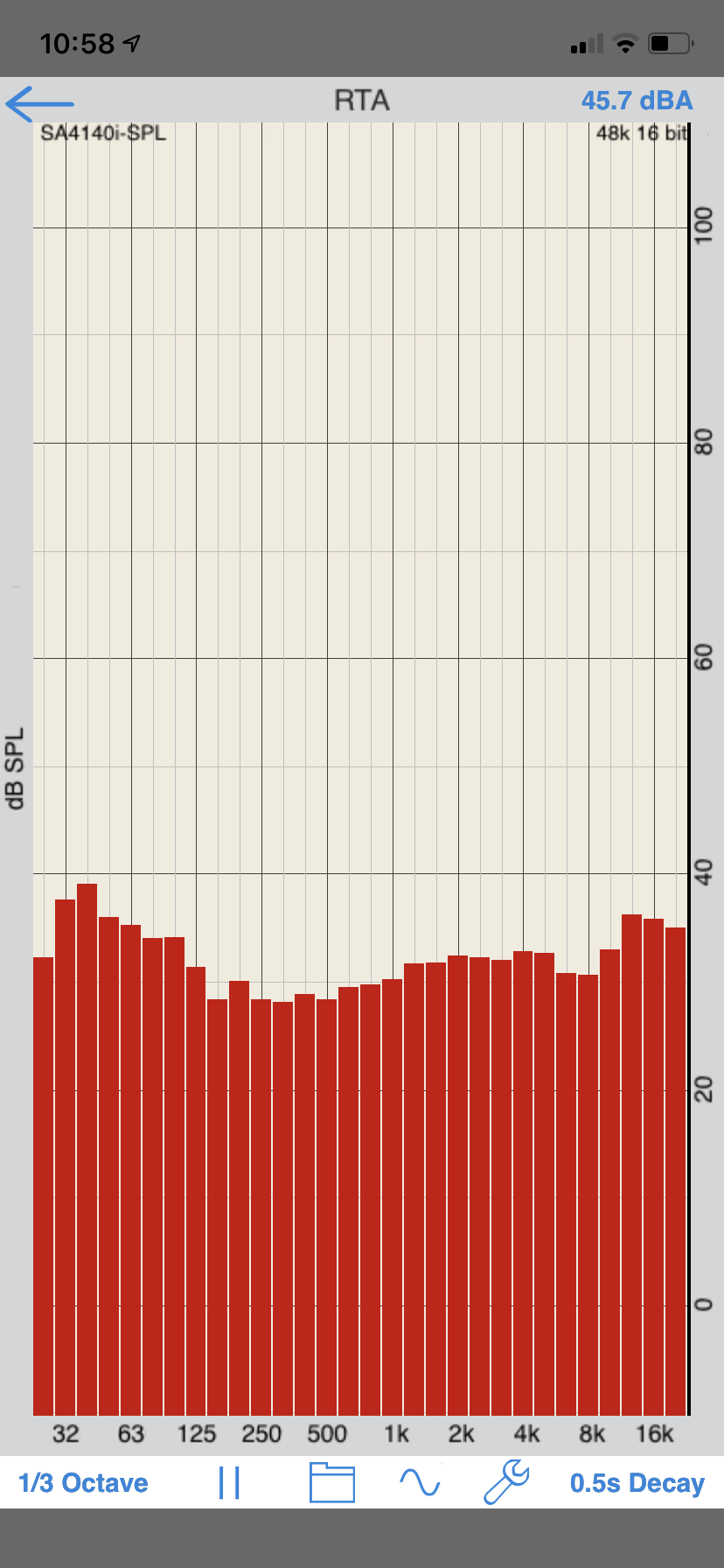

4CHB-6 module seems to be much better. Check out the RTA between on vs off. Same speaker as before. I’m going to stick with this input module for awhile.
Images:
LEFT | RIGHT
ON | OFF
Maybe I should fix the 4xch-4 sometime?
