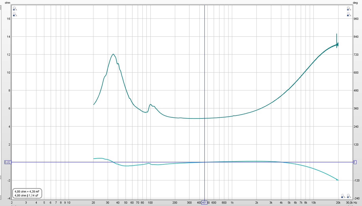

Hi im not really into impdance measurements (reading them) i tested a coil in a magnet motor. and i wondered if maybe there is a clue in why it has a huge drop at around 13-14 Khz, so far i dont see anything weird in the measurements. any one a clue ?

Believe it or not the the bigger you go with the cylinders, ex Janus 50, 70 the more you accentuate the high frecvency response and flatten the rest.. A bigger influence factor is the contact between the coil and the membranes. The more weight you add to the cylinders you lose efficency.
To lose more of your impedance peaks, you have to make an overhung coil structure.. If it is underhung, and the magnetic gap isnt large enought and the mebranes arent stiff enought to keep the coil in the gap, the coil goes out of the gap, gets hot and the impedance goes higher at that time...
The solution is a clever overhung design with a bigger gauge or continue in undergung design by using a smaller diameter wire and tighten the elastics that centeres the coil in the gap so that the coil remains in the gap all the time.

I would test a resistor for a baseline evaluation of your measurement setup.
Dave.
i did that with the resistor used to calibrate the setup 🙂, but nevermind an ADmin may close this thread. sorry for making a mess 🙂
