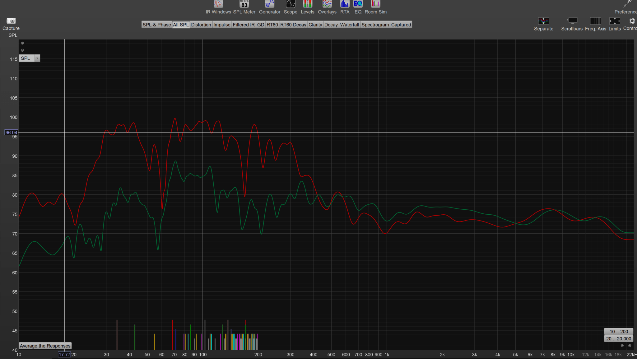

Here are some measurements. The Summit's crossover is at 270Hz. Red is the "good" speaker with both woofers working. Green is the "bad" speaker with only the bottom-firing woofer working. As you can see it is a lot flatter. The ultimate issue is that my rebuilt panels are putting out a lot less volume than they should which is causing the imbalance, but I'm not willing to fork out $3K to replace them at this time (this system is in my bedroom which I very rarely use).

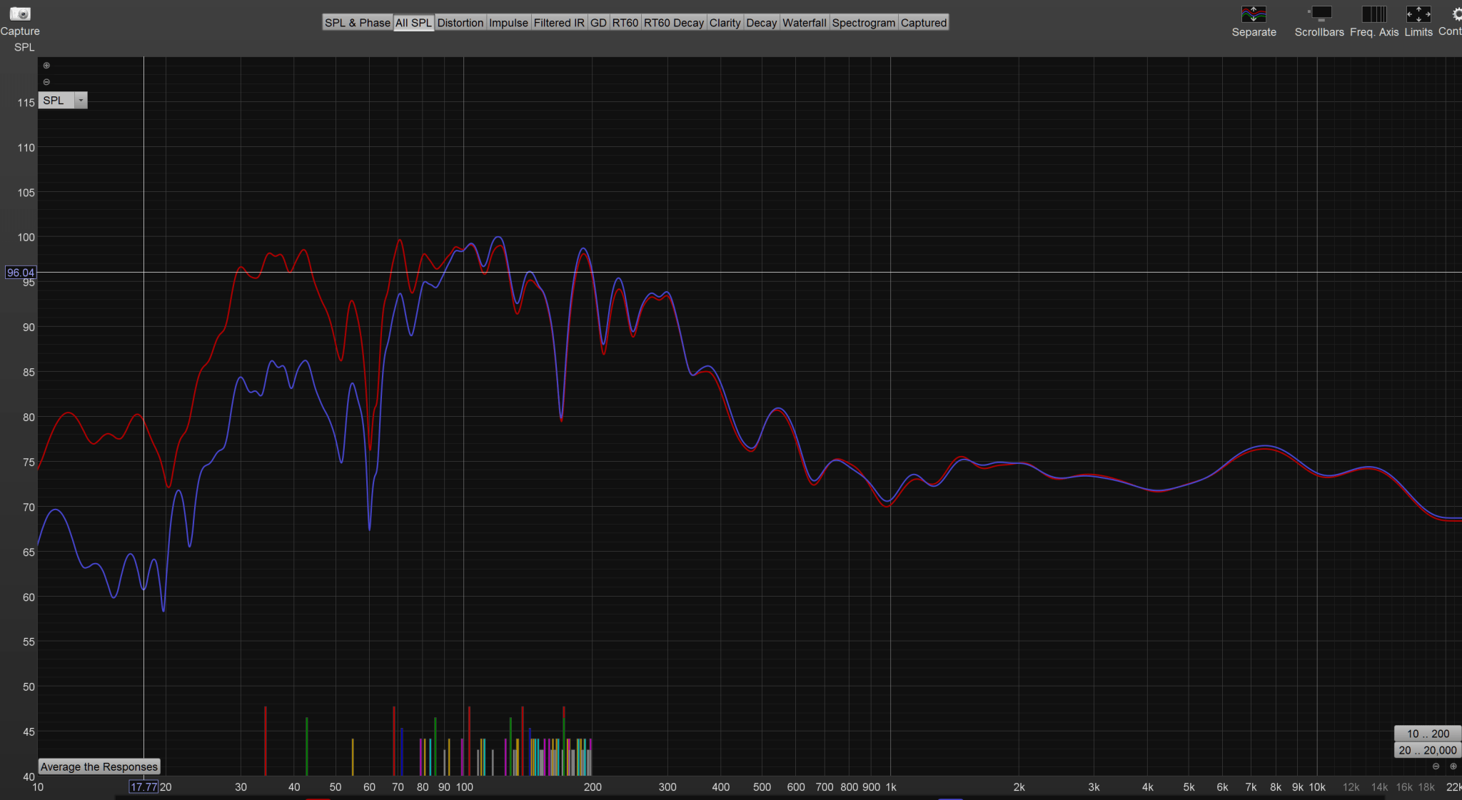

The 2 pots at the back allow you to adjust 25Hz and 50Hz. The blue line below is with both pots at their minimum, -10dB. As you can see it doesn't help much as 80Hz to 300+Hz is still too high.
The "bad" speaker (green line) seems reasonably flat so I'm wondering if I should just disable the front woofer on the "good" speaker also. Just want to make sure it's not going to cause any damage to the amp or internals if I simply unplug it.
