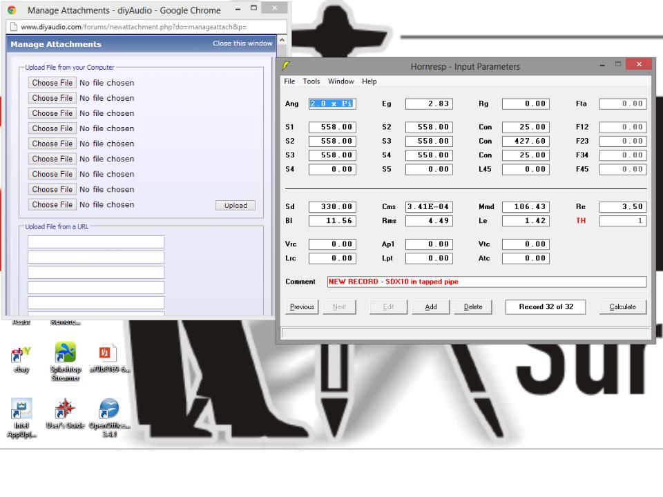

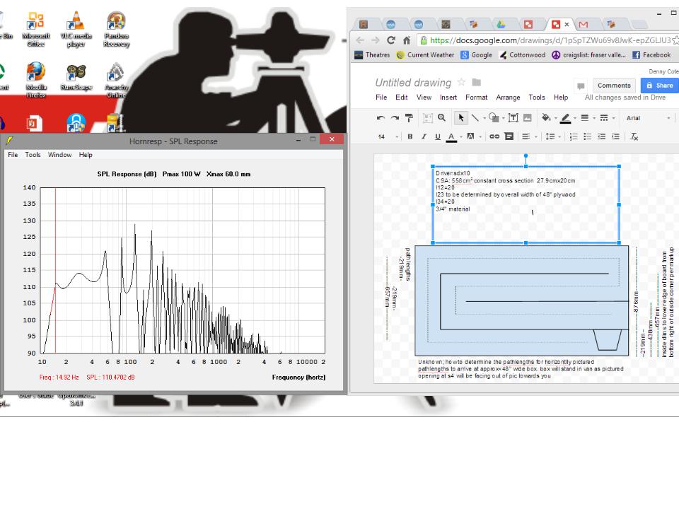

I just checked. 168 liters with a 20 hz tuning requires 117 cm (46 inch) port length if you keep the port area at 48 square inches. And if you do that you get a 7 db spike at 20 hz and the first harmonic spike is at about 140 hz, and it's pretty bad. Not a good design at all, especially for automotive use.
I'm really confused about what you are trying to accomplish here.
