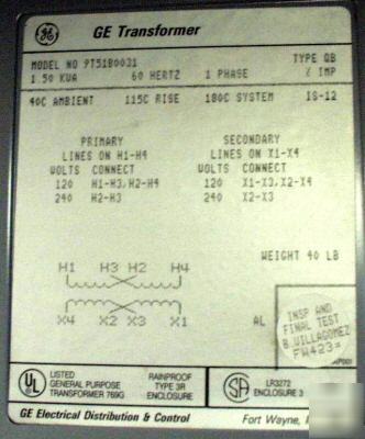

Ok, I've 9 of these to use as balanced power trafos, design the rest of a good ...
...conditioner and I'll give the best, most complete suggestions free tubes, 120v to 24 volt trafos, or motor run caps. I'm good on the wiring, that is tie X2 and X3 together and to ground and H1 and H4 together but to nothing else. My max draw at wide open is 7 amps, but every item will get it's own trafo. I check out my OneAC isolation trafos that I tried out to see if they would help w/ my noisy house and they have caps, movs, and ferrite loops, etc. With a clean sheet of paper and plenty of motor run caps to choose from (from 2uF to 80uF), what would you do?
