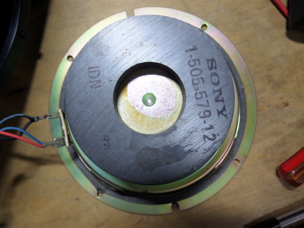

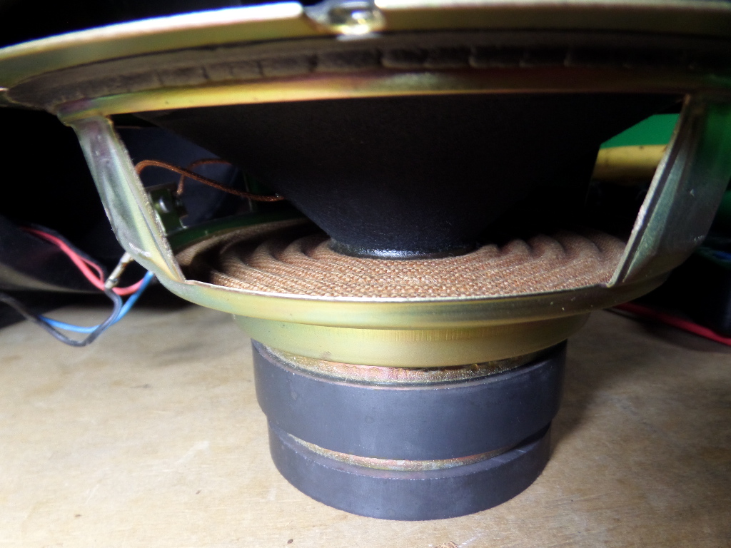

speaker diameter(up to outer metal frame) is 6 3/4", 3 3/8" height. it has double magnet with diameter at 3". voice coil is probably 1-1 2/8". probably good for like 30 watts continous, right?
30, maybe 40 watts. The 6 1/2 " may be more robust than the poor little 4" Aiwa's, but then you'll probabaly just fry the tweeter. Unless you turn it down, of course.

there are 4 tweeters on this speaker setup. the main middle 5cm directly connected to woofer using 4.7uf(forgot actual value) is both busted on left and right due to insect/bug eating the cone.
the 3 othe tweeters are connected in series, like this: left cone tweeter(8 ohms) -> piezo tweeter with 1uf parallel caps -> right cone tweeter(8 ohms). no label as to what wattages they are though even on the internet.

those 3" magnets might have room for a 1" voice coil, but more likely to be around 3/4" V.C.
10W to 20W of continuous power if tested to professional standards.

You could easily use a 50W chipamp with domestic speakers using a 3/4" V.C.
