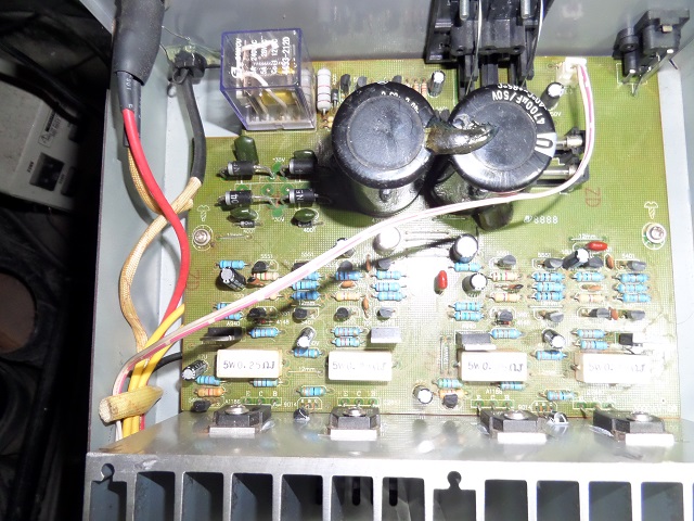

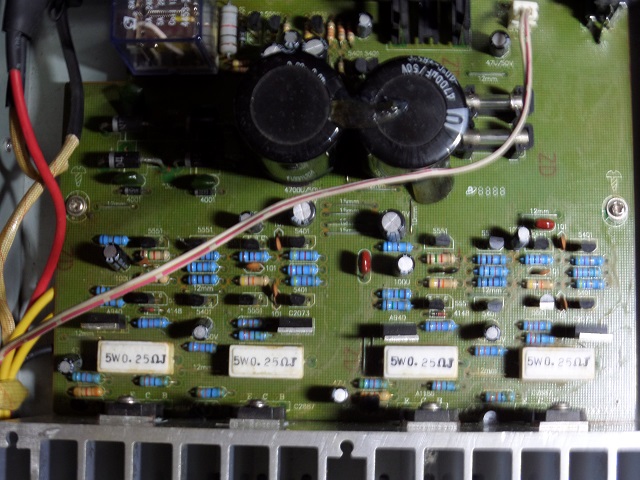

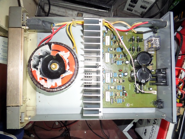

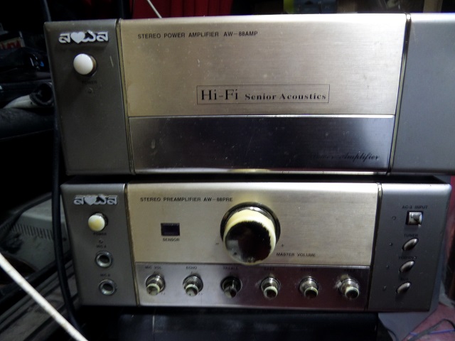

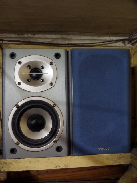

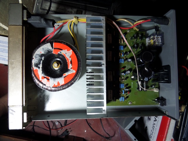

here are pics of the sound system + speakers...
no other identifying labels can be found like real model numbers, or power rating of amp etc. no labels also on tweeters and woofer, only a sticker at back that says 60watts, 4 ohms. anyways im not gonna use this anyways and instead use the Sony speakers. i found some service manuals and read that these L90VH are paired with system with about 100-120watts. i just want to have a possible idea or estimate on amplifier power so i wont blow these again and since i dont have oscilloscope nor a dummy load resistor.

A two channel amplifier powered from an 150w transformer is a small amplifier.
If you push hard this amplifier will clip continuously. This clipping is catastrofic for loudspeakers

anyways, i opened up the Sony SSL90VH speakers and did some measurements and screenshots.
speaker diameter(up to outer metal frame) is 6 3/4", 3 3/8" height. it has double magnet with diameter at 3". voice coil is probably 1-1 2/8". probably good for like 30 watts continous, right?
