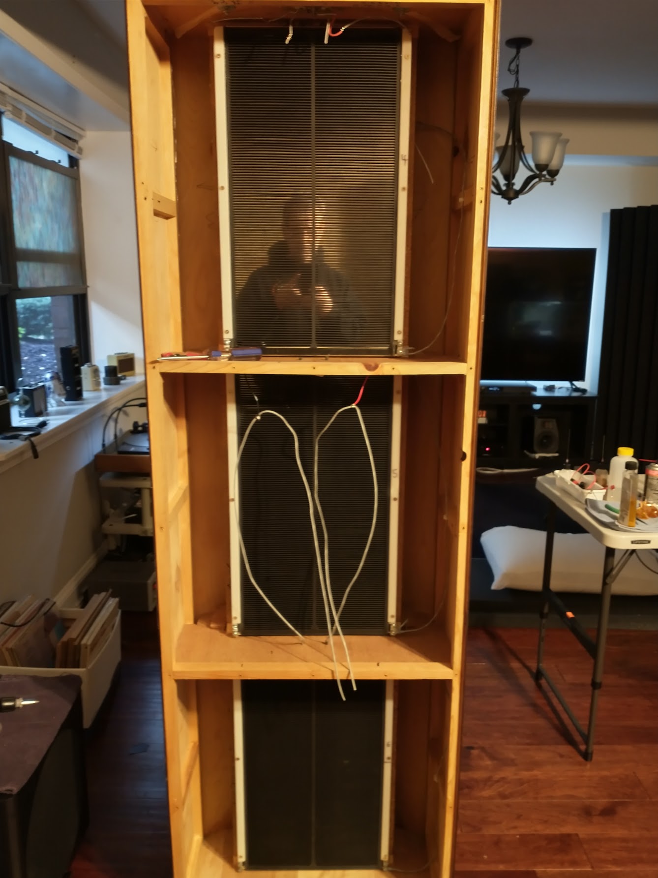

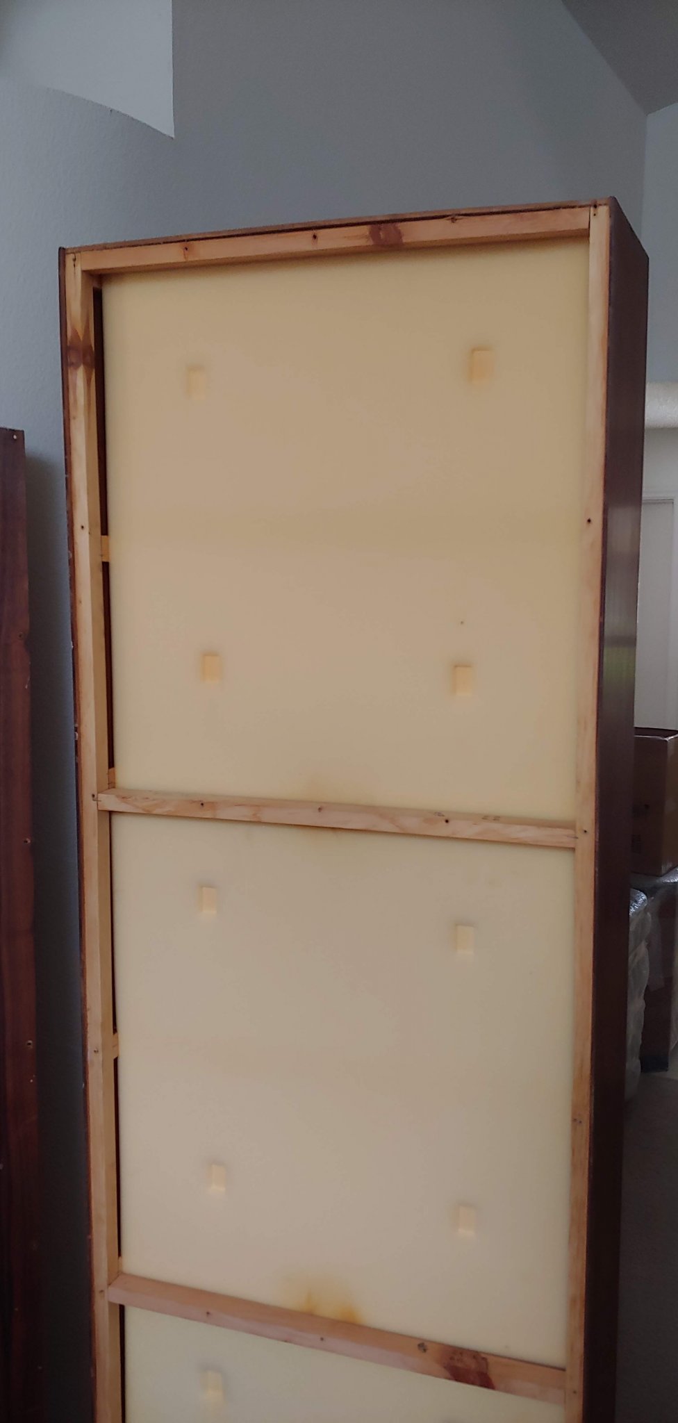

OK here's what I did. Side pockets came out great and I feel 'problem solved'. Rear panel got a lot better but perhaps needs to be quieter still. Someday.
...And just to show how everybody, even me, happily skips right over the basics sometimes I will now report that a lot of my rear panel troubles were caused by half the damn screw holes being stripped! That's been fixed.
Did you ever try leaving the back panel off with just the foam as a loading
resistance or laying carpet padding over the foam and listen ? That would solve any resonance straight away..,

No I never thought of leaving the back off entirely.
This cabinet is not run fullrange, I imagine there must be a frequency above which the cabinet works about the same with the back on or off. (assuming all that foam stays in place)
Stiffening the cabinet has changed the perceived sound. A little less warmth, a little less energy at the lower registers. Or so I've convinced myself...
cvanc.... why not put the ribs 90 deg angled so they ar reaching the stiff sides?
Making the back a lot less resonant?
It's a Beveridge, there are no stiff sides ":^)
The patent drawing planet10 posted a while back convinced me adding lightweight stiffeners parallel to the long axis was the good approach.

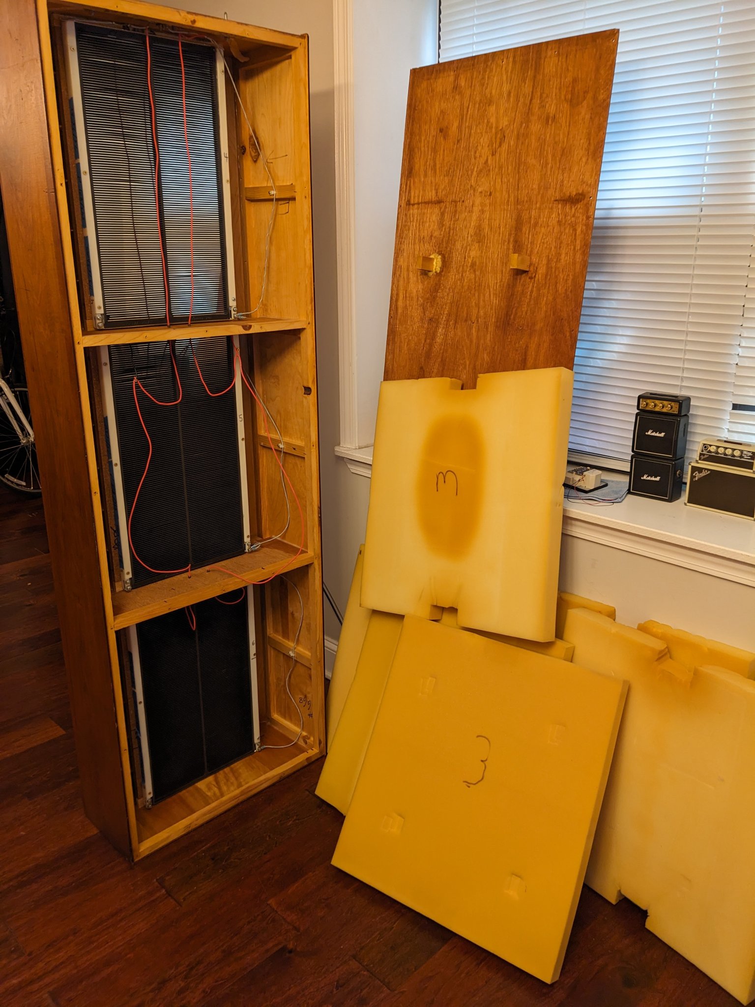

...And darn it AVWerk now I'm thinking about deleting the rear panel entirely, just run open and let the foam do all the work. I usually cross these over at 100Hz with the steepest slope I can generate. The lowest I've ever used is 50Hz, but as huge as these coffins are they do not make much by then and are well into their rolloff. I wonder at what frequency the rear panel ceases to matter.

Since their designed to face each other , attaching to each side wall with carpet padding just behind your foam
should work wonders

My back panels got a visit from a screw gun and a bunch of fender washers - unless something fails I'm not revisiting. I feel good about the progress made and am convinced the sound tightened up down low, just as one might think it would.
