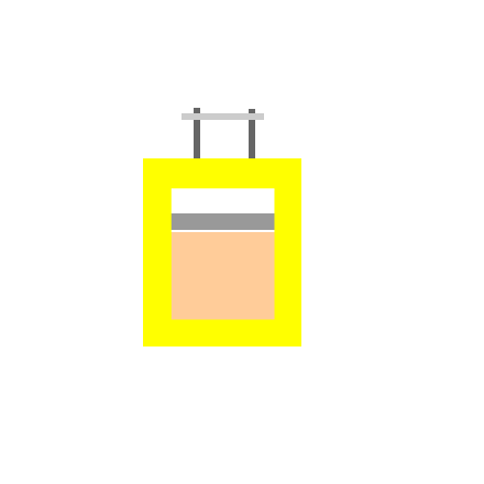

Negative Design said:
...the NEC wont fit on it thanks to the positioning of the OHPs arm , if i place it anyways i lose more than 40% of the screen not counting left and right edges..
I say "To heck with the mast on the OHP. I took mine off. Partially because it was in the way of my panel, mostly because it was really crappy at focusing my projection.
I built my own "mast" that I think gives me a lot more options, is totally out of the way of the panel and connections, allows me a lot of focus options, and even helps to kill off a lot more light leak than I expected it to.
Attached is a very crude SIDE drawing of what I did. The yellow square is a 2x4 frame that I built. The brown thing behind it is my OHP body, and the gray thing is the panel.
On the top, you'll see two bolts that go through a piece of scrap sheetrock. That's what the lens sits on. There's a 2x4 frame on either side of the OHP, and by building it in a square frame like that, I gave myself extra stability, and made it easy to get access to all the connections on the sides of the panel
I have taken pictures of all this with my craptastic digital camera, but I can't find the software for it, and the driver I found online just almost works, except for that pesky "can't find the camera" error.
