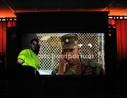

OK sorry to hear about the fresnell that stinks, But On to another more important topic, go to that site thats linked above...............damn those are some good looking screen shots man if a tv and fresnell looks that good Im gonna ditch the whole LCD projector Idea all togeather LMAO. Seriously tho look at the pics its like looking at a actual crt tv directly and as for the pic where the guy is standing in front of the screen look at the shadows, they go down so the video source was higher then he was( ie cealing) man it must have been hard work to mount the tv box up that high, or is it that with the amount ofmoney hes scamming off people he bought a lcd projector seriously this makes me mad such shisters in the world. I will attach the pic I was talking about, and Im gonna email him for more pics with people in the picture and a pic of his actual product hes using for the pics LOL we shall see Such a tird:mafioso:
I'm so skeptical about that.. I tried to search the web for reviews but couldn't find anything about this "Max theater" deal. I took the above screenshot as well as another from their webpage.. to see if the guy standing in front was just "photoshopped" in front or something. The video does distort on him.. which could be real or not.. but the weird thing that strikes me is..
That still frame of Denzel.. and the one with the guy in front of it, the screens don't match. If you look in the one without the guy in it.. there's a lot more to the screen than is shown.. which means that one of the pictures isnt real.
The frame without the dudel has an approximate ratio of 1.8:1.. while the one with him is 2:1 since the bottom part of the screen is cut off.
Now this is all just from quickly lookin at the pics for about 5 mins.. I might have overlooked something.. but really the only way to know is to try it..

Don't fall for the fresnel and tv deal. One guy who was selling plans and a fresnel stole pictures from a group members LCD projector web site and used it in his ads on ebay...
The problem is brightness, the CRT's just don't put out enough light.
