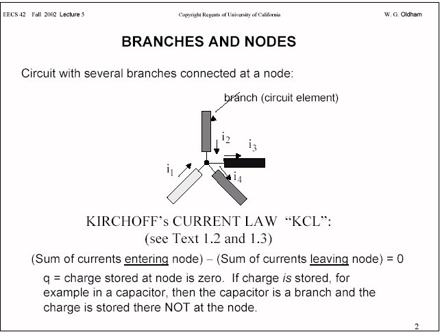

Corn-Picker said:V = IR is the secret to being an electrical engineer
Only for a purely resistive impedance, otherwise you have to include some cos(wt) terms to muddy the waters.
Here a link that explains it just like I learned it in school.
http://iml.umkc.edu/physics/wrobel/PHY250/lecture4.pdf
The sum of the forces = 0 is the trick for civil engineers
That works for electrical too, the sum of the currents into and out of a node is always = 0 (Kirchoff is never wrong).
