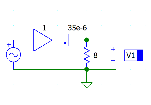

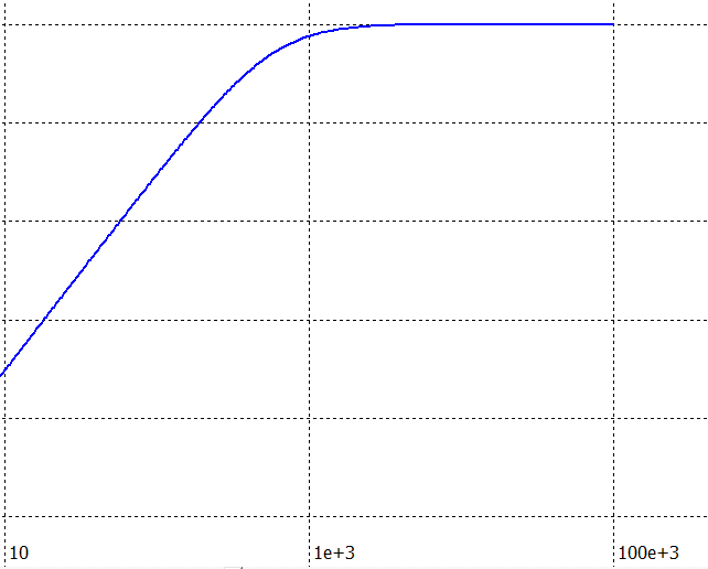

To simulate an open baffle using electronics software we may
use a R C highpass filter where C = 35 uF and R = baffle diameter
( in inches )
Example : 8 inch bare driver
