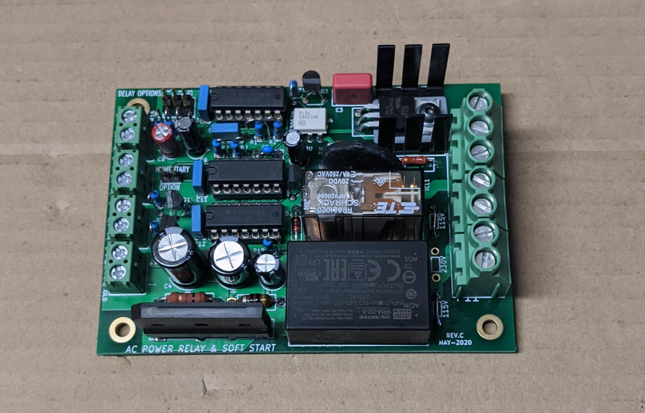

A little bit of progress. Built one of Mark Johnson's soft start boards to use in the SSE and started on the chassis. Obviously I am a slow builder.

Question. In the thread for the soft start/switch board I am using Mark Johnson the designer mentions that he recommends for most amplifiers an inrush limiter (ex CL-60) between audio ground and chassis ground as a "ground lifter." I have seen this on a number of class A and class A/B amps but in looking through the SSE builds don't see any mention. Would this provide some benefit on the SSE?

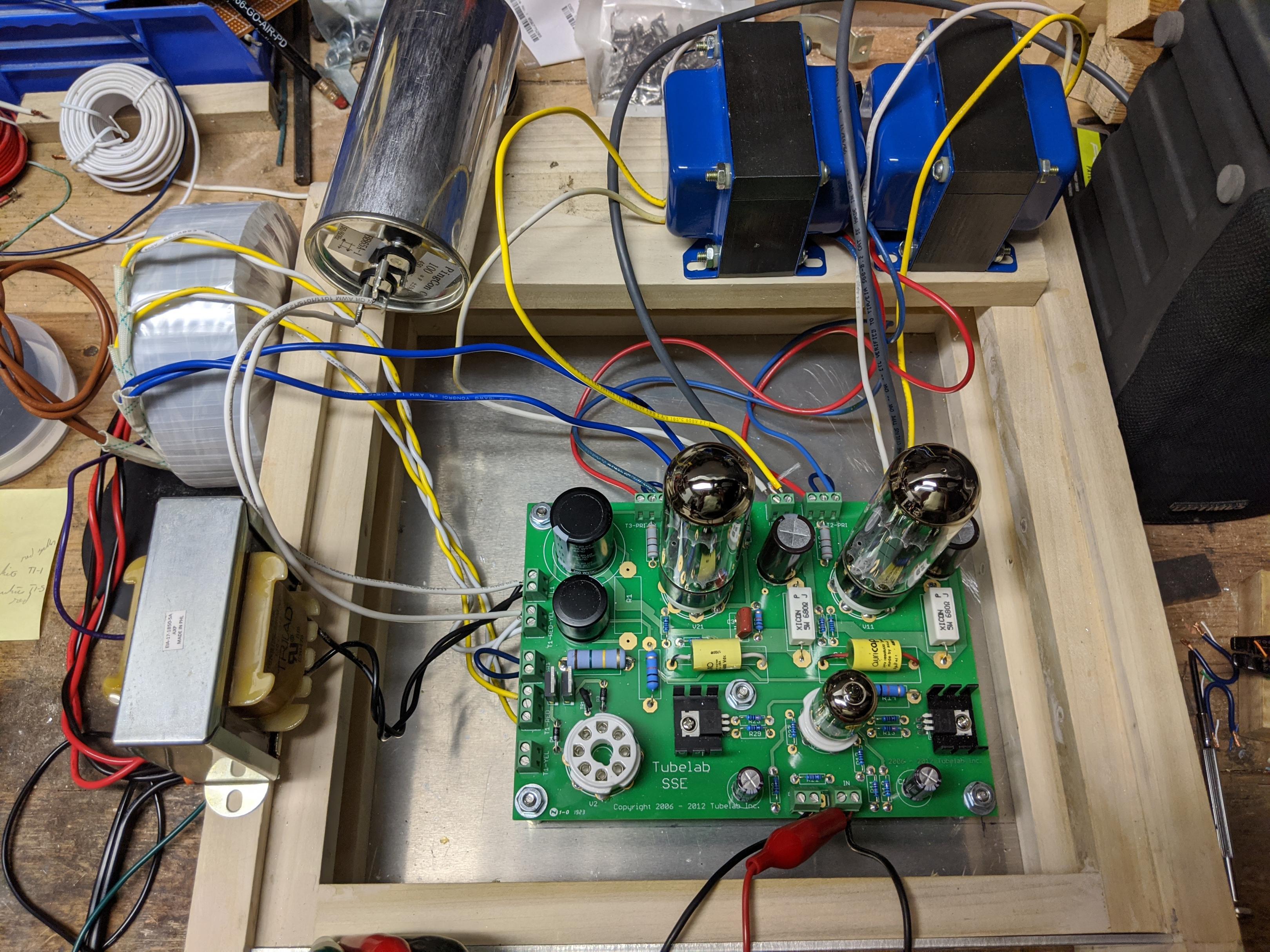

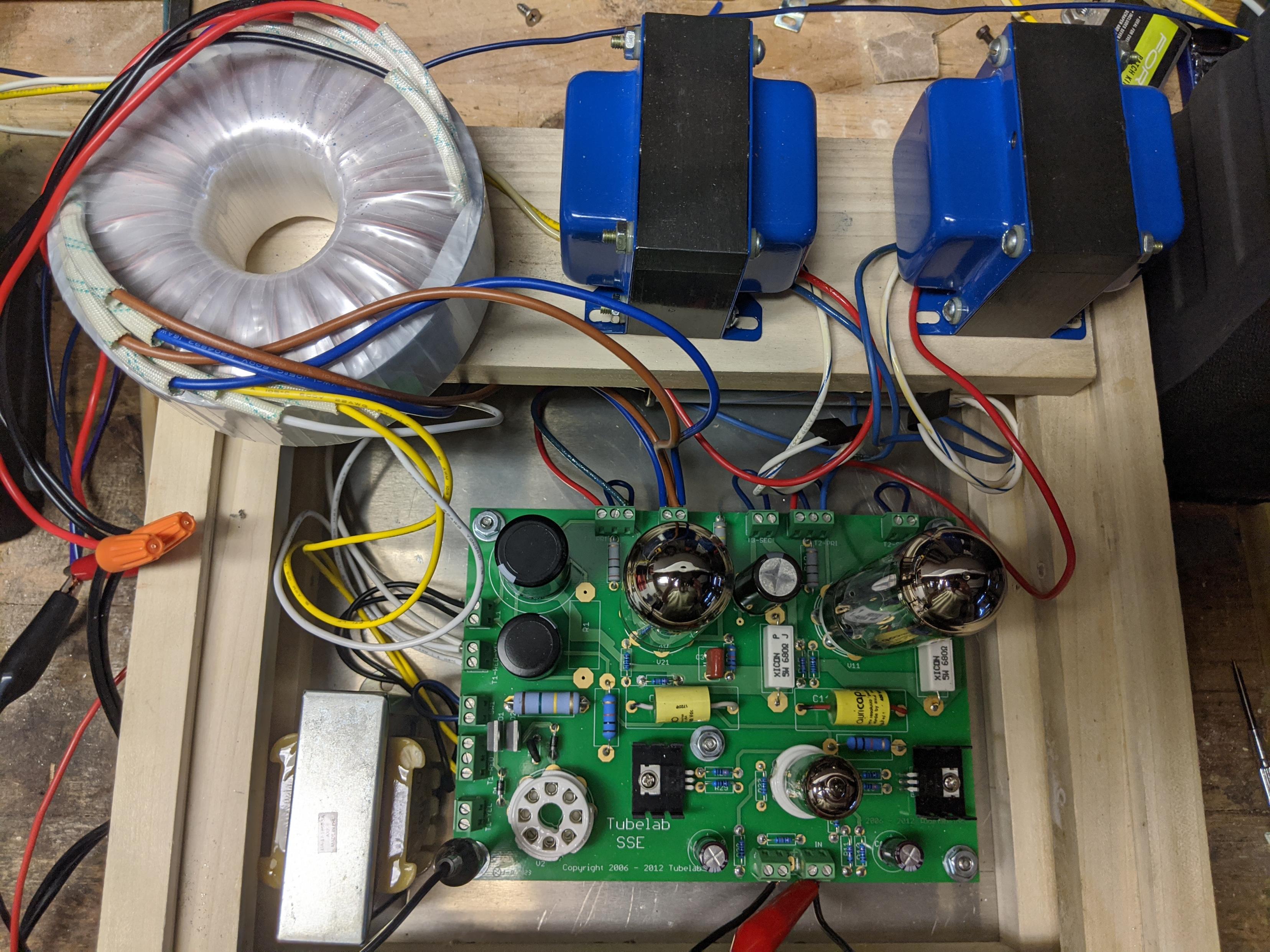

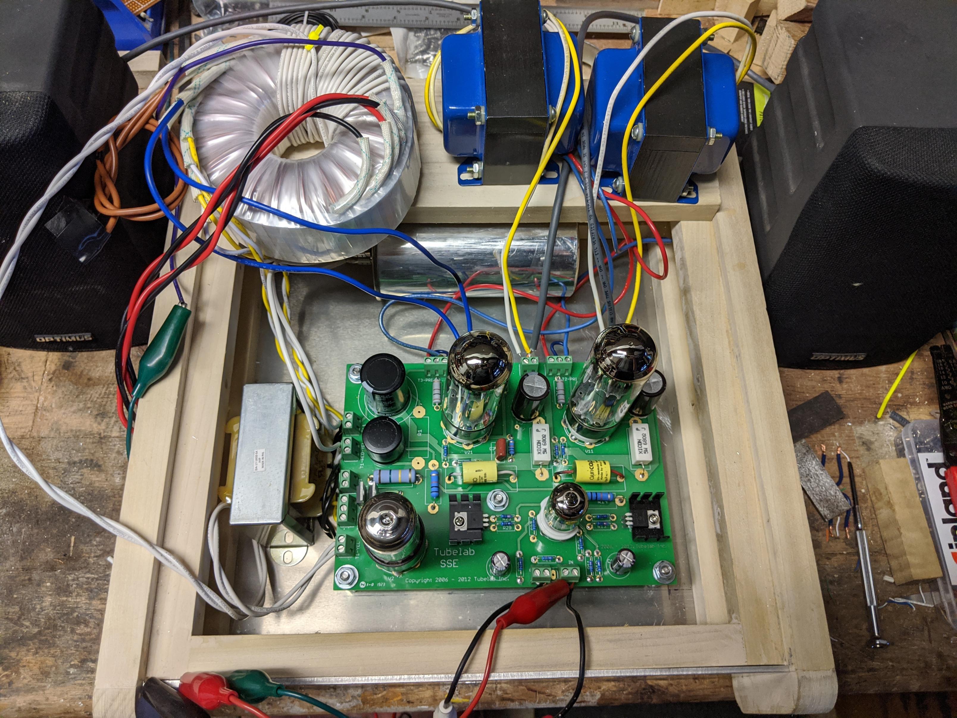

Got in some bench testing today. Good news is it makes music not smoke. Let it run for about 5 hours and it just played with no fuss. The one issue is it does hum through the speakers. Not loud enough to notice 10 feet away or when music is playing but audible when sitting a few feet from it with no music. Attached are the pics of the bench setup. Any ideas what I did to make it hum? Would like to figure out so I don't make the same mistake when I put it in the chassis proper.

A little more experimenting tonight and some findings. I redid the grounding and changed to cathode feedback really just to get rid of the extra grounding point, pic attached. I also moved the power transformer and speakers to opposite sides as well as twisting some of the wires. When connected with the source turned off I still here a slight buzz. However when the source is on no buzz through the speakers with my ear right up next to them. But I do hear a buzz from the toroidal. I have it sitting on some rubber pads but it still buzzes. So it seems now I have the SSE sunning silent it's just the power supply. I'll do a general search for buzzing toroidals but any tips would be appreciated.
I should also add I removed the auxiliary capacitor in an effort to eliminate extra variables.

Yet more experimentation and findings. First I found an old post by George (link) that talked about connecting the yellow and white wires of an Antek for the center tap and use the other white and yellow for the power input. That did not go well resulting in heat and crackling sounds. I will never revisit that again.
Next I focused on the 6.3v connections. On the Antek 2T350 there are 2 rated at 4A each. I had these connected in parallel in an effort to make sure I exceeded the 5A requirement listed for the SSE. When I disconnected these no transformer humming. I then tried hooking up just one pair, again no humming. I now had a hum free amp playing music. Pic attached is the hum free configuration.
Concerns and questions. First am I safe running the single 6.3v connection rated at 4A? I thought I read it was the KT88 that required 5A so if I stick with EL34s is 4A ok?
Question, if the single 6.3v 4A is safe could I modify the other 6.3V winding to supply the 5V rectifier? I originally planned to just use the solid state rectifier but have all parts on board for both.

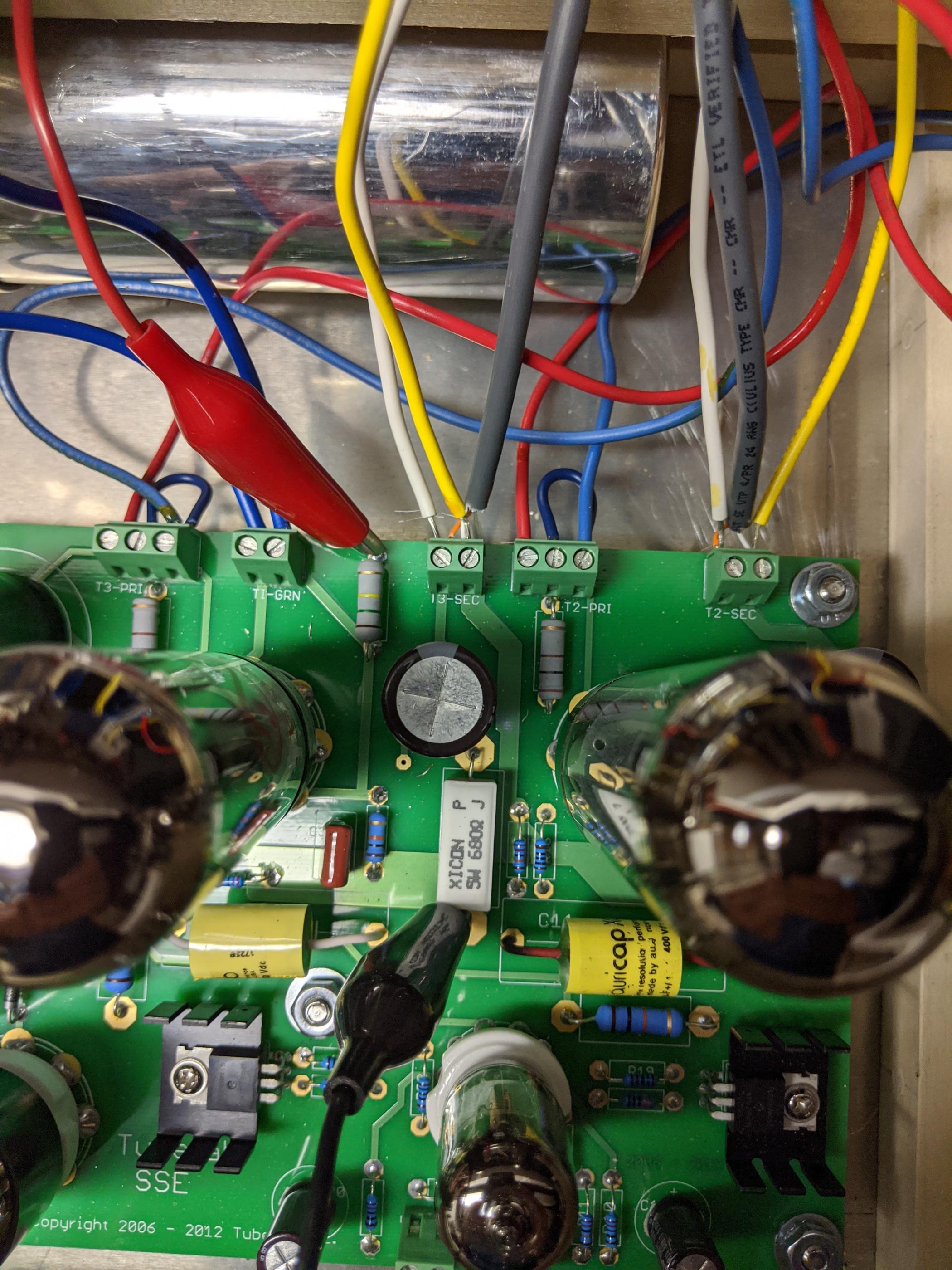

Well found a little more time tonight and attempted to measure B+ but since I am new to this not 100% confident in the points I measured. Please see attached photo, is this a valid way of measuring B+? I got 400v with the tube rectifier and 430v using solid state.
Assuming my measurements of B+ are accurate I am thinking I should swap out the 680 ohm cathode resistor for a 560ohm resistor for solid state rectifier use and then switch in a 3300ohm resister in parallel for a total of ~480ohm for use with the tube rectifier. From the EL34 spec sheet 25watts is the max dissipation and based on the tubes and applications chart on the Tubelabs website this should put me close. Sound reasonable?

Thanks mike567. Your post made me do some digging and I realized I made a basic mistake. The secondaries were wired parallel instead of in series for the center tap. Also going back to this post I understand my mistake. I knew what to do at some level but just did not put the pieces together. A basic error by me because I am new to all this.
The buzzing was much reduced after making this change but I still could hear a faint high pitched buzzing. I removed the 5V winding I added and it went away. Silent now.
Last piece to try in circuit before I disassemble and finish was a soft start board. I added that and it powered up but now the B+ voltage is 10V lower. I'll ask the question in the soft start thread and see if I have anything wrong.
