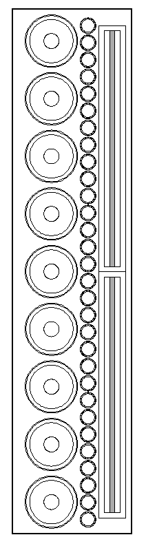

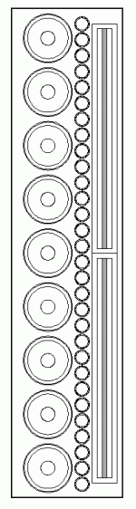

Hello,
I've a Newform 645. I'm using 6 Focal 5" Kevlar
midranges and 2 8" Scanspeak woofers in my line
array. The sound is very good.
I think it could be better. I've heard many tweeters
and in my opinion the New Forms are only surpassed
by the Ravens (Or maybe the Aurum Cantus which
I haven't heard).
I was at a show and was surprised by the bass the little
4.5" Excel woofer could put out. I would therefore
recommend an array of Raven R2 (Or Aurum Cantus G2)
paired with 4.5" Excel drivers. An active cross-over
24 DB/octave at about 2500Hz.
You can get this to play as low
as you want provided you add a little of bass boost.
On the other hand if you want to play it loud cut the
arrays at 60Hz and add a 15 or 18" sub. Or even 2 for
more bass. I think in that case the Adire woofers
come into play. How about a tumult? I think from the
specs the 12" Eminence Lab 12 looks good.
As far as chip amps: They are easy to put together
and can surpass the sound of amps many times
the price. They are not so cheap. If you use good
quality components they will cost probably $250
a piece. Well worth it. I haven't tried active cross
overs but I think with the Excels it probably the
best.
I'm building a set of regulated BPA200s. I've already
spend $1000 in parts and don't have a case yet.
The preliminary tests are extremely good though.
Harry

Re: Re: Re: Re: Re: Re: Oh to hack with it (aka: to h*** with space, I wan'ts me some new speakers!)
planet10 said:
The problem with 4 mid-woofs is getting a tweeter that goes low enuff... even 2 (ie MTM) puts the XO quite low. The XO point is pretty much determined by how close you can get the centres of the mid-woofers that are furthest apart.
With an MTM, is it necessary to consider the distance between the mid-woofers at the HF crossover, or just the distance from the mids to the tweeter?
If the mid-woofer to mid-woofer distance is to be considered, then most MTM designs would have a problem (i.e. combing).
Re: Re: Re: Re: Re: Re: Re: Oh to hack with it (aka: to h*** with space, I wan'ts me some new speake
midwoofer centre to midwoofer centre...
yes, many MTMs are that way for marketing reasons and break all sorts of guidlines...
dave
